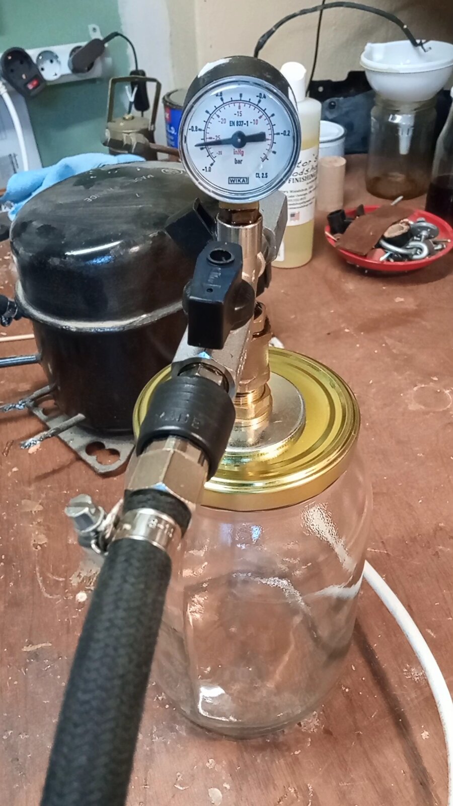

I plan to make my own stabilizing setup with a glass jar and a fridge motor that i will use as a vacuum pump. My initial tests show that it works (i.e. 25 in Hg pressure is achieved and the jar seems airtight enough) but havent tried it with wood yet. Since cactus juice is really expensive i would like to ask if anyone has tried something like this with success?
I plan to pre drill my blanks with a 7mm drill bit to enhance resin penetration. I plan to stabilise 2 or 3 blanks (3/4 inch x 3/4 inch) at a time; is this gonna work or i need a proper vacuum pump and chamber?
Cheers, Mike

no the jar looks ok. i am more worried about the pump; in my tests it can draw up to -26 inHg. Does anyone know if its enough? do i need 30?

I don't know what your elevation above sea level is but if you plug that into the formula in this link it will tell you how much vacuum you can theoretically get. The closer you can get the better penetration you will achieve.
Also be sure to dry your wood as close to 0% moisture content as you can get it and when you release the vacuum let your wood soak in the cactus juice for at least twice as long as it took for the bubbles to quit coming off the wood.

Thats great thank you. Yes i have been studying utube these days ( i know it doesnt sound reassuring). By the way this is a nice video if anyone is interested. Thank you once again.
