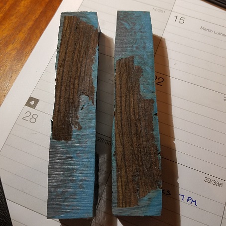

My first test is in the toaster oven right now, hardening the Cactus Juice. Once it is done, It will go in the mold, and I will cast the acrylic over it. I will post some pictures tomorrow when it is done.
So here it is, stabilized, and cast. I will attempt to turn it this weekend.
