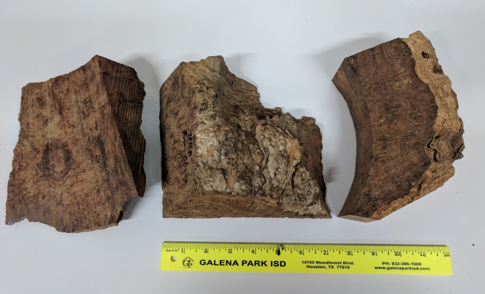

A while ago my dad told me that a friend of his had some exotic wood that he wanted to give me for making pens. I was a little worried, when I opened the bag and saw these three hefty chunks of what looks to be HRB I was blown away. My only previous experience with HRB is a personal pen that ended up cracking in a bark inclusion spot that I "stabilized" with thin CA. I am worried that the same thing will happen again and I want to make my parents friend a pen that will last. Anyway, long story short, I want to stabilize this rosewood. I know that it isn't really "necessary", I also know that Curtis says to avoid these types of wood with Cactus Juice. But I've heard that can be done. Does anybody have a "DIY" process that has worked? I know that I could send it off to a professional shop - but that's kind of against my religion :biggrin:. I tried to search around, but could only find posts that either said "don't do it" or "I've seen it done", but no explanation of the process. Any help or advice will be greatly appreciated.

I'd say yes, what can it hurt. Even if you don't get complete penetration if there are cracks/incursions it should help bind them.

I would also say to reach out to George at George's Bit of Timber (robutacion) as he has likely worked with and stabilized more wood than most.
Thanks mate, I have my share amount of woods I stabilised, some quite difficult such as the oily woods.
HRB is only, my best advice is to make sure the wood goes into an oven for 48 hours at about 80 Celsius, you need to "crystalise" the natural oils before stabilising, make sure you have the vacuum chamber ready for the wood as soon as it cools down to a warm touch, get it under the CJ before if soaks any moisture in the air.
Good luck
Cheers
George

Thanks for all of the responses guys. I think I might just have to give it a try and report back on my success or failure.
The extra long bake is a good idea that I will incorporate. Also I have considered soaking in DNA to try to eliminate some of the oils. I suspect that it might dull some of the rich colors, but not sure how much...

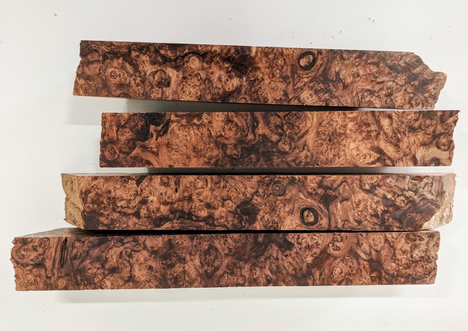

I cut into the middle chunk and now I'm pretty worried... This is the most beautiful stuff I've worked with, would hate to screw it up...

I would not stabilize it. It is already hard enough that it does not need stabilizing, IMO. The chance of ruining some expensive resin and wood is not worth the negligible benefit you will get with stabilizing a dense piece of wood.
