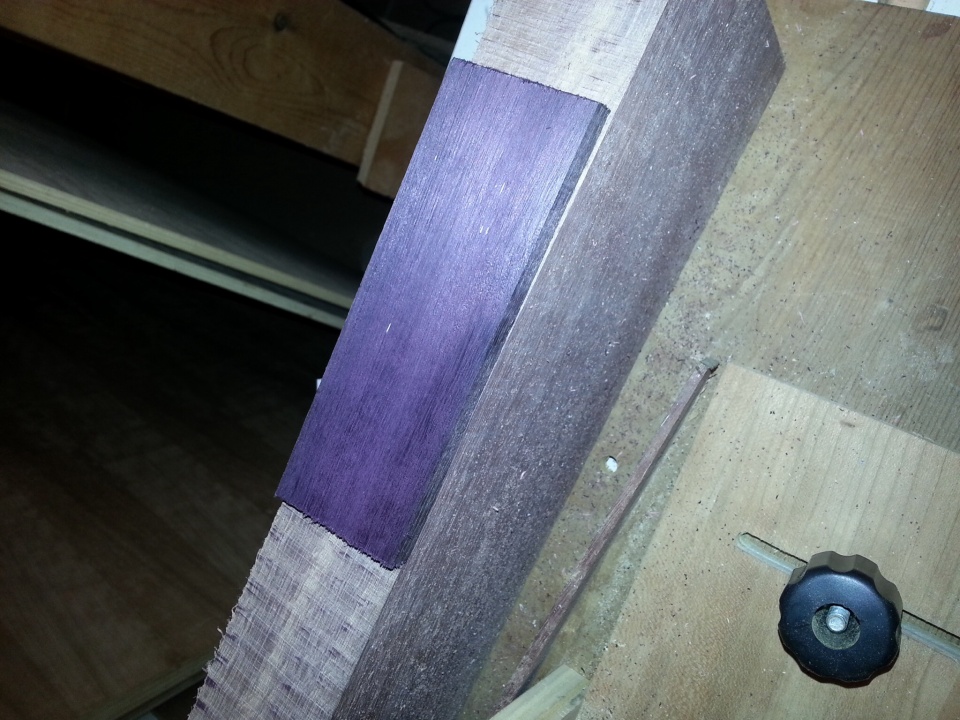

I cut a few slices and going by Curtis recollection the 200F bake wouldn't do the color change I took the wood to the kitchen toaster and baked it at 450F for 16 minutes. About the 12 minute mark the wood started to darken considerably. I now have it in the basement oven at 200F for an overnight bake to get the water gone. The picture shows the baked slice laying on the slab it was cut from to compare the color change. It will be interesting to see if the color changes any more overnight.

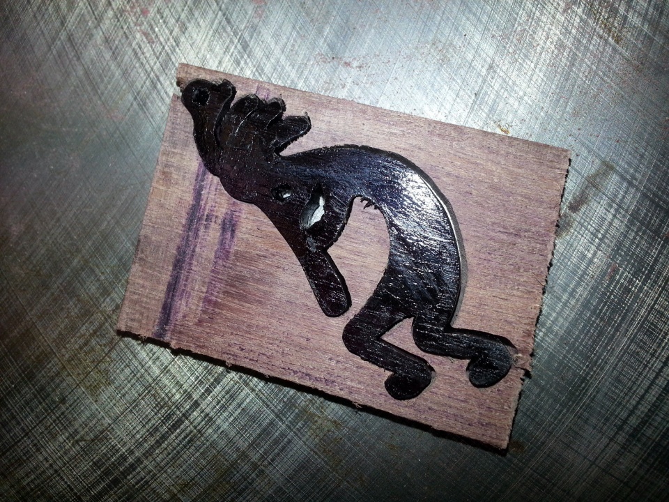

Wow! I just found out something about purpleheart I never heard of. I cut a pendant out of a scrap on my scrollsaw and popped it into the oven at 450F for 16 minutes just like I did on the previous knife scales but instead of that rich purple went all the way to a deep black with a slight tinge of purple. So there is a lower temperature I need to find that will take it to purple without going completely black. The picture is the pendant dropped back in to the scrap to show the color change. It looks shiny because I dipped it in Woodturners Finish.
