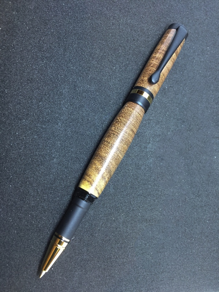

Finally got to turn a pen with the stabilized cross cut mesquite. Turned out OK but not quite the wow factor I was hoping for.
Root for wow, crotch for wow.
Nice looking pen. Much more attractive than ho-hum straight grain mesquite. Good job.
