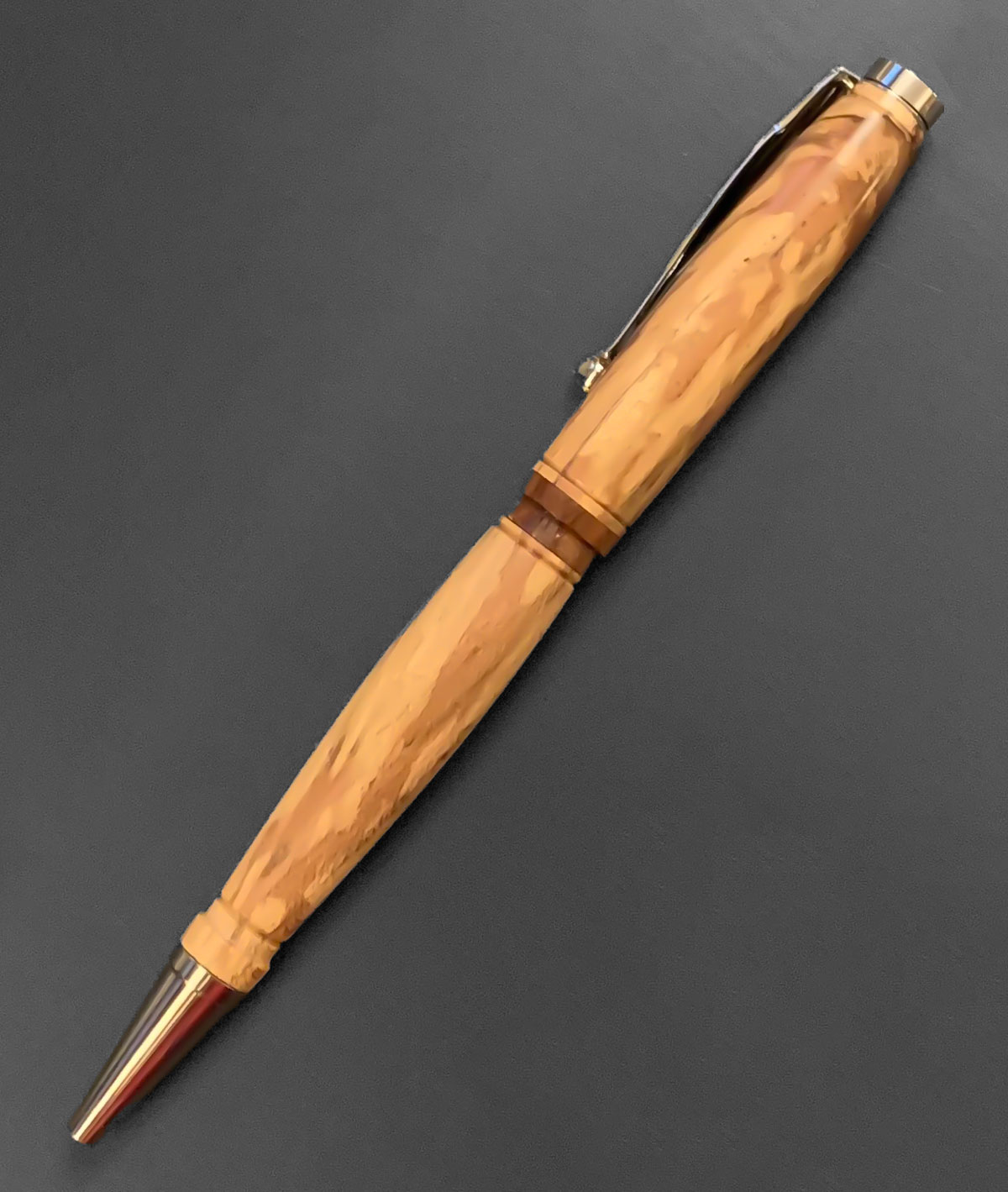

I was saving this spaltered dogwood blank from MRDucks2 and added a rosewood center band.
Thanks for looking
- Cullen
MRDucks2
Jul 17, 2017
3,227
Bristow, IN
Quite Nice! I am pretty certain that will be my favorite pen this week. šŸ˜ The band goes well and you were able to maintain the pinks in the dogwood very nicely.

Nice pen - especially the band. Is that rosewood one piece or two?

Rosewood band is one piece but carved with a strong crease to look like two. I'll defer to MRDucks2 to respond on the spalted nomenclature.

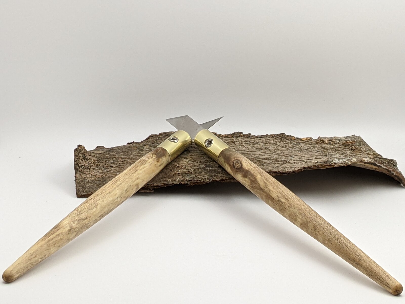

I don't see much in the way of dark lines on the pen, but I do see a lot of more subtle lighter/darker patches, which is what I'm mostly seeing on this maple (it does have the occasional dark lines towards the ends on some pieces, but they're few and far between). It gives the wood a lot of character (both the maple and the dogwood), but without the prevalent zone lines I've never been sure what to refer to it as. On some pieces it comes out looking almost like antler.
These are some craft knife handles I made from some of it (stabilized) last month:
