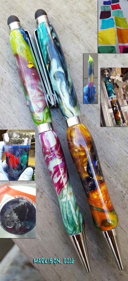

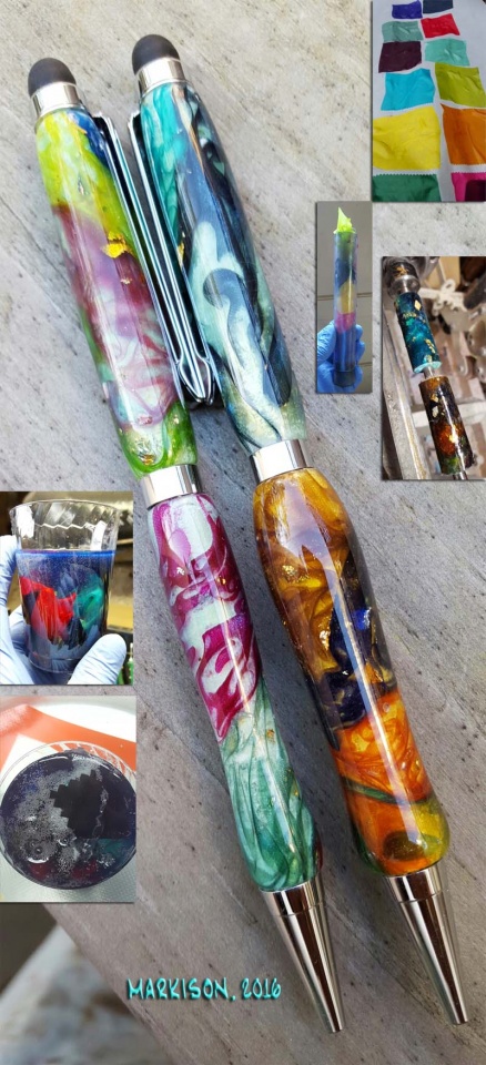

Silk kites flew beautifully over SF Bay and beach this past weekend - inspired me to get some swatches of 8mm Habotai silk; stabilized them in Cactus Juice (5 min. at -29.5 inches Hg vacuum chamber until bubbling stopped); laid them out on parchment paper; rolled up the silk-in-parchment; baked in the toaster over at 200 degrees x 1 hour; cast with Douglas and Sturgess clear casting resin in clear PVC tubes at 50psi; turned them; sanded to 12,000 grit (no polish); glad for the metamorphosis, and glad that Cactus Juice stabilized the (sericin and fibroin) protein of silk because I understand that the main function of the Juice is to stabilize wood fiber. Here are my first 2 pens - opens up some nice avenues for further exploration - stay tuned.
attachment.php
Warm regards, to all - Bob

Thanks, Danny!
I don't know whether I'll be selling blanks - but always glad to show the process.
