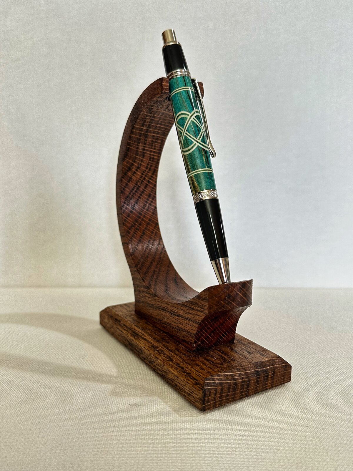

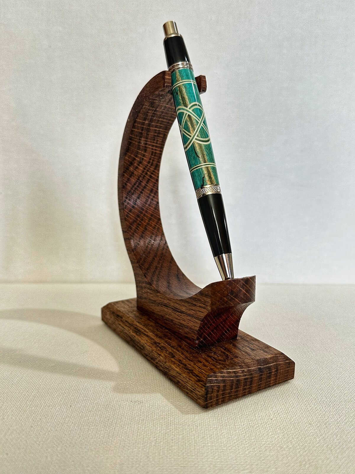

Celtic knots are my favorite blanks to make. I bought a blade with a .072 kerf, and wanted to see how that thickness looks in a knot. I'm quite happy with it. The woods are spalted maple and holly. The knot was cut at 55° using the 1,3,2,4 cut sequence. The pen is a Super Button Click. Comments and critiques welcome.

Is that a 7-1/4" blade? Nice work on the pen. Good combination of materials.
Ken, How did you choose the 0.072" blade thickness? Was it based on the thickness of your inlay materials?
Great looking pen by the way. I really like the 55 degree knot.

No my infill is created to match the saw kerf, not the other way around.
