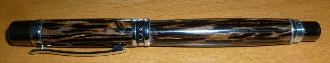

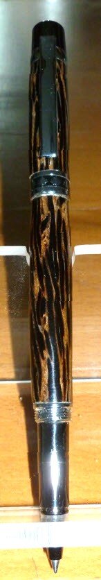

I tried stabilized black palm for the first time. I used it with the new Maple Leaf Chrome and Gunmetal rollerball kit from William Wood-Write. Although the black palm was stabilized it proved to be a challenge to prevent it from chipping or cracking. So, liberal doses of thin CA were needed at regular intervals. Despite that I am quite pleased with the result. It was sanded to 400 and then I usd Yorkshire Grit. The finish is Shellawax friction polish topped with some hard wax.

I share your issues with black Palm. Splinters if you lose concentration for even a minute !
Looks good though ! Nice work
Nice looking pen Graham.
I have made a few pens with Black Palm, but never stabilized. After drilling and cutting the corners off on my bandsaw, I soak them with thin CA before using epoxy to glue in the tubes. That way I get the CA to penetrate from the outside to the inside. After letting this cure naturally (no accelerator) I turn them. Because of the drastically different hardness of the hard dark fibers and the punky lighter matrix, I stop turning earlier on this wood and do more sanding. I have only used CA to Finish them and have had pretty good luck.

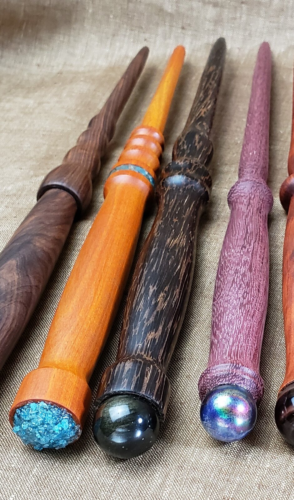

I must have just been lucky in turning it as I have never stabilized. That or my tools aren't as dull as I think they are? This wand even turned out OK without a brass tube to steady it on the lathe. It does make a nice looking pen (or wand, or...?)
