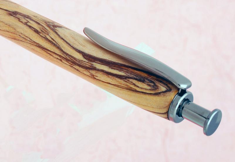

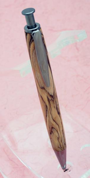

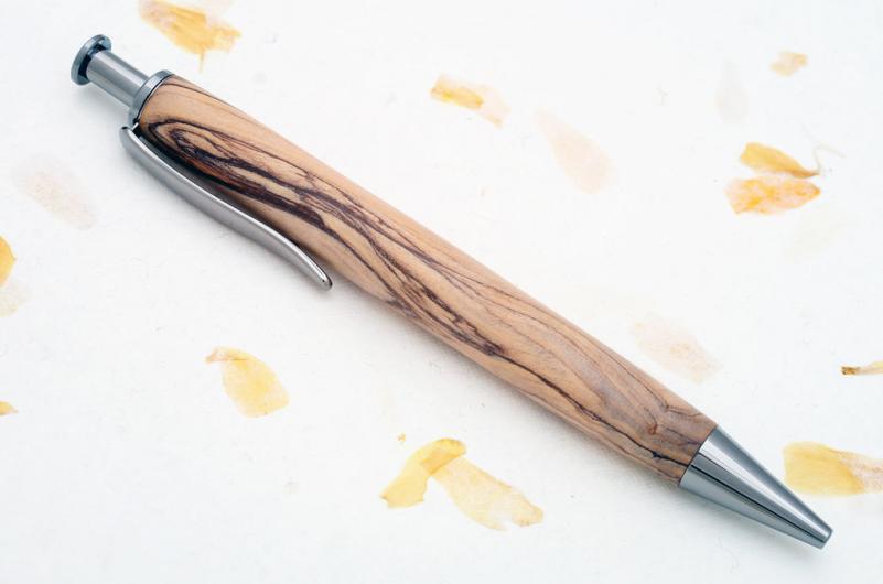

Stabilized Bethlehem Olive Wood in black titanium Clicker
See more from edstreet
edstreet
Aug 12, 2007
3,699
No longer confused....
Stabilized by WSSI.
No CA on this one.
1:1 macro
1:1.2 macro
1:1.5 macro
1:2 macro
Great piece of Olive wood...!
Excuse my ignorance but, what does WSSI stands for...???
Very good close ups there, and as always they are great to show everything, even the stuff we can't see with the open eye, and that brings me to the next question, what that white stuff, stuck in the wood porous...???
No CA you said so, I assume that is the sanding dust from the plastic stabilising material, right...???

WSSI, Wood Stabilizing Specialists, Int'l., LLC | processed, dyed, & stabilized woods for manufacturers and artisans , is a professional wood stabilizing company here in the US. They have perfected methods to stabilize just about all types of wood, even olive wood. This is *NOT* a backyard process.
The white stuff is a combo of dust, lint and reflections. I did use Novus and that might be some of that as well after all it is white. Also keep in mind this is 1:1 macro region and every little spec of dirt, dust, imperfection and the like will show up very plain.
...The natural pores of stabilized woods remain open after treatment. Since no finish is necessary and most knifemakers simply sand the wood to 400 or 600 grit, then buff with jewelry polishing compound, some of the compound may be trapped in the open pores of the wood. If this is a problem, stabilized wood can be filled like any other wood by impregnating the open pores with a quick-setting glue and sanding dust from the wood itself. Fred Roe seals the pores with an acrylic before sanding and buffing...
Olive wood does indeed stabilize VERY well if done correctly. I took ONE pass with my round nose scraper and went from a square block to a round block, took about a minute for that pass but it was smooth and even, that to is due to being stabilized, it makes it very good to work with and not lumpy. This particular blank I have had since 2005 and it is from Israel.
Stabilized woods will not soak up water, grain will not raise, wood will not warp/twist, resist cracking checking and shrinking, will not take stain or dye. It is just sand and polish.
Two-part process requires applying acrylic resins to a handle material followed by a curing period. The result is a water-resistant, harder-than-untreated wood that can be machined and drilled, and that can be polished to any finish you'd put on steel, from satin to a high gloss...
Basically it's a blend of monomers and acrylics, placed in a vacuum pot then autoclave.
...You don't have to apply a finish to stabilized woods. You need only sand the work piece with a succession of 100-, 320-, and 400- grit abrasives, and then buff with a compound to bring out a deep sheen. A coat of wax protects the buffed surface...
I went from my scraper to 220 grit paper in strips to 600 grit then 600 grit with novus, then novus with a paper towel then novus with my palms. A good proper polish like this does make the wood feel very silky and unique. From the macro shots I see one line that I did miss and I do not see it with close observation but only under heavy magnification.
So as you can see there are many benefits to real stabilization.
* quotes taken from WSSI's webpage.
