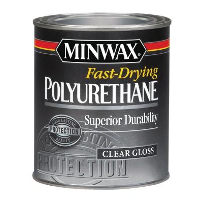

pls advise what is "oil base" poly? tks
Note 1: Anything that is oil-based is going to burn pretty good. Keep it out of your toaster oven. Dry the blanks using time, not heat.
Note 2: Toaster ovens don't really do 'very low heat'. The way that they typically work is that they are either all the way on or all the way off. They use a thermostat only to cycle the element on and off so the oven stays close to the set temperature, but when the element is on, it's ON.
