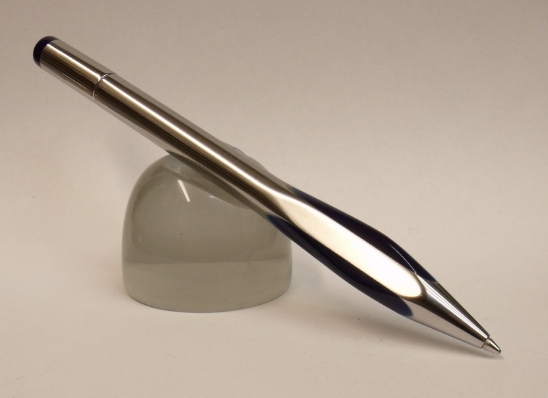

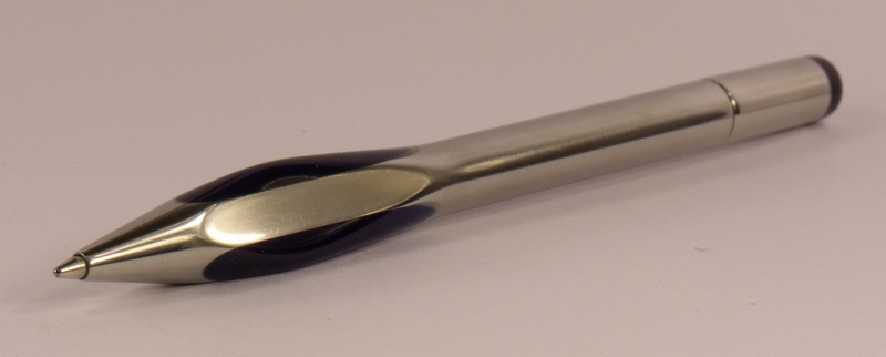

Well, the Christmas shopping is done. My Honey-do list is finished....so I had a bit of time to play today...:biggrin:

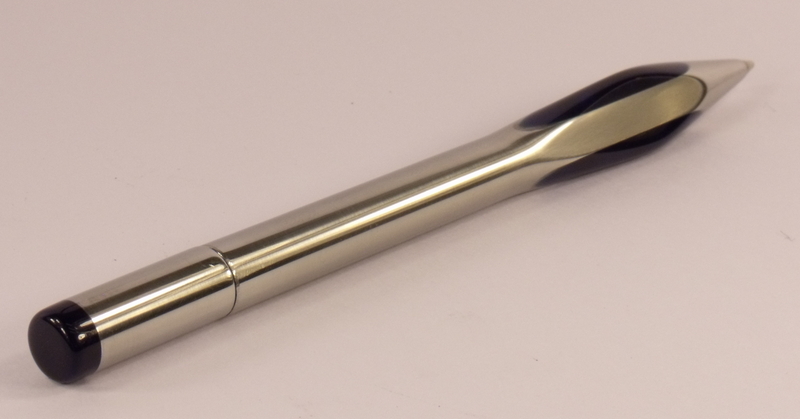

This ballpoint was made with stainless steel hex stock with just the grip area left unturned. 3 Sides were then fitted with blue PR bits to make the tri-lobe shape which is great to hold. The twist mech is in the finial / end cap. The three flats that the PR is fixed to was drilled with several holes to get a good key for the glue.
Fun to make and great to eventually get back in my toybox again.... I've just got an easy job tomorrow and Tuesday and Im off till the New Year.:biggrin:
Hope you like it. :smile:

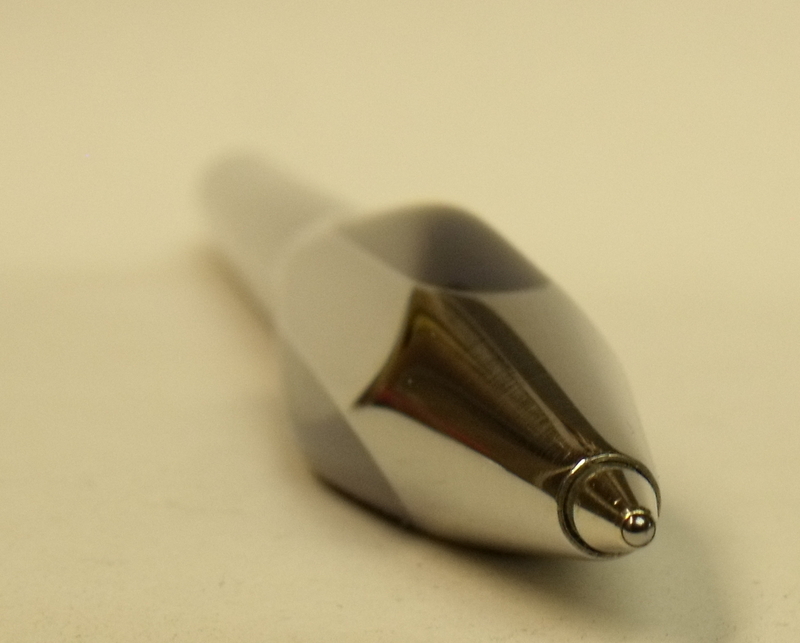

Very nice Skip as usual. You need a better shot of the blue lobes. It is a bit of a different design and bet it has a different feel to it. Thanks for showing.

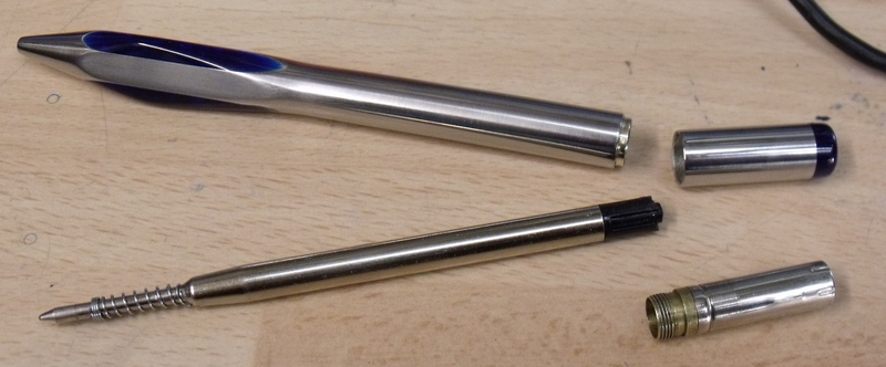

Love it Skip. What type of transmission and refill did you use? And the pen really is awesome...

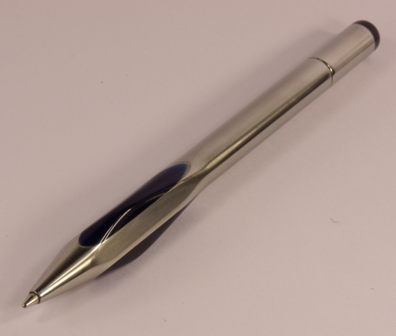

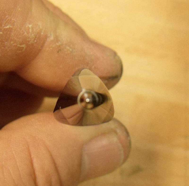

JT, not sure how to get a better shot of the lobes. I swear I was better at pics a few years ago, than I am now....:redface:
Here's a few more pics that hopefully show the lobes better. The blue looks a bit darker in the pics. It's actually similar to the IAP logo colours....

Mr Vic, it takes a generic Parker style refill and the mech is robbed from a cheap kit. I think there are several kits that use this, or a very similar mech.
I like them and fortunately, haven't had one fail yet ( touch wood ):smile:
You can see that I had to shorten the spring a bit. Thats because I don't have a long enough small drill bit to seat the spring ( bigger than the refill tip )

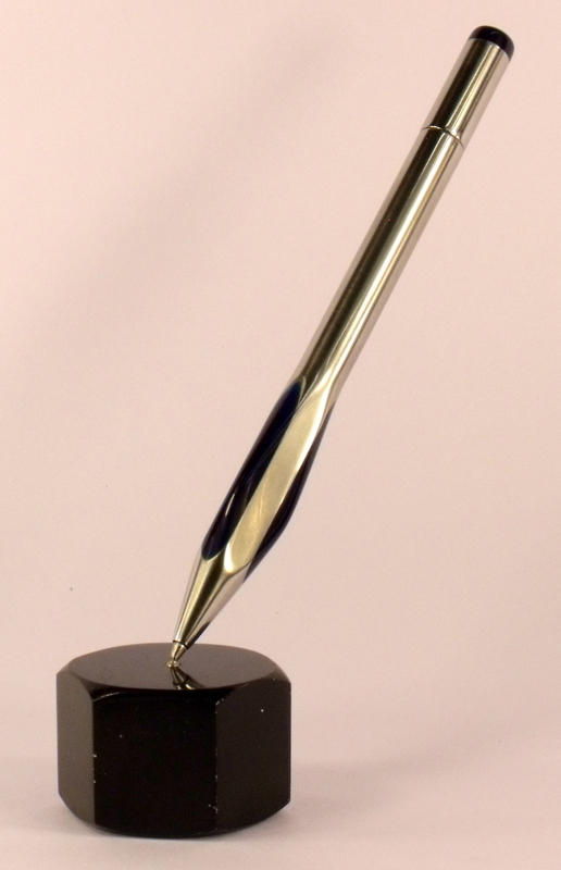

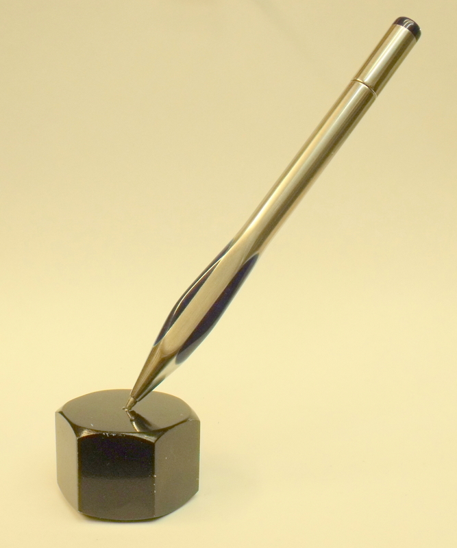

I LOVE that pen !!!!! . It is supremely simple, sleek, and s--y !!! . It must be a joy to write with !!
Now, if only I could figure out how that stand works and "levitates" the pen !!!!
So far....I haven't seen ANYTHING you've made that, I can copy :redface::rolleyes:
Could you please tone it down a notch or 9? :biggrin: This one is really unique even for you. :wink: Thanks for sharing and, giving me something else to look at for hours. :biggrin:
BTW, how did you get that pen to pose for the camera that way??

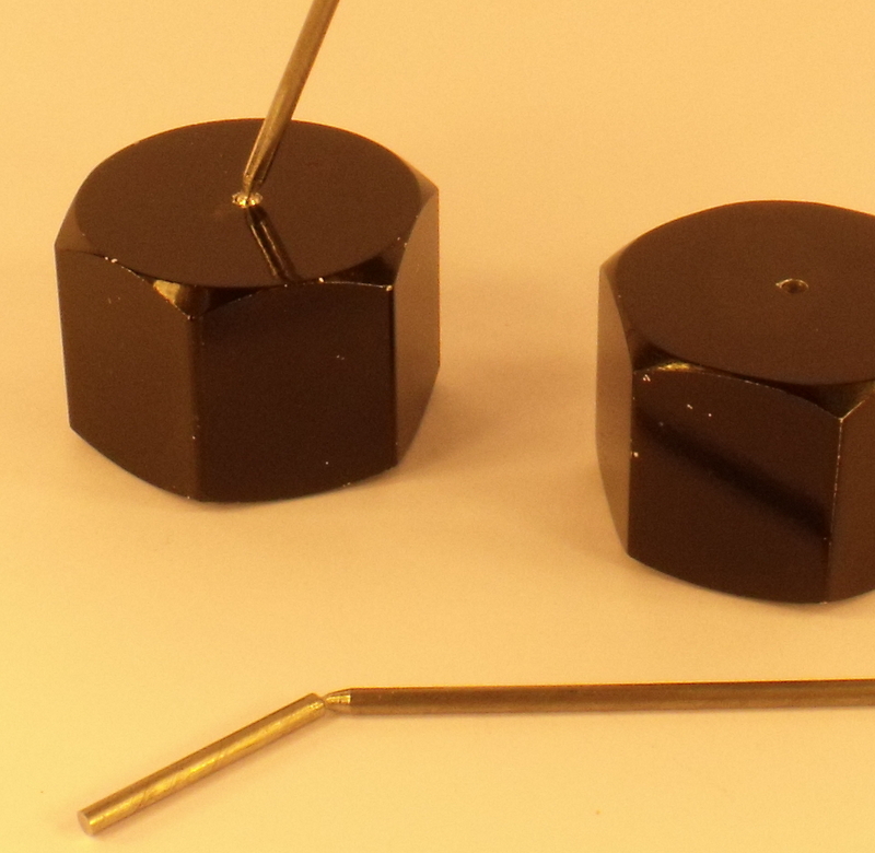

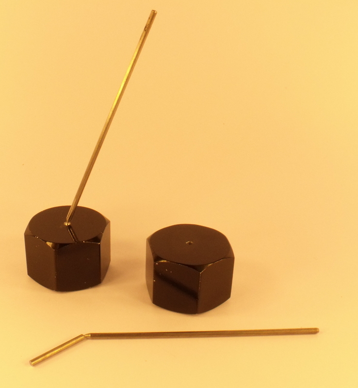

Magnetic nuts???
Thanks again for the kind comments. :biggrin: Always appreciated.:wink:
Ok, the secret of the magnetic levitating nuts is revealed in the attached pics....
I use two pieces of stainless steel welding rods with the flux removed to make fake refills. One is the same length as a roller and the other as a ballpoint.
Years ago I used the same rods but through a piece of cloth into a wooden base. I also have one where I drilled a hole through the feed of a fountain pen and the rod was hidden from view by the nib. But I very very rarely make fountain pens any more and don't even know where that dummy feed is now.
I filed a groove ( on the lathe ) to make the refill point and then bent it at an angle. I then carefully cut the ends to length...
Simple hey? :biggrin:
Feel free to use the idea if you wish. :wink:
