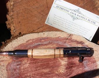

:island:OK so what is the problem??? :)It is the most basic thing of segmenting. Find the center of both ends of blank. (draw a line from corner to corner to form an X and that is center) Put on lathe. make blank round or whatever shape you desire. If you want aluminum for the rings. lay your pen tube on the blank and mark where you want the rings and part off. Add rings and be done with it. I have sen these blanks. here are some examples.
By the way not mine. They are all over the net just do a google search.

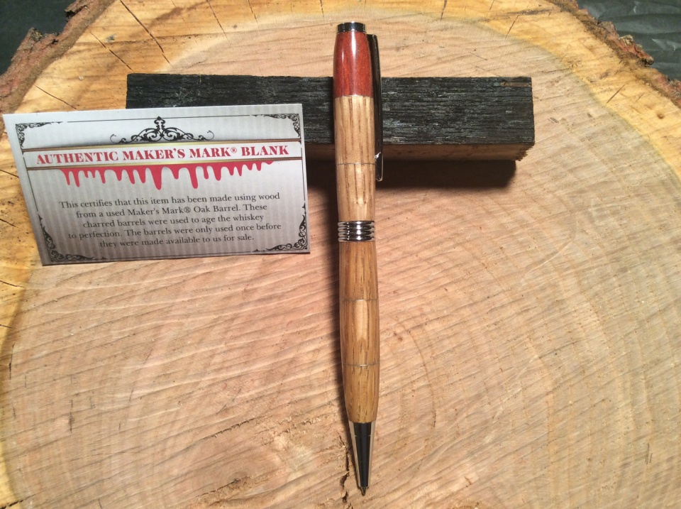

Finished up tonight. I was hoping the aluminum gave an appearance of the rings on the barrell. I used blood wood at the top to mimic the red wax used on Makers Mark bottles. I am not a fan of oak, but it is what he wanted.
Looks good and i am sure he will like it. Maybe next time use a thicker piece of aluminum such as 1/8" or so. Oak is one of those overlooked woods because it does not have drastic grain patterns but teamed with the right combination of woods such as bloodwood or walnut it stands proud. it is a manly strong statement wood. I use those combinations in alot of projects I make and they sell well.
