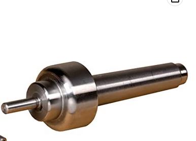

1st I mounted a jacobs chuck in the headstock that held a 2" sanding disk with replaceable hook and loop paper and installed 60 grit circle.
2nd in my tailstock, I mounted my PSI Turn between Centers Live center.
Then I started figuring out what material to make my pilot shaft for the blanks from. Then it hit me....... Why not just use the bushing!!!!!?!!!!
So I put the bushing onto the live center and the bushing went perfectly into my blank. Almost like it was designed to !!
Brought the tailstock up within and 1/8" and then just moved the tube back and forth on the 7mm rod on the live center.
Perfectly squared blank with zero blowouts!!! Funny it took me 20 years to have this AHA moment!!
Thought I would share in case anyone else was having the same problems. Will work with any blank because all the bushings have a 7mm hole for the mandrel.

Glad it works for you but I can't figure out how the end being sanded stays square when it's only being held from the opposite end. Can you post a picture with it being used?
