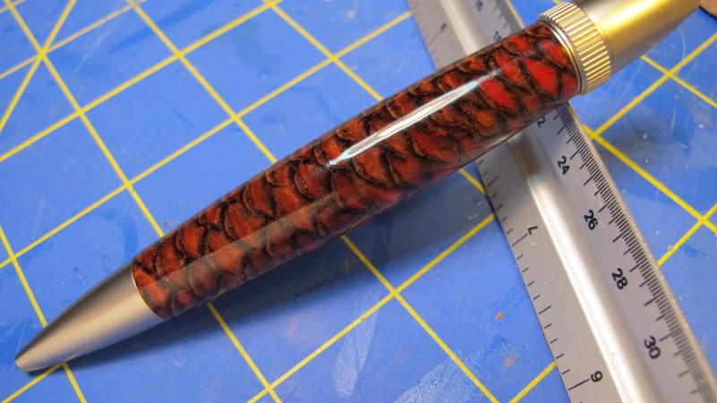

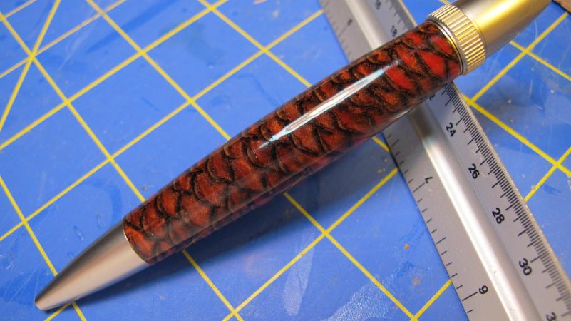

This is a cast stabilized Norway Spruce cone. The cones are not very large so they lend themselves nicely to singe-piece pens.
This one is cast with bronze powder and a dab of liquid red dye and is finished with brushed lacquer which gives it a unique feel.

Thats one sweet looking pen! Did you cast that yourself? If so what did you use?

Cabhog: Thank you! Yes, I cast it myself using epoxy resin. I find this to be much better than other casting resins because it penetrates much better and when turning, it does not melt or discolor due to heat friction from the tools.
SBD777: No, the Norway Spruce cone has very fine petals, almost paper thin. When I prepare a cone like this, I have to be extremely careful because the cones are very fragile, but once stabilized are quite easy to turn.
