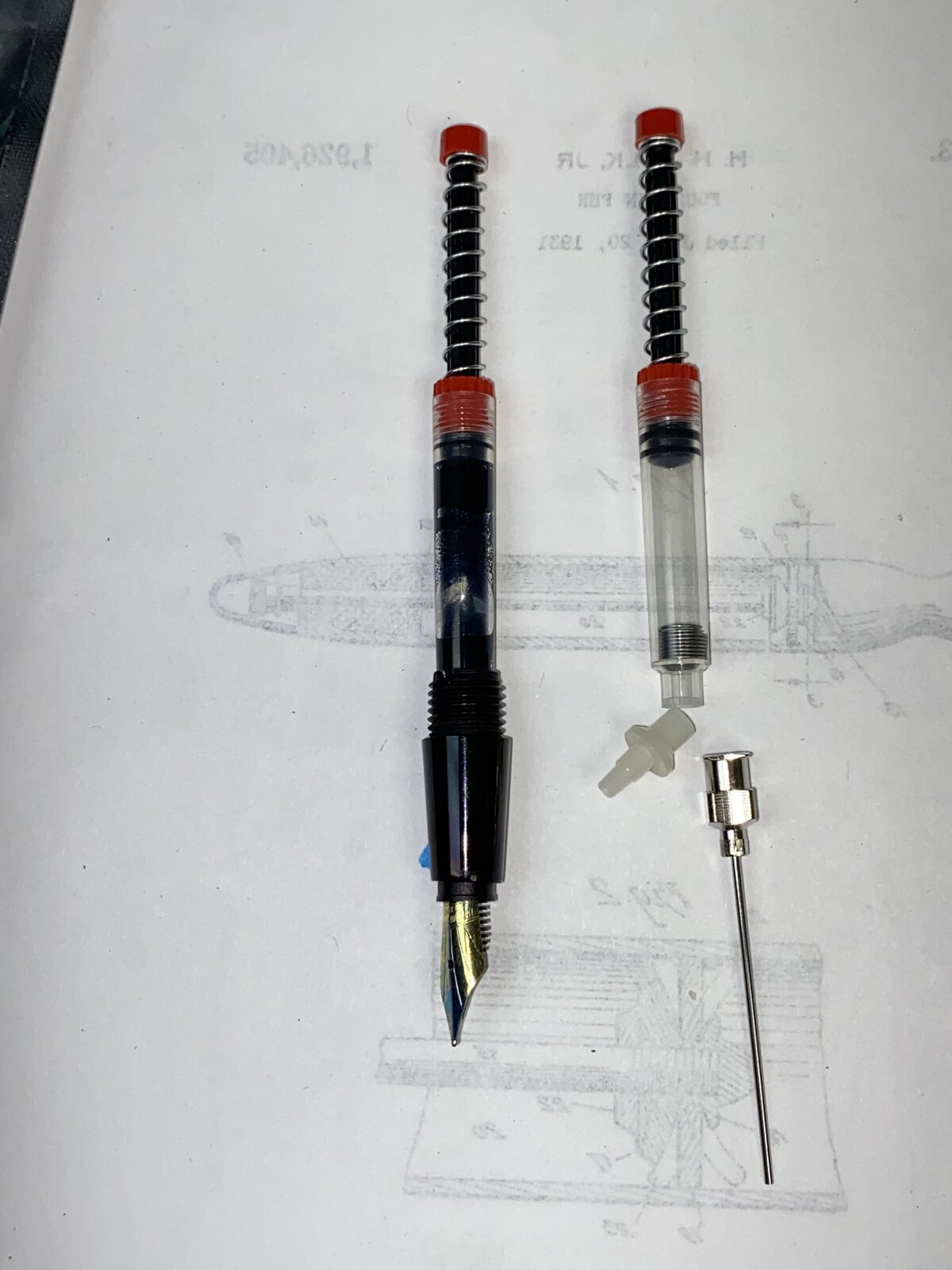

I was looking for a syringe for filling the cartridge of my Pilot Parallel pen. I found what I was looking for at Anderson Pens and a Con 40 converter. However, I found these spring loaded cartridge converters on Amazon. They are the same size as a regular converter and hold about the same amount of ink. I find them easier to use. They also come with a blunt needle and coupler for a syringe.

These look interesting for another reason - it looks like they are a uniform diameter along the entire length, unlike regular twist-style converters which usually have a wider collar around the screw mechanism.
I have a couple of kit pens where the regular converter doesn't quite make it through the threaded coupler that the section screws into, these might work.

Duncan said it better than I could. I found while searching for syringes. I'm not sure if they would come up as converters.

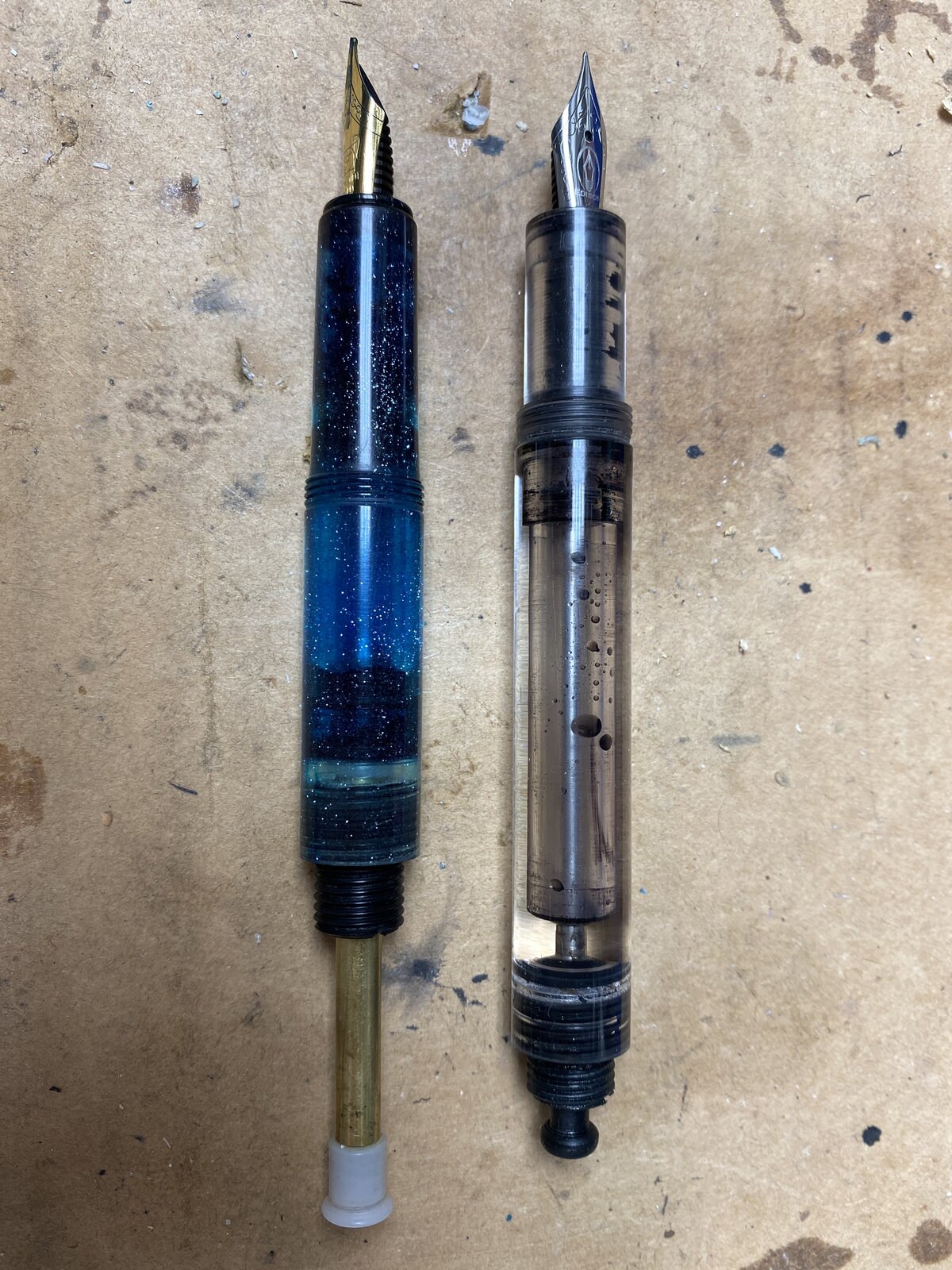

This is kinda of a small point but I thought a plunger filler was a filling system where the plunger was pressed down and a vacuum was drawn behind the seal. When the seal hits a relief at the bottom of the stroke ink flows up into the reservoir. A syringe filler is what you described and what these spring loaded converters are. Just asking because I like to get my terms correct. I've made two syringe fillers and am making my second plunger filler now.
Clear plunger on the right, blue syringe on the left.
Thanks
