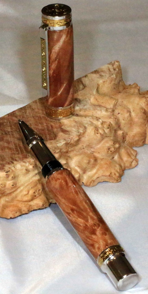

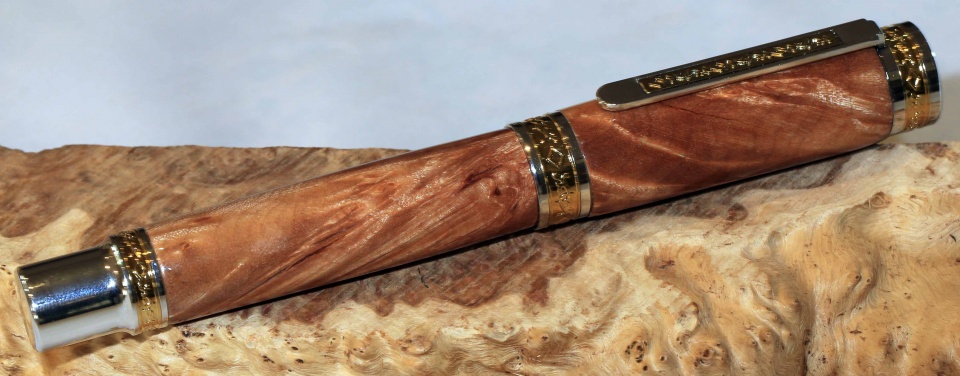

This is a Spring Blossom Pen done in Maple Burl from Exotic blanks, and finished in CA. Had problems in drilling the blank. The kit instructions said 14.5mm drill, but in reality the tube would not go in. So it probably needs a larger diameter drill bit perhaps 14.7mm. So I had to think outside the box again, and shifted the blank ever so slightly, and redrilled to enlarge the size as I didn't have any larger drills. It worked!:smile: Slightly oval hole though. Then the plastic bushings that I use while doing CA finish was too small as the tube was huge, hence I ended up using the metal bushings with apprehension but that too worked. The result was this pen. First time I was using Maple Burl, it turned well.:biggrin:

What a Spectacular Maple Burl Blank the "Chatoyance" is incredible.
Sean, you have Hit a Winner with this Pen.
Apart from your drilling problem, which I hope you filled the "Ovality" with adequate Adhesive, your Fit and Finish is Magnificent.
The Spring Blosom kit sets the Blank Beautifuly.
Just a though, I can't help but wonder how that Blank would have looked on a less Ornate Pen, one that would not compete and just let the Blank take over?
If you have any more of that Blank it could be interesting to give it a try.
Congratulations on the pen and your great gesture with your nephew.

Sean good looking pen. Good looking blank that you used as well.
