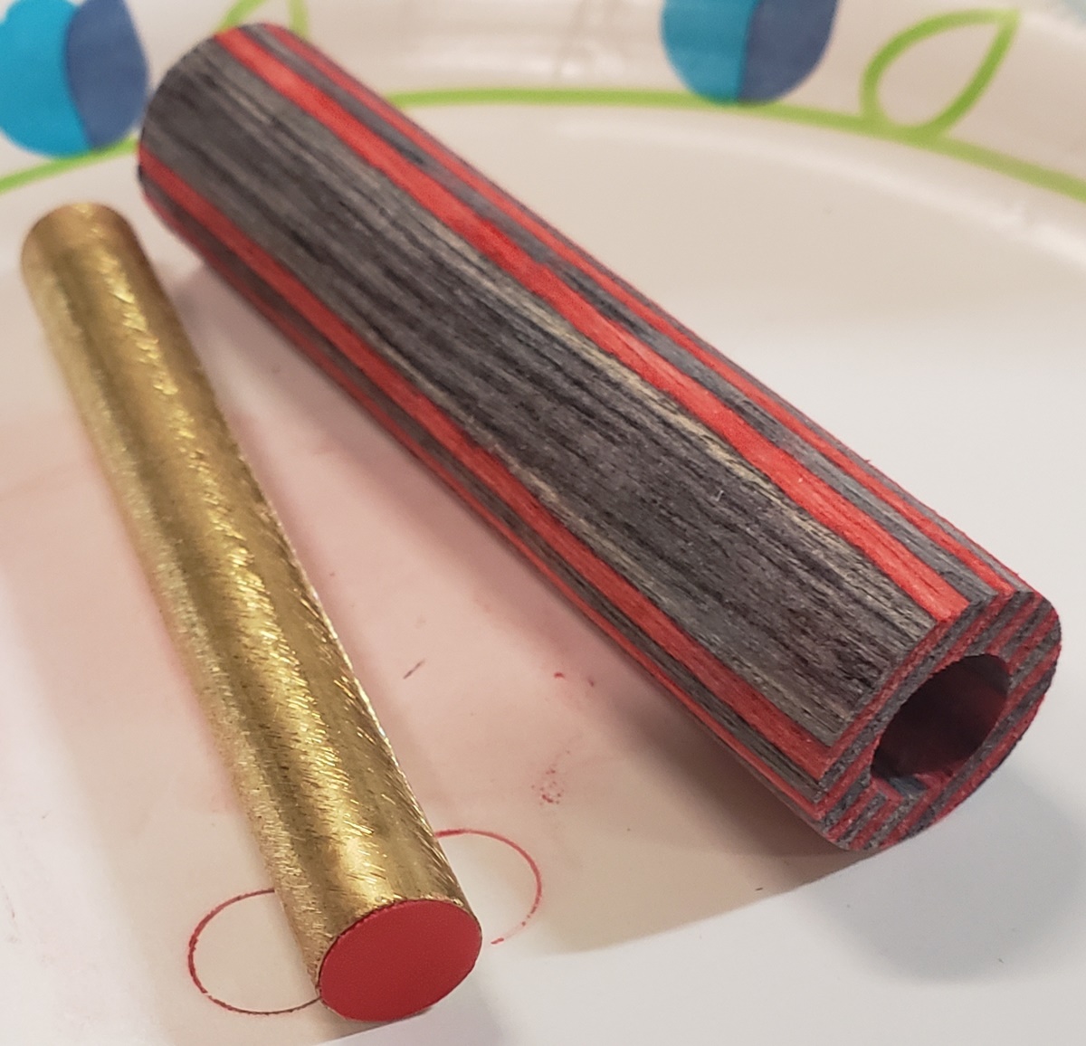

A laminated pen body. I wouldn't spray it while it's on the lathe.

I would think that spraying would be fine, just very time consuming. With spraying, you usually have to let dry for a while and then sand between coats. Seems a lot more hassle than maybe wipeon poly or something else that can be used on the lathe.
I have thought about it. But as several have mentioned, overspray may get on your lathe, unless you cover it in sections. The ideal distance for spray being about 12 inches - will cause the spray to get on more than just the turning blank. However, I wouldn't let that stop me from trying. I would look for a finish that sets up in a couple of minutes or so, let the lathe keep turning with a D.C. working to keep air flowing around it.

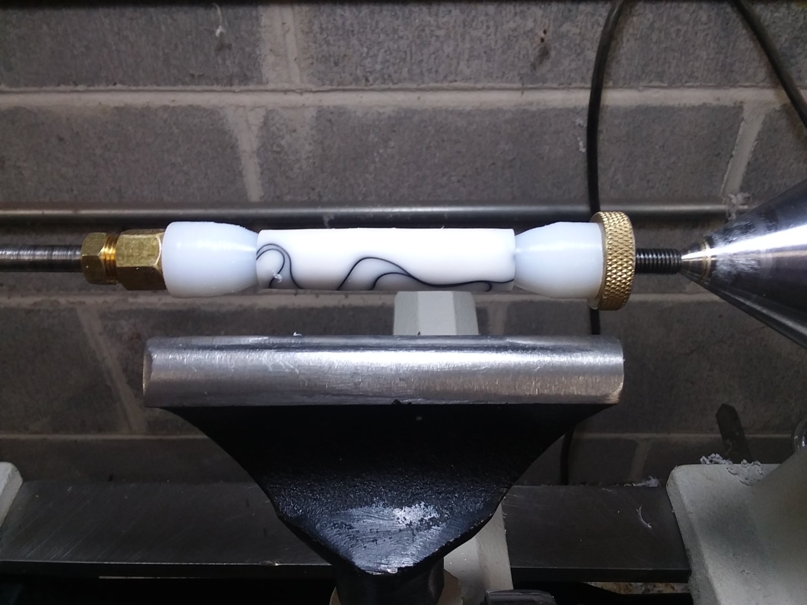

Hank, could you drill the 2x4 the same size of the mandrel shaft, if using a mandrel? I came up with the HDPE spacers/bushings.20191229_194645.jpg I'm looking at the cost of the tubes even though they aren't the expensive part of pen turning. OK, so I'm cheap.

I rarely do wood, almost all acrylic, but I do some segmenting with wood and have done this a fair amount with good success. I have a couple of set ups.....one I made myself using a spit from a BBQ and another I bought from PSI. The issue is the material whether sprayed on or wiped on will often form a drip that is difficult to sand off. So the blank is rotated to stop that drip from forming.
