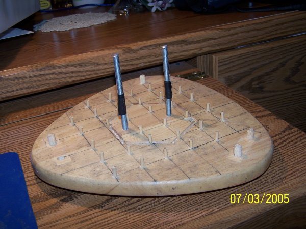

I built a little finishing "Turntable" for my small projects. It has a base with about 30 1/8" dowels that hold the workpiece up, and spins a full 360 degrees so I can get even coverage. I drilled two 1/4" holes near the center and when I spray Lacquer on pens, I use 1/4" threaded rods that hold the pens upright and have no "contact" with any surface (and no overspray near my lathe).
The tape (picture below) keeps the tubes elevated.

If you use the threaded 1/4" rods on the turntable, the tubes are basically plugged (for 7mm tubes). I just use some electric tape on the rods to get the thickness I need for the larger tubes.
