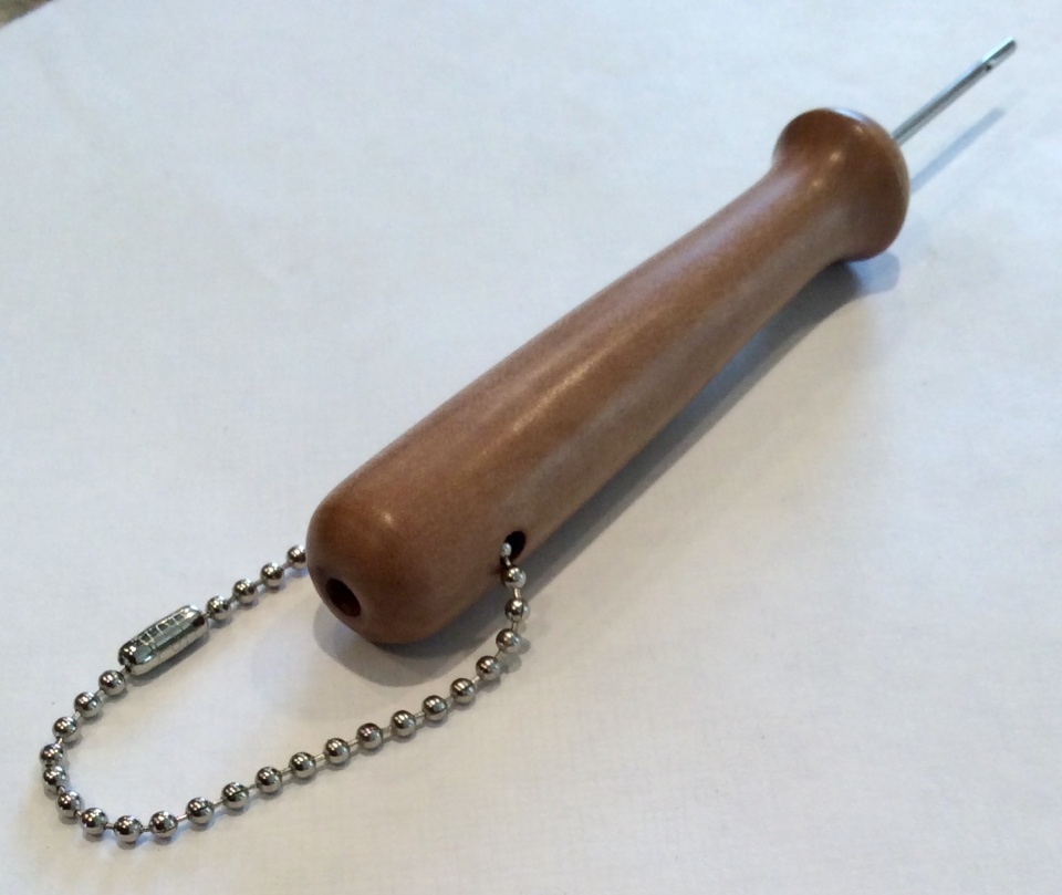

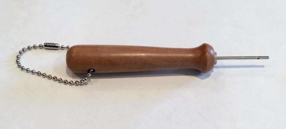

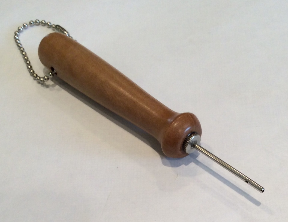

Wifey has her Housing/Home Furnishing students doing a project using an inflatable ball and wrapping with glue soaked yarn to create lamp shades. The ball needs to be deflated and removed after the yarn dries.
When asked about the inflater needles, I said " I have one or two in the garage/shop".....but could I find them?...Nope. Not near the air compressor or in the baby food jar with the valve stem caps, valves, etc.
So, off to Walmart this morning...a pack of two for $0.96....a little while later, I have a custom deflater needle!
Maybe this one won't go missing!
Cherry-Beall buffed. The needle is semi-threaded/epoxied in place.

My afterthought is next time, drill and epoxy a metal valve cap in the handle. Then the needle could be removed for inflating as well.
Just remember to drill a vent hole in the valve cap
