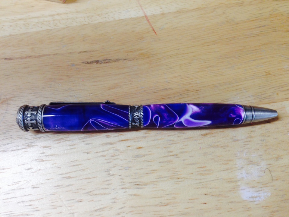

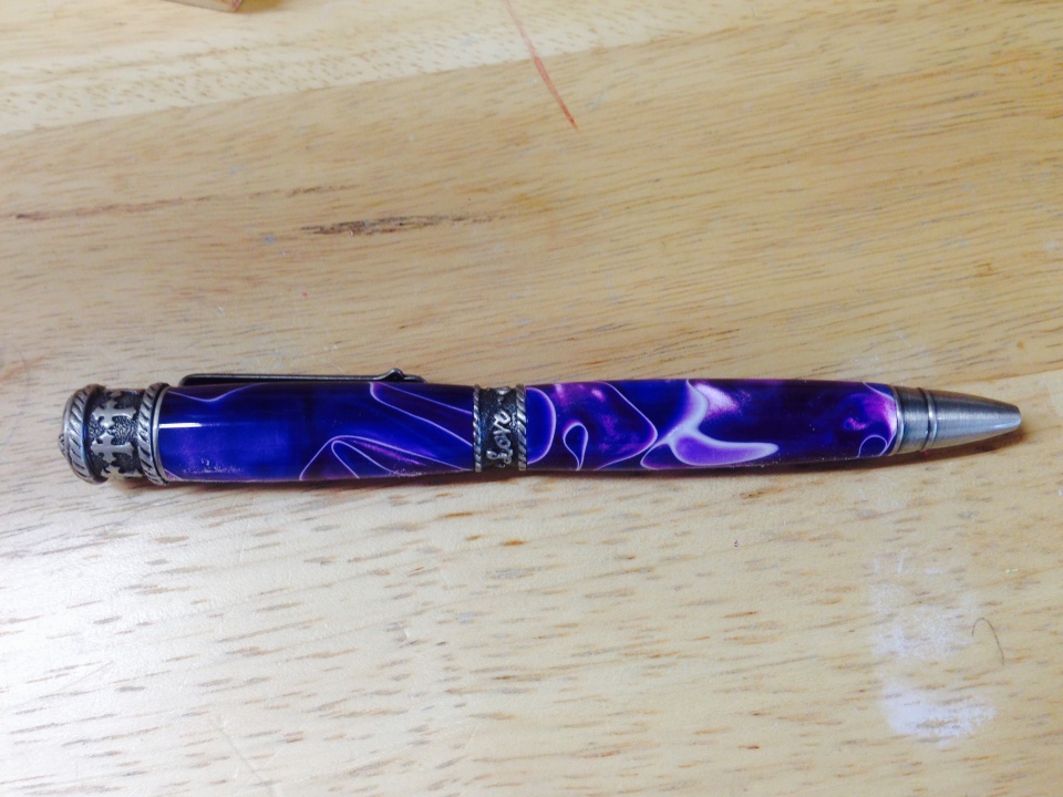

I have done one F,H,L pen and did not have any problems with fit. I did it in Bethlehem Olive Wood and it looks great. I got the three pack and will definitely be making more, as I suspect they will be popular. I like the looks of the one from Signature, too. Sort of a Pastor's Pen feel to it.

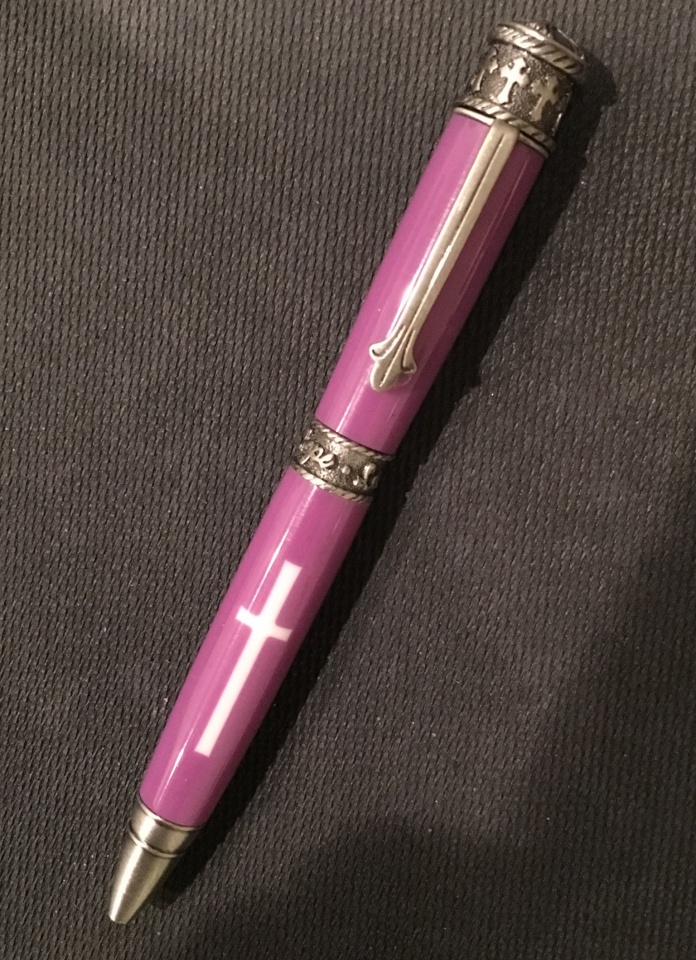

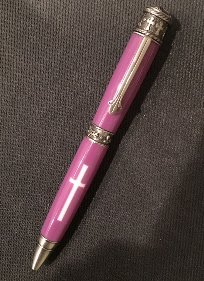

Years ago, when I was just learning to turn pens, I wanted to make a pen for the Priest and Assistant Priest at our Anglican church. I special ordered three blanks in royal purple with a gold cross cast in the blank. The blanks were expensive, but truly beautiful. It was my first time turning acrylic. I was almost finished with the first pen. Just a FEW more passes with the skew. Then a little catch and the blank exploded....totally vanished from the lathe! That's when I realized I probably should have glued a tube into it first.....Senior moment. Thank goodness I ordered that extra blank.
