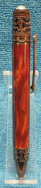

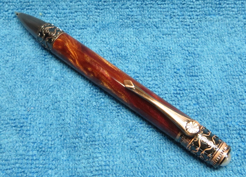

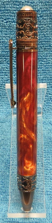

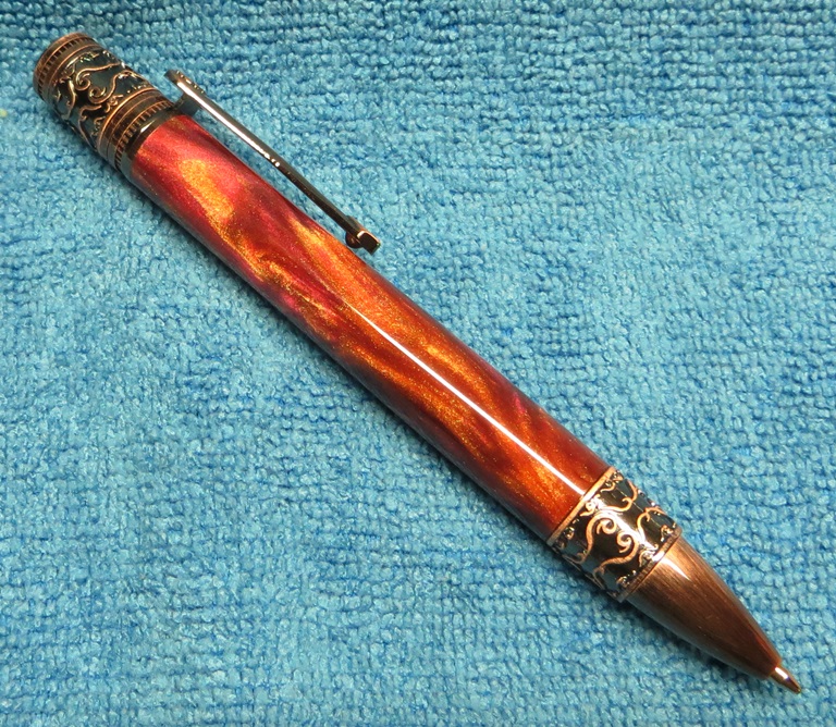

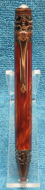

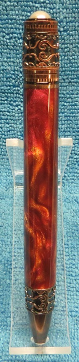

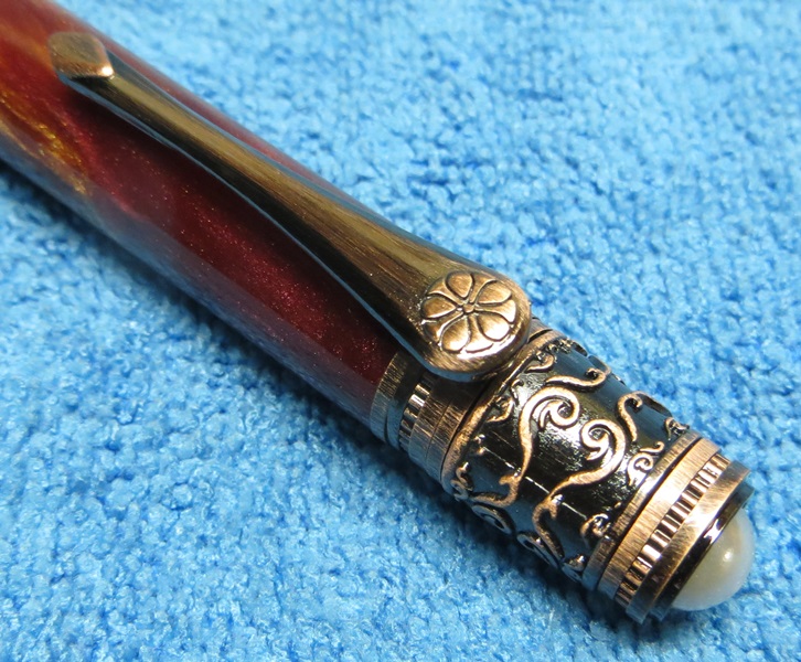

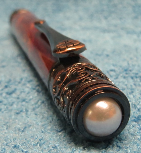

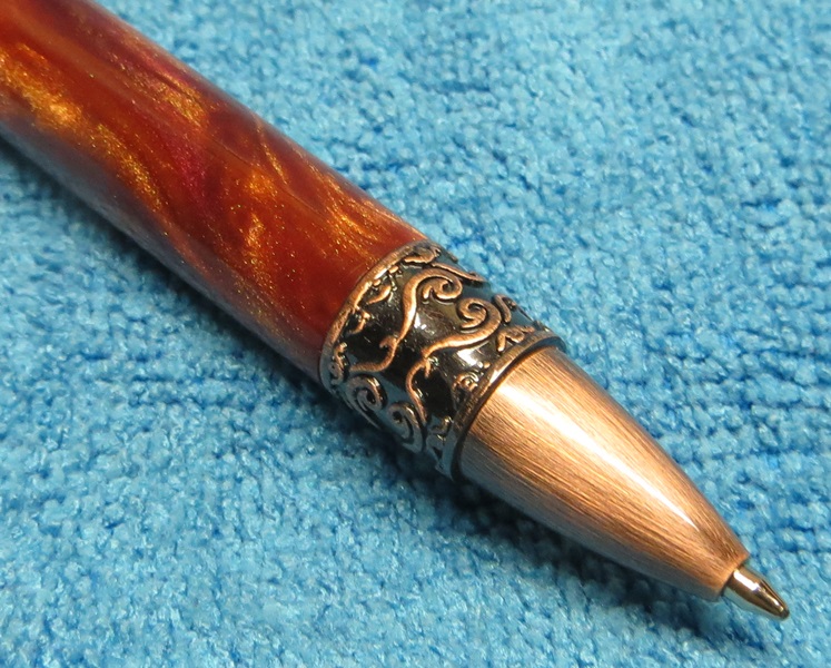

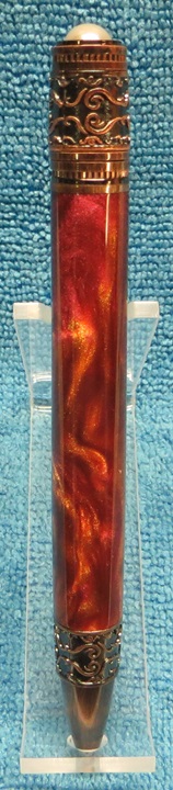

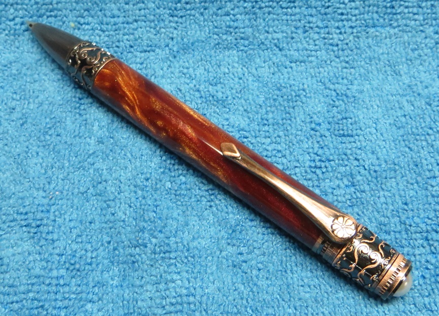

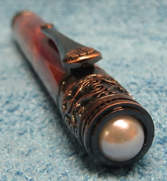

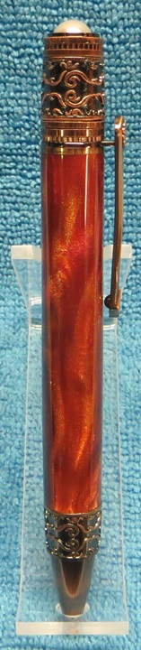

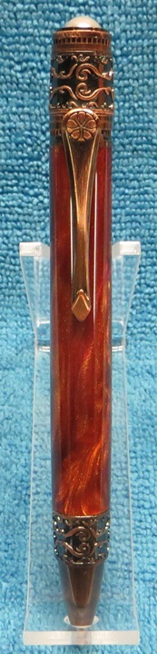

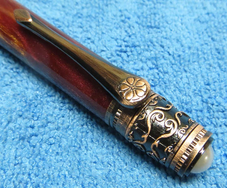

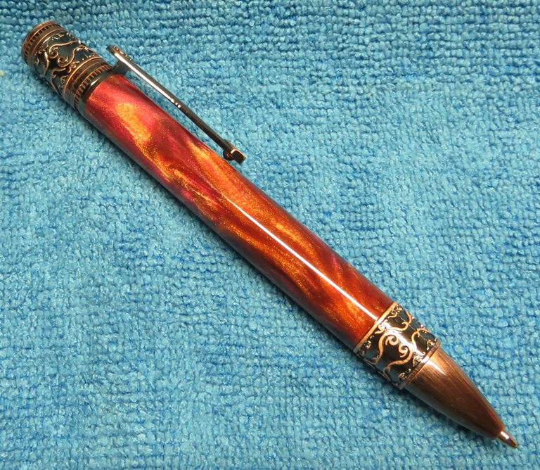

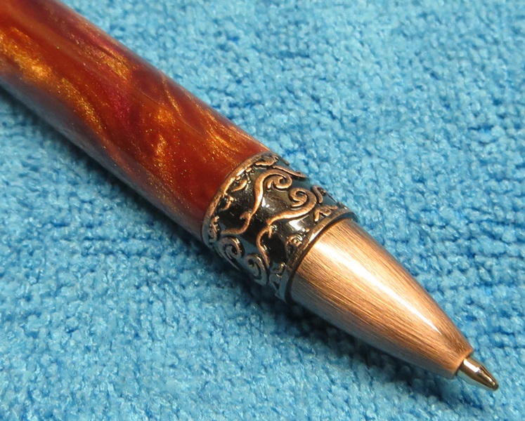

This is a Spiritual pen from Signature Pen Supply, in antique rose copper. The blank is a Woodshed acrylic called Mulled Wine. I didn't know what to expect from a blank with a name like that, but I was pleasantly surprised!

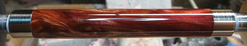

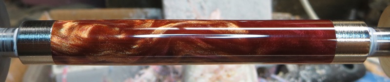

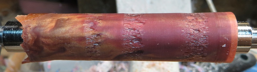

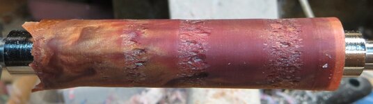

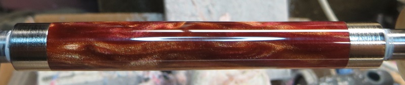

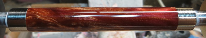

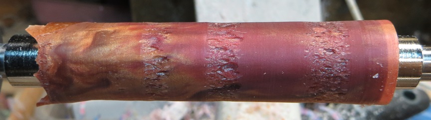

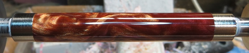

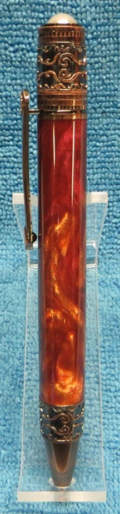

This is the second Woodshed blank I've turned, and both have been rather brittle. They don't do well with my normally heavy handed turning style. But I took it easy, and got it done. They sure polish well.

Glorious Pen, Jim.
Spectacular Blank.

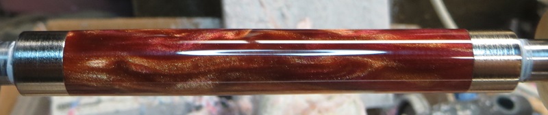

I would be more than a little worried, with the overhanging section of the Blank, as shown in Photograph #1 of your second Posting.
In starting to reduce any blank, I normally turn down to close to the Bush with a either a Roughing Gouge, and later a Skew, to remove as much of the Blank, on an inclined plane toward the Bush, at both ends of the Blank.
Thus as I turn the remainder of the blank, I am turning to an already reduced diameter surface, hence avoiding the potential for a break away.
Back to your Finished Pen, it is Magnificent, Love the Hardware.
And the Blank matches perfectly.
Congratulations,
Brian.
The pen looks great and I'm glad that it worked out for you in the end. A lot of acrylics do not do well with a heavy hand, even the ones I make. I get that chatter myself on occasion.
If you ever have any problems with a Woodshed Pen Co blank, please feel free to contact me directly. Or you can go through BTW as well and they will contact me.
Mike
