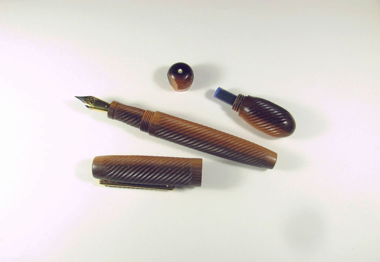

Here is the pen I made for the Bash kitless contest (bocoa wood, right), and two leftover entries, one made of boxwood - left, it was actually a draft for the bocoa pen - and an African blackwood pen. All were made with a Sorby spiraling tool.
C&c welcome!
The pen rest in bocoa is also a cartridge container:

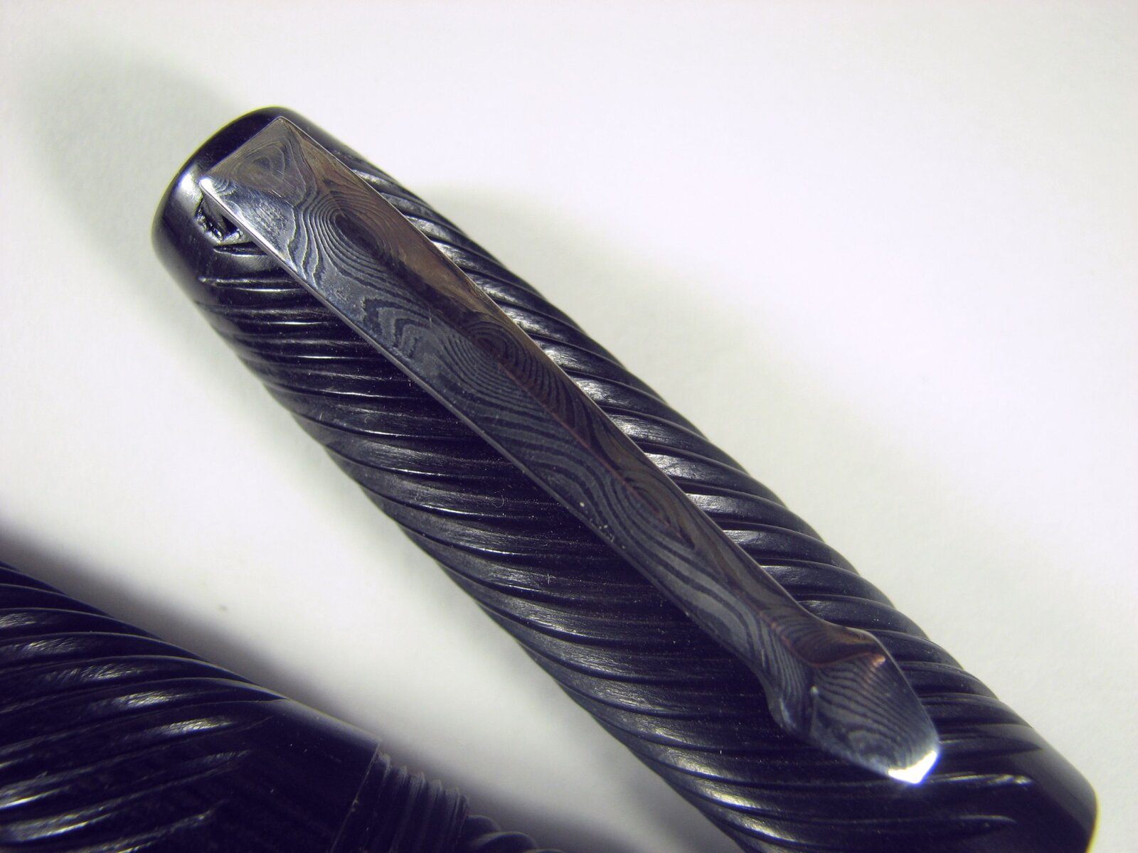

I find the assembly of the Damascus clip and the spiraled wood looks interesting:

You are making the process for making these look so effortless. All that with a bit of French touch, that cartridge container is so cute! Am I thinking correctly that you put the thread on the piece first then clean the threads at the extremities?
So that leaves me one year until the next BASH to get into the clip-making business... I'll try my best, but I can tell it's not going to be easy to compete! Thank you for sharing!
All three pens turned out great. I really liked your entry. It got my vote! How did you secure the clips to the caps? Did you use a rotary tool to cut the slot?
Nope, I first shaped the piece, started the spirals on the cylindrical part , and then pushed the tool up to the round end.
For the Damascus clip, I made it with an indented tab. I cut the cap slot with a Dremel rotary tool monted a Oneway Drill Wizard to be regular (not sure it is better than freehand, but it happens I have one), adjusted it with micro files and a homemade chisel, stuffed the hole with plenty of epoxy glue while pushing a piece of wood to squeeze the tap in the cap bottom.
For the kit clips, it is nearly the same, except I cut a third of the the ring until it goes into the hole, a method used by the late Russ Fairfield who called it "invisible clip".

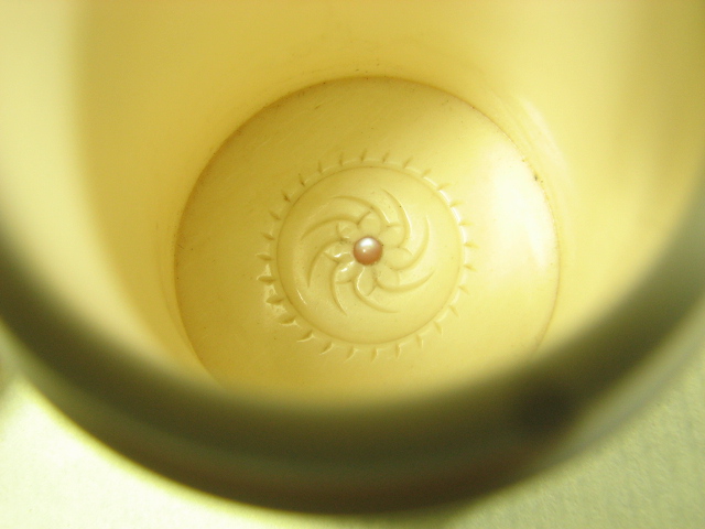

Joe, if you use very hard wood and take time to learn how to handle it (Sorby made two great YT videos), you can make a lot. I must admit I am never 100% sure to get what I want, but the tool can make different things, not only spiraling. I needed around 30 seconds to make this little flower with sun and spiral on a piece of bone:
Great pens Pierre! I really like the spiraling and I'm amazed you can do that with the Sorby Spiraling Tool. And that 30 second design on the piece of bone...wow!

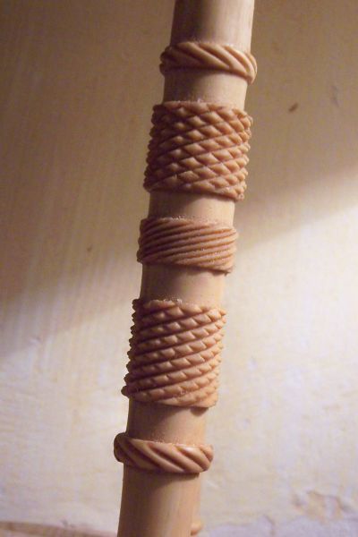

I always liked the cross hatched pattern over the spiral. That is the one that will get a lot of attention and questions how it is done.
Yes, a lovely pattern isn't it:

Love the crosshatch look.
I was wondering if you used either of those methods. Great job again. Thanks for sharing. I am looking forward to your future posts.

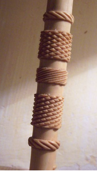

Hi Don,.......enjoying my new (used) Pen Wizard immenisely. Still searching around for more stuff to do on the old Forum and ran across the attached picture you posted years ago. Great idea and wondered how it worked out. Do you have any final pen pictures using these add ons made on the Pen Wizard? Would love to see them if you do.....very clever and a great idea. Thanks
You do know that was not Don's photo right? The cross hatching and rope or spiral design was done by a fellow here that made many kitless pens and was using a simple Sorby spiral cutting tool. Pierre. Go back and search some of his posts here and he shows various methods and pen styles he has done. There has been alot of talent that has gone through this forum over the years.
Thanks for the heads up.......I'll go back and check Pierre. I do recall Don Ward has mentioned hime and the both teamed up to post an article that's in the IAP library now.
Correct. Not my pictures. I may have mentioned about using my PW for kitless pens to Pierre but never followed through. Pierre used the Sorby Spiraling Tool. He is quite the craftsman.
My hat is off to Pierre for such outstanding and professional work. I've witnessed many a professional woodturner that uses the Sorby texturing (spiraling) tools but no where near the quality work that Pierre has exhibted in the photo above. Just truely amazing talent.
