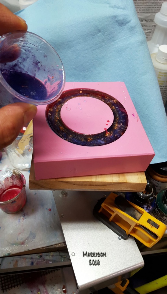

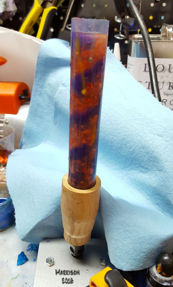

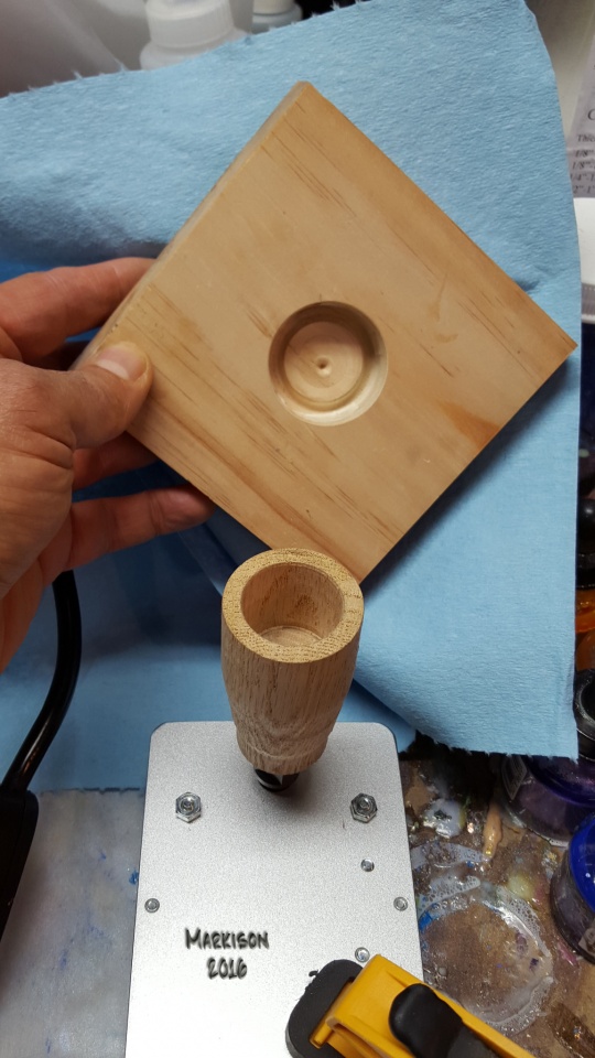

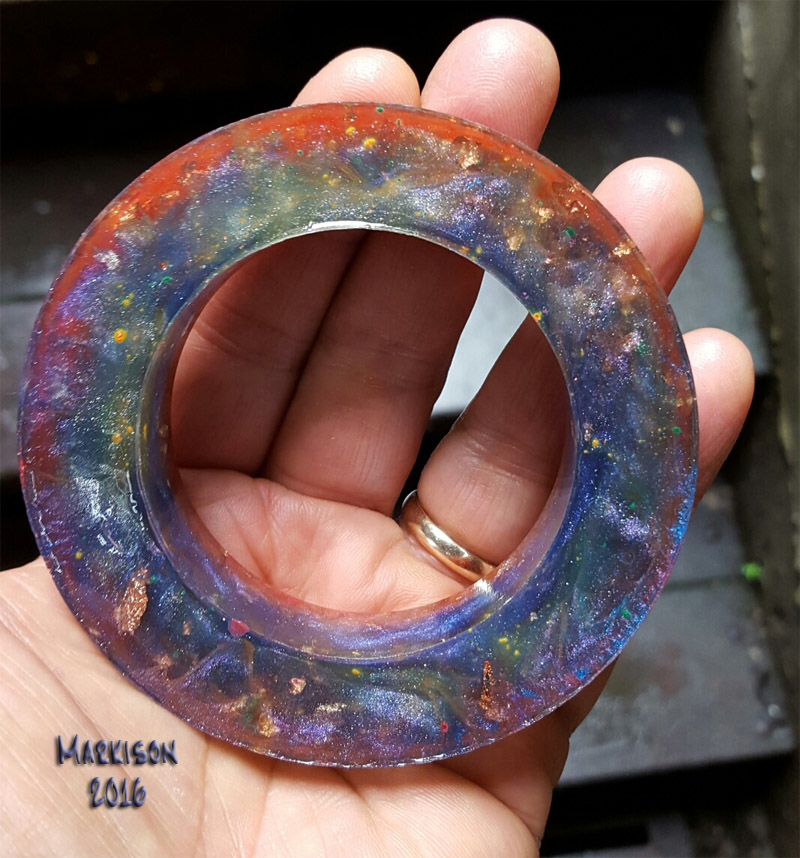

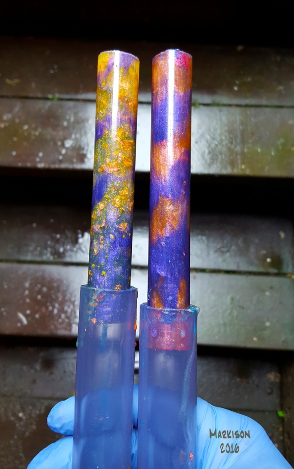

I'm enjoying my clear PVC pipe casting, but wanted to add controlled color spiraling throughout the blank - so I got a PennState blank drying system; clamped the (nice and slow 3rpm) motor to my bench with shaft facing upright upwards; drilled/tapped/turned a PVC pipe mold holder on the lathe, and screwed it onto the shaft; then lathe-bored the bottom of a wood square to serve as a platform for bangle mold rotation; poured a couple of color mixes into the slowly rotating mold; and to my surprise and pleasure, the simple system works, and the motor turns bi-directionally - stop it for a moment, and it turns the opposite direction for more possibilities; too much fun not to share; pix:
attachment.php
attachment.php
attachment.php
attachment.php
attachment.php
- Bob

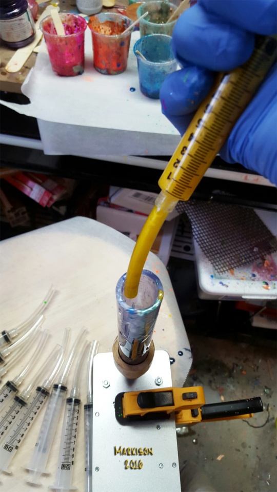

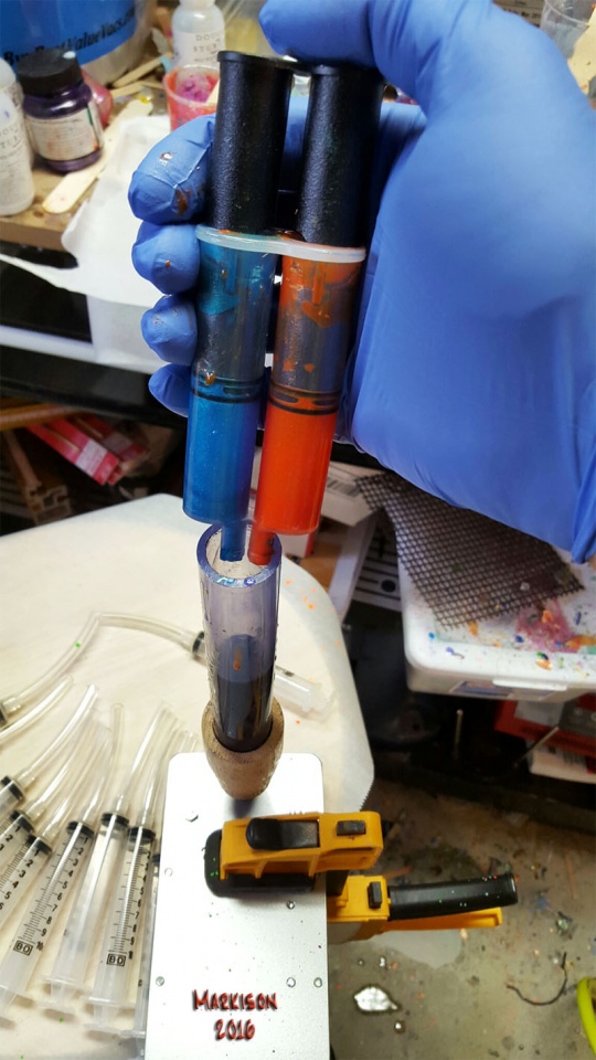

Today's refinements - single (10cc + aquarium tubing) syringe and/or double
(25ml Empty Double-Barrel Cartridge/Syringe with Plunger (1:1 mix ratio) - AmLee Epoxy Supply) syringe in hopes of spiraling into tighter control:
attachment.php
attachment.php
