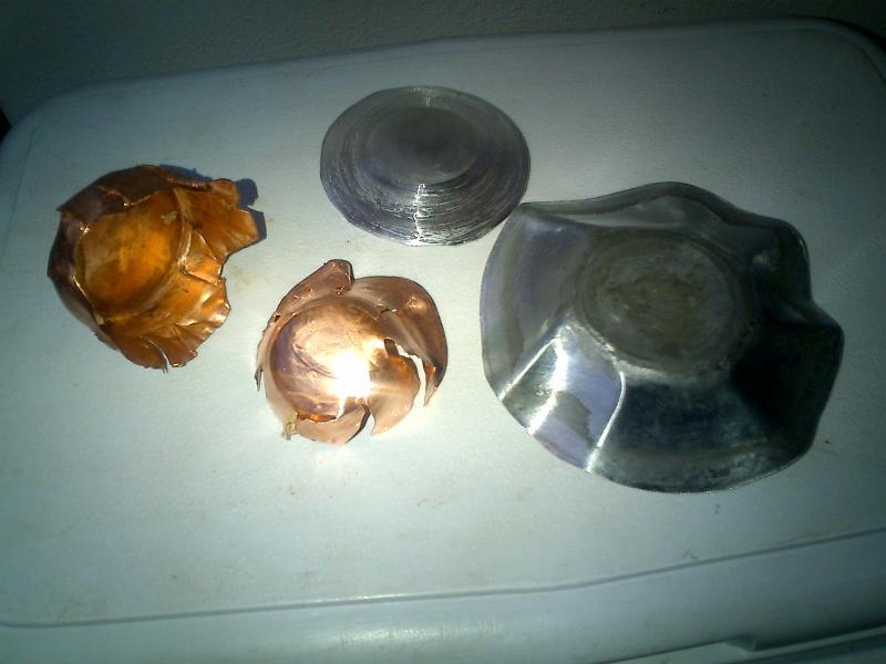

Well I just got back from my brother-in-law where I picked up a piece of good stainless steel rod (16mm) to make myself a 'spoon' before trying to spin some galvanized plate and brass... Sad to say... the copper I had, didn't quite make it...

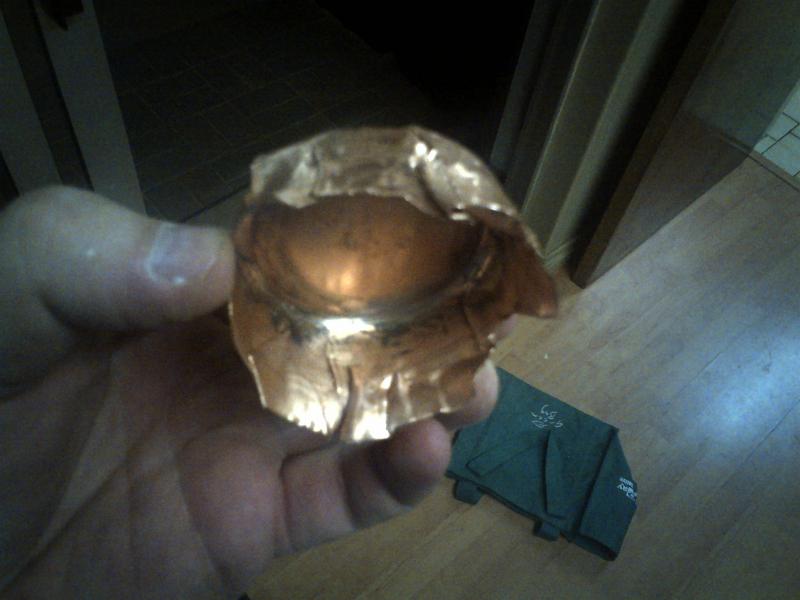

OK - I don't think my spoon is smooth enough yet. I have a 750W lathe - that's 1 horsepower and I still force it to a standstill... Wondering if the label is really correct... Trying to post pics...
I'll polish the tool and try to anneal the material first before I give it another bash this afternoon.

Okay... had the first piece of metal come flying out and luckily it had missed me and the missus' car behind me... At least one can see ahead of time that things are going pear-shape in the wrong direction. I just got out of the way and didn't even think about the stop button on the other side of that whirling piece of metal...

4. Any metal can be spun with enough force - but it can tear and split too! Get draw grade metal or anneal the pieces you want to spin first! Maybe I started with too thick a gauge - close to a millimeter - will pick up a sheet of 0.5 mm grade 1050 Aluminium today and try again
