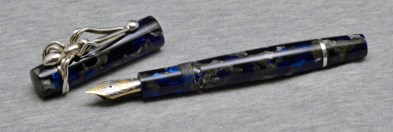

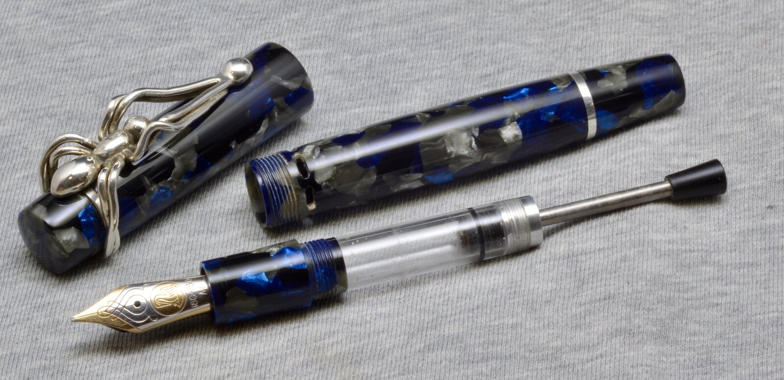

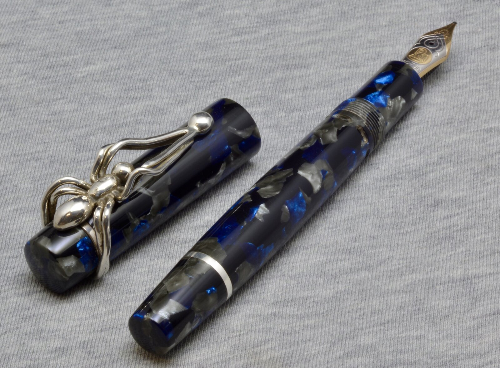

Here is a pen I finished this weekend. I made it from vintage acetate, transparent acrylic, titanium, and argentium silver. I built the pen around a Pelikan 800 nib, and due to its incompatibility with converters, I made an integrated syringe fill mechanism. The barrel has 6 small slots cut in it to allow you to monitor the ink level. I made the spider clip from argentium silver. The pen has a diameter of about 1/2" at the cap threads, which are triple start, and an overall length of 5" when capped.
I like everything about it - color, shape, spider. Now if only they made that material with red bits to give it a Spider-Man look.

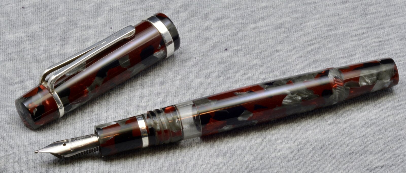

Thanks! My gf said the same. If I had been thinking ahead, I would have used this material

WOW !!!
That pen is so B*E*A*U*T*I*F*U*L !!!!!
I love the spider clip and I love the vintage acetate !!!!
Congratulations, John !!!!
Really admire the craftsmanship in that pen.
I am a little concerned the 6 slots don't weaken it too much near the nib? I had assumed lengthwise small slots not diametrical until checked the photos but incredible work.! Wife would hate it though due to the clip sadly.
