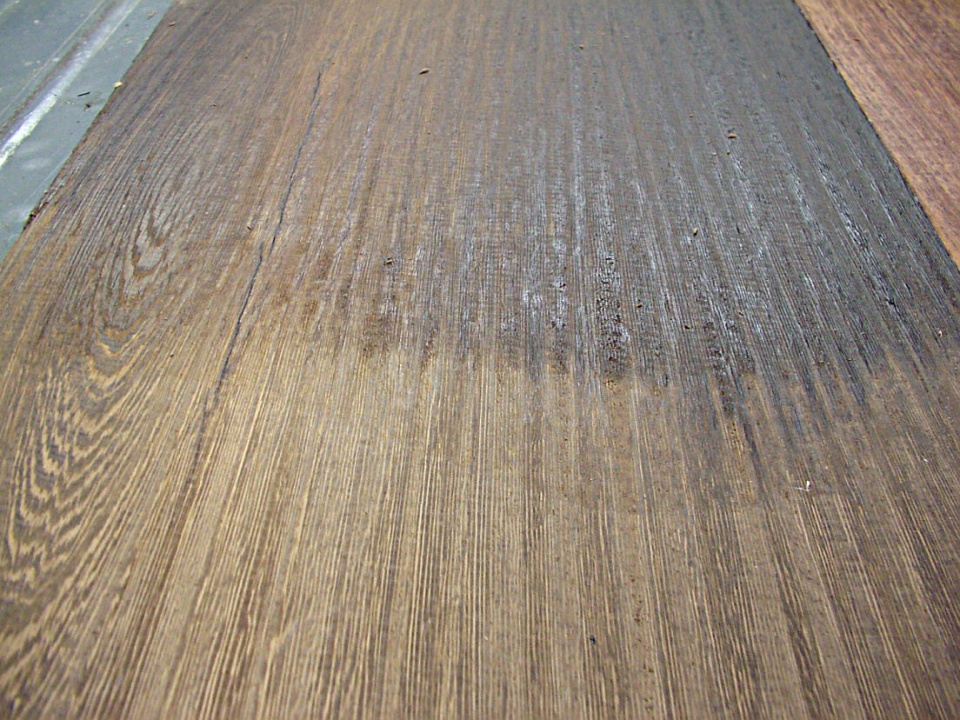

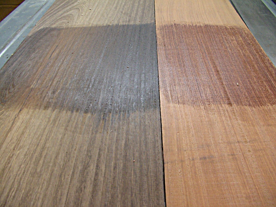

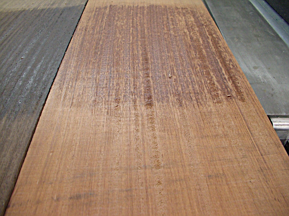

Hello again Bill
I will try to help you but you are the one that needs to experiment. Whenever working with woods you are not familiar with it is always best to try different finishes on scraps of the same wood. But what I mean by that is you need to prep the wood the exact way you would if it were the final piece.This means sanding the scrap wood, adding shellac, tinting with stains and so on. So that when a finish is applied no surprises will crop up.
Now the wood you are working with is hard to tell what it is. Many people come here and show small pieces of wood and want us to miraculously tell them what the wood is. There are various wood Data bases on the net that give fairly accurate photos of many woods from around the world. With that said though not all boards are alike. Can be same species but look totally different. Try to work with woods you know at all times.
Now you mention Bubinga and Wenge. Both these woods are highly splinter oriented and if you get a splinter working with them, get it out right away. It will get infected quickly. They are also woods that the dust can be a hazard so be warned. I posted a few photos of boards of each. The one on the right is bubinga and it is more reddish in color and streaks of lighter grains. The one on the left is Wenge and it is darker with more pronounced light streaks of grain. These are not sap wood. I also included a quick shot of each board with some denatured alcohol on it to resemble a finish somewhat. I did not want to contaminate these boards because they are not cheap and I use them for other projects, but you get the jist of the look.
Now to your question and my suggestion and it is only this man's opinion and I have to say that because one reason I do not come here much any more is because I have had confrontation with people here about what I say.
Whatever wood you have is an oily wood as I told you this before. When you get project to finished stage you need to wipe it down with acetone before doing anything and that includes using an oil stain as you did. Wait for it to dry which is about half hour. Stain if you want. Now you have introduced oils back into the wood unless you are using a waterbased stain. No matter. Need to let this dry and cure which is 24 to 48 hours in a warm and dry environment. No nuking or ovens!!!!! Now you need to decide the top coat. CA, Poly, or Lacquer. I will tell you this I have used Danish oil on this wood and polished to a soft sheen. Always looks good and feels good. Again though the pores of the wood are not filled so you will see this and feel it. Now if you are going to put poly on top which you did I suggest you apply a coat of dewaxed shellac under it. This will separate any oils from contaminating the finish. I like Bullseye dewaxed shellac. Can get in wipe on or spray. I like spray because it will not leave streaks like a wipe on can. Then after you followed on the can instructions for drying and curing, proceed with your poly. I never like poly, much prefer lacquers. But this depends on the use so I will leave that to you. Again let dry and cure before use. As always make sure your materials are fresh and stored properly. Also remember safety when it comes to oil and rags. They can combust so beware. Good luck and hope something in here helps.
