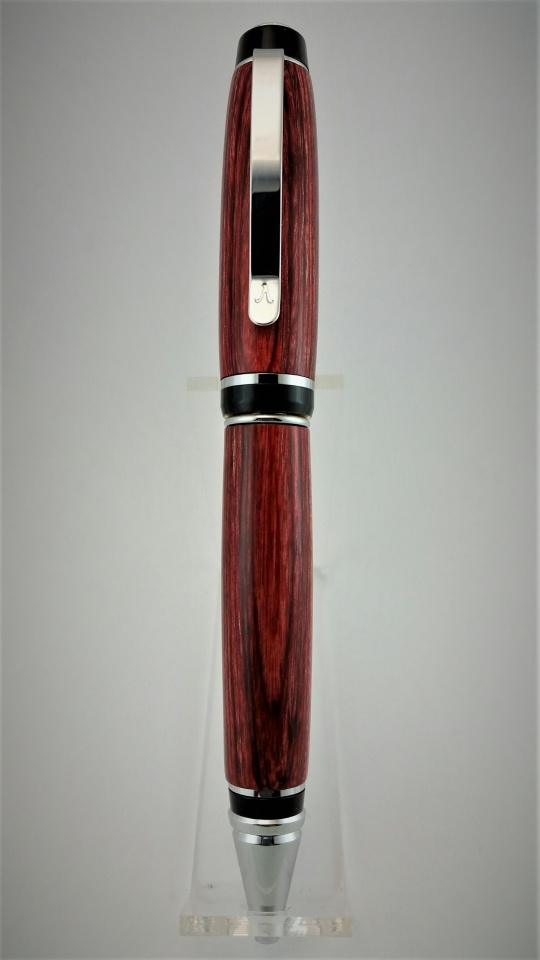

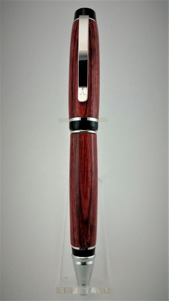

Mine is soft, but all turned with HSS..I can't see carbide being a problem. It is something that i finish with CA even though it is a laminate. LarryC's Dymondwood is a solid as a rock. In fact, my pen plus finish looks more like CA on. here is a pic. The Dymonwood is more two-tone too - unlike the spectraply, which is what make the spectraply interesting.
