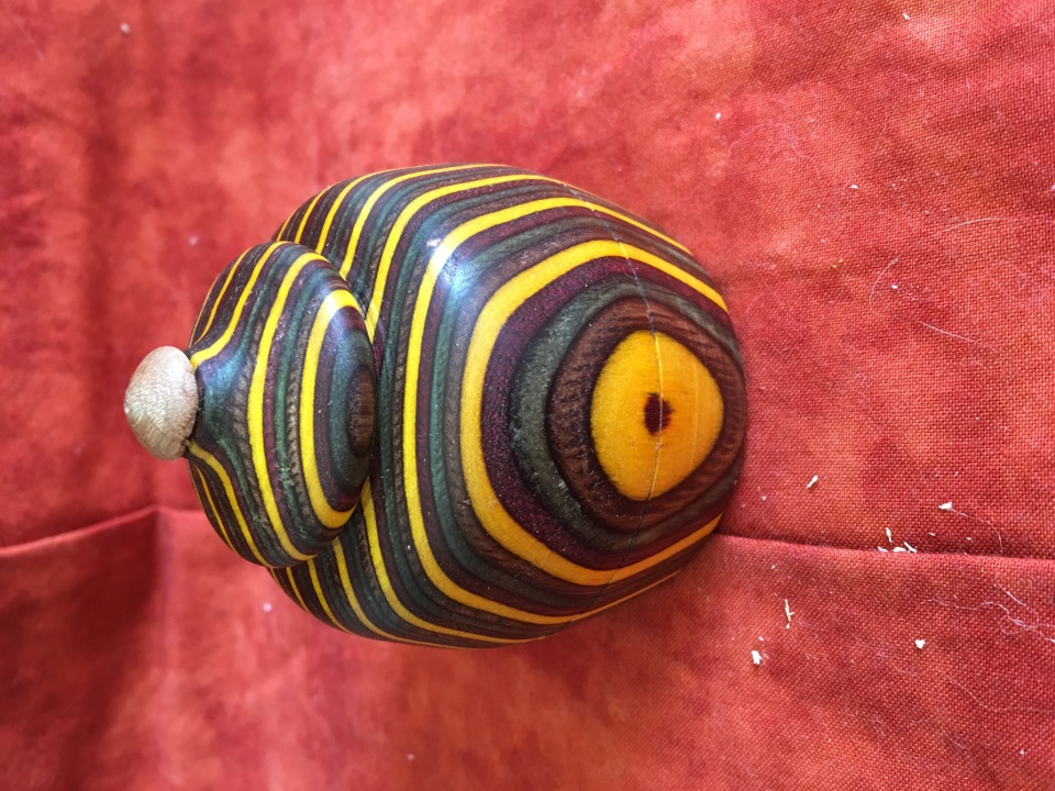

For this small box, I used two coats of a version of shine juice (1/3 DNA, 1/3 BLO, 1/3 Shellac) a friend had and then finished it with two coats of Johnson's Paste Wax.
(Apologies for the sideways view :mad:)

Very nice John. It is amazing what that wood can do to a project. It gives it that special look that a straight grained piece of timber just does not. Thanks for showing.
