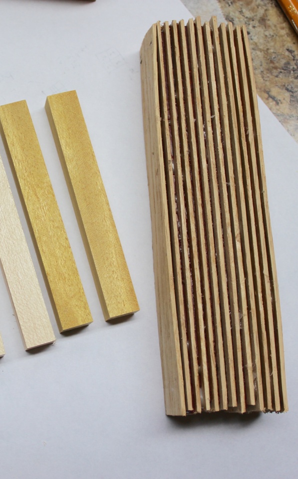

You can purchase a wide variety of 1/6" x 3" x 12" lengths of many species (as well as other dimensions as needed) from:
Mahogany Lumber Packs and Boards, D and D Woodcrafts
If, you wish to make your own blocks, a 1" x 1" x 6" block (with a variety of woods) will cost you $5.00-$6.00 with some S/H. A 1/16" x 3" x 12" length will give you 6 strips, so a 1" x 1" x 6" block/blank will need 16 strips.
A 1 1/2" x 1 1/2" x 6" block/blank would cost about $7.00 - $8.00.
These estimates will go up if you pick some exotics.
You will have to do the glue-ups, but if there is any cost savings to doing it yourself, you can choose your own colors, and cut then as you wish.
FWIW: The quality is excellent in my opinion. I'm sure there are other internet sources also. I usually finish-mill my strips, but these are very good right from the box.
Not sure if this is helpful.
