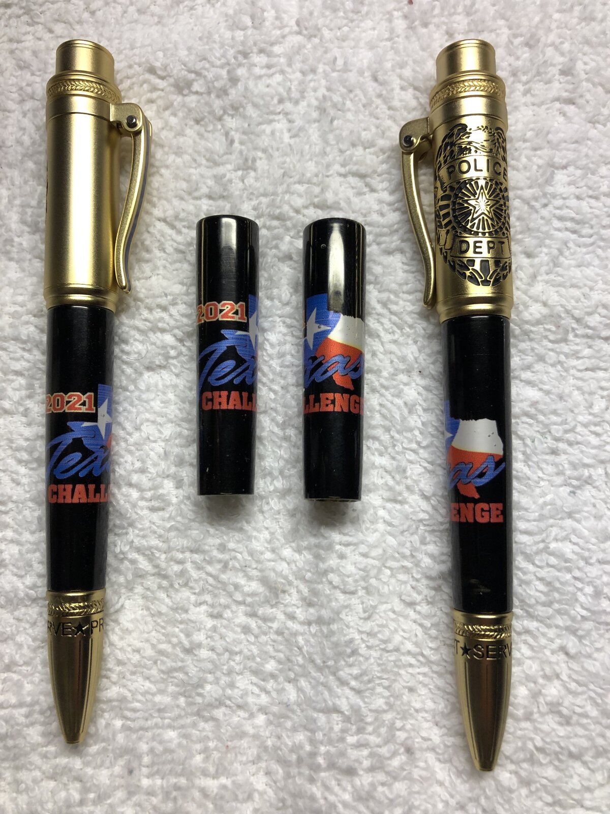

A few weeks ago I asked for help/suggestions for the problems I was having trying to do a decal casting. After watching Mark Dreyer's label casting video at the MPG and talking with him about the clear labels he used I was finally able to get good results.
Here are the custom pens I made using his suggestions.

I first tried making the blank using some white decal sheets I've had for about 2 years but could not get good results, the printer ink would not hold on the decal paper even after coating with clear spray enamel that I'd had success with previously. Mark's video using the clear waterproof labels was a great help. Still had problems with my printer in that the ink would not cover the individual image consistently. Was only able to use about 2/3s of the images printed on the sheet.

Clear labels? Are you talking about waterslide decals?
