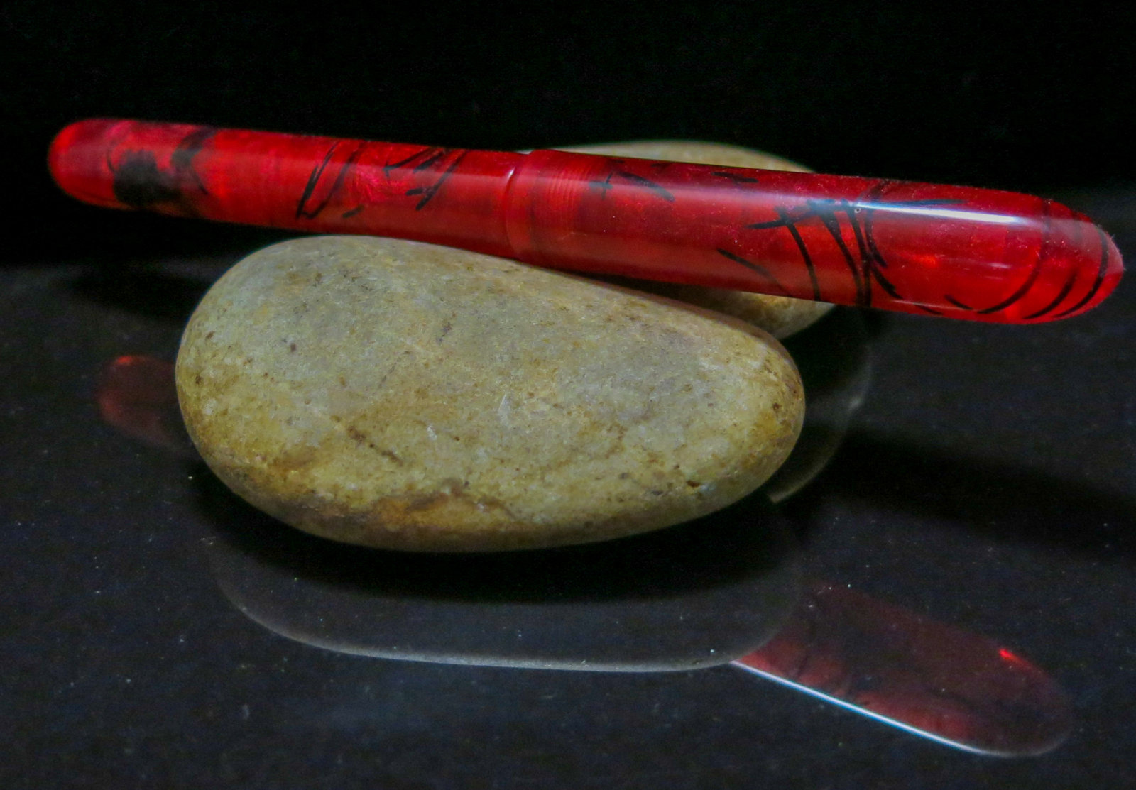

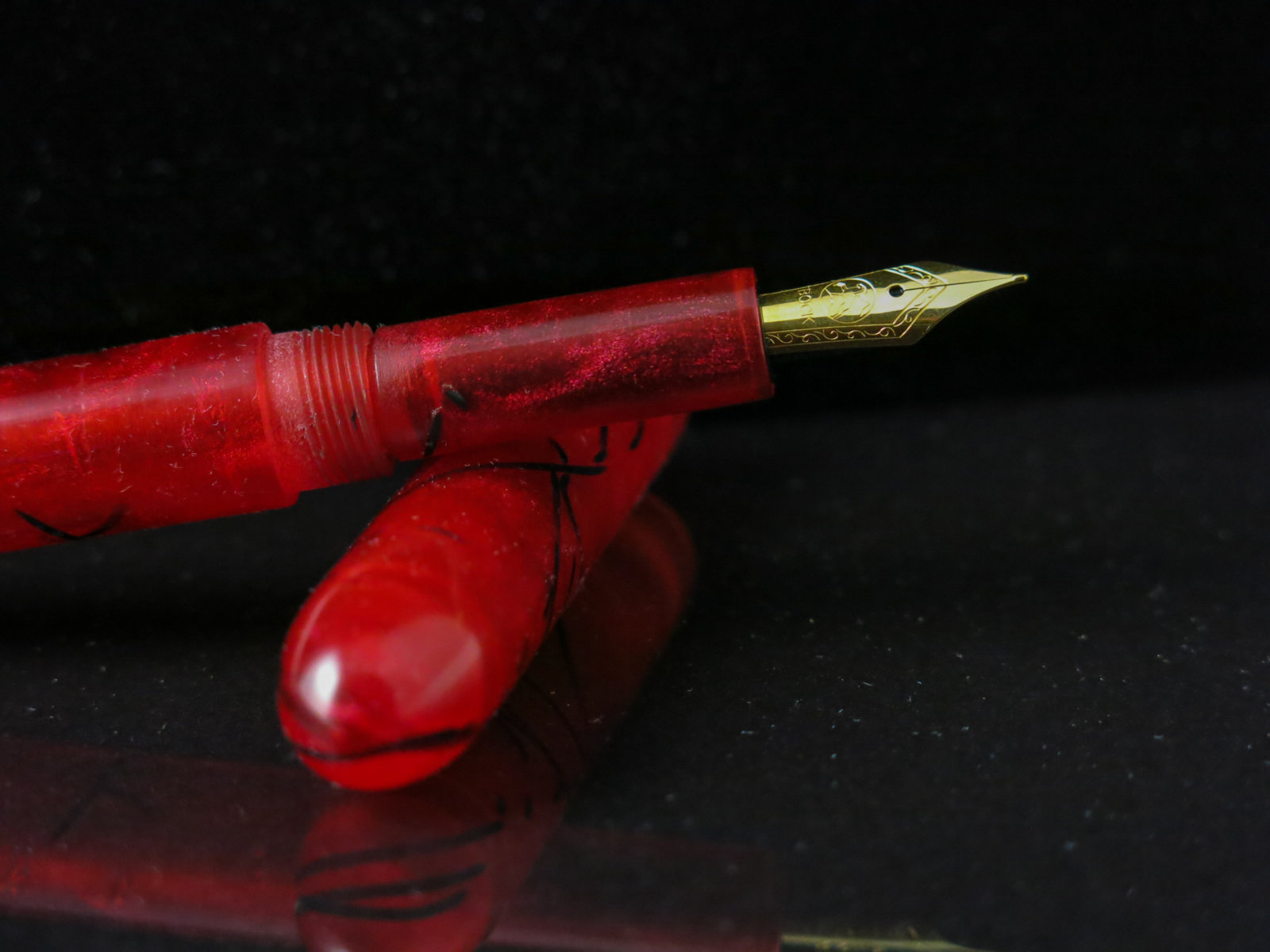

My son liked some of the alumilite blank experiments I've done and put in a special order for a fountain pen in red alumilite with random internal black threads. Here it is, still needing a bit more polishing but almost complete.

Thanks for the compliment. The blank was made from alumilite that I added red dye to and mixed with black plastic thread waste from my 3d printer. I have another similar blank but it is blue with multicolored threads (which I like more than the red one), should be able to post a pic soon but I'm still working on that pen.
I used a Bock nib/feed which requires internal threading of the section with a 6.5 x 0.6 tap (I think). The external threads on the section are done with a 9 mm x 1 mm die, and therefore the internal barrel threads for the section are done with the complimentary tap. I used a 12 x .8 triple start threaded tap and die for the barrel / cap threading. The Bock tap and the triple start tap and die set are from Turners Warehouse, and the 9 mm tap and die were from Victor Machinery. I haven't had much problem threading alumilite and ebonite, but you need to use care when threading the barrel because you've got internal and external threads adjacent to each other so wall thickness is a factor in whether you get a blowout or not (happened to me once so far). My major problem with the threading is making the threaded areas look nice. You can see on this pen that the barrel threaded area and the undercut next to the threads is not perfect, but I received advice on how to cut those threads and have them come out looking much better (basically the idea is to cut the tenon and polish it before threading).

That's a great looking blank, and the pen is looking good too. Good advice on polishing the tenons before cutting the threads, I read that in an old thread and have been doing it on all my pens since.
