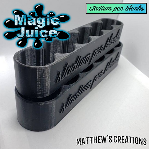

Get your Magic Juice holders HERE. These holders are perfect for the 1oz or 2 oz sets.
The Magic Juice Bottle Holder System features a six slot configuration to hold your 6-step polishing compound set.
The Magic Juice Bottle Holder System has two mounting options:
- There are two predrilled wholes for screw mounting.
- There are two pre-installed rare earth magnets to allow mounting to a metal surface.
