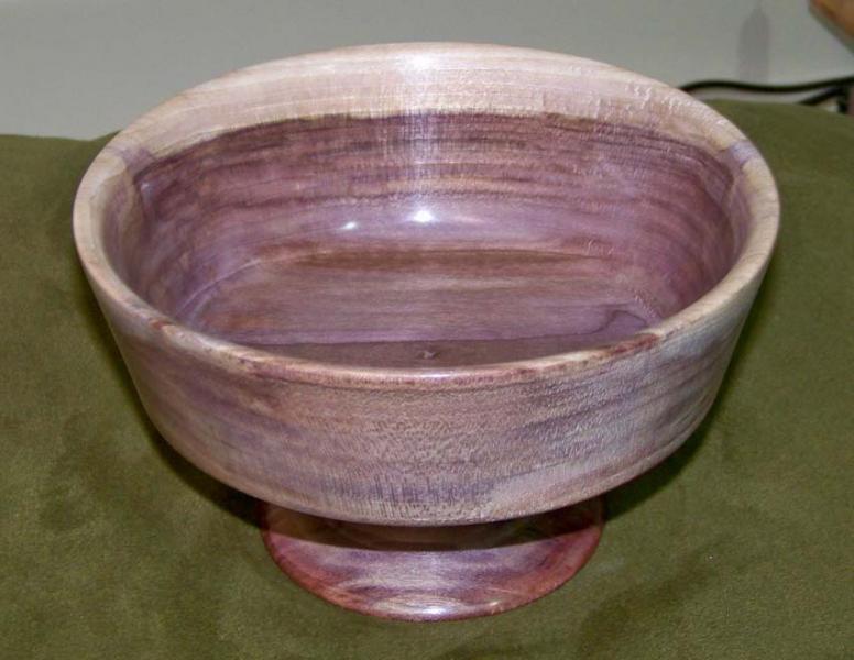

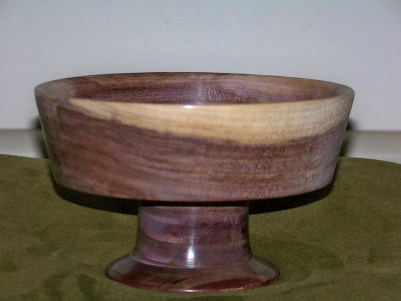

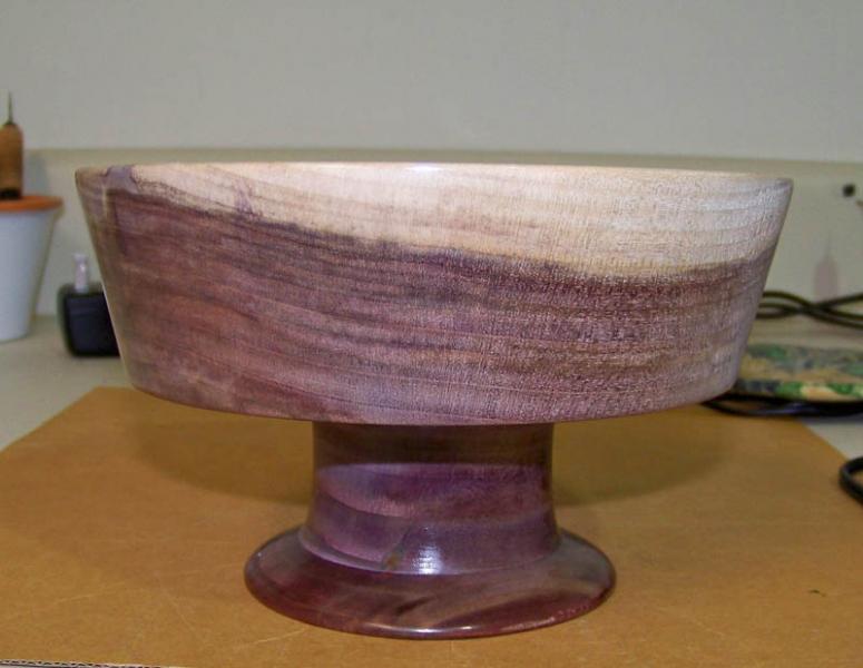

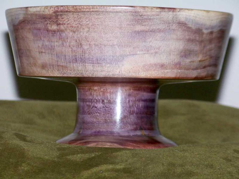

This was my first bowl turning experience. Started in my bowl turning class, but the blank was so wet I could barely rough out the shape. Unfortunately it still warped a small bit and I turned the base too small for what I was wanting, but overall I'm very happy with my result. I do welcome all comments and any advice. Thanks for looking :smile:

Jonathan ... Nice bowl all around.
The next time you turn a "wet" blank, shape it to about 3/4" of finished dimensions and then boil the bowl following Steven Russell's plan as can be read here: http://www.woodturningvideosplus.com/woodturning-education-articles.html. Read down the list of other interesting articles and go to Boiling Wood.
I turn several bowls from freshly cut trees and always use his plan. I have yet to experience any problems with using green woods. And, Yes, boiling does diminish the drying time of green woods. That seems to be one of the first questions folks always ask about the process.
Have fun! :biggrin:
