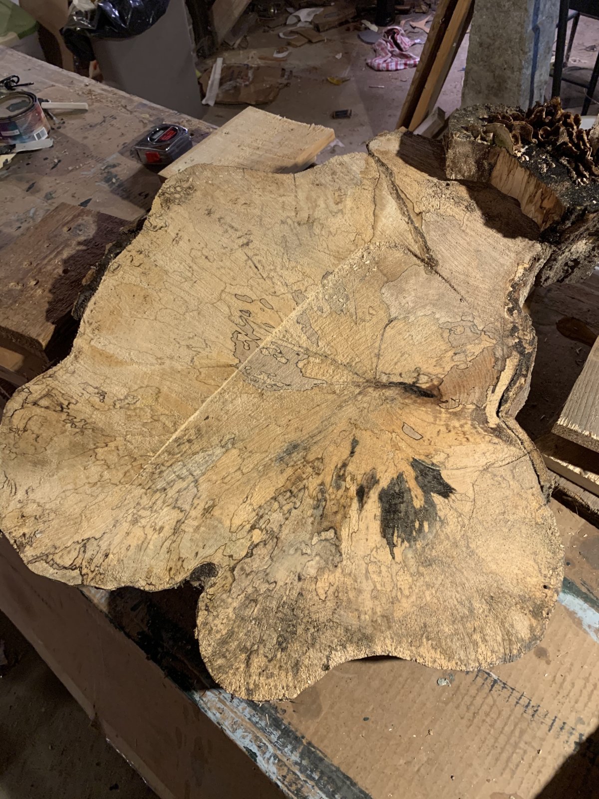

What should I do with this crazy slice of spalted maple? It was cut today. I imagine I should treat it soon so that it doesn't crack. Note that I will soon have a lot more wood from this tree.

Meanwhile, I've got the test slice. Probably the most intact bit I'll have from the tree, other than the stump that I haven't ground up yet.

What should you do with it ?
Well .... make pens out of it, of course !! . Don't understand why you even asked !!
I assume the slice is thick enough for that, allowing the grain to run the length of the barrel. . Not a fan of cross-cut spalted pen blanks.
I'm planning to make pens out of the lumber that comes from it. There should be enough other wood to make a few million pens.... I'll probably do about five, from it.
This section is only around 3 inches thick; a little shy for most kits, and again, there will be better options for pens. So, I wonder if there is some other thing that could be done with it.

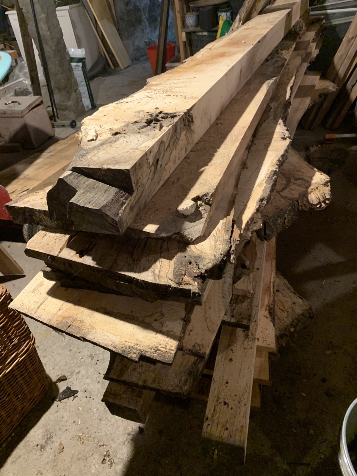

Yikes, he delivered the milled lumber. This is gonna be a lot of pens.... About 200 linear feet of various thicknesses, from around 1/2 inch to 4 inches thick, and up to maybe 16 to 18 inches wide???

It depends on how "good or bad" the spalted wood is. It can be spalted and soft, which would go for stabilization (with cactus juice and such), which would give you call and pen blanks. If the wood is spalted but solid then there are a lot more additional possibilities, from turning blanks (bowl, plater, peppermill,...) to lumber for furniture projects.
PS: fingernail test will somewhat give an estimate of whether it needs to be stabilized or not. If you can't leave a mark by pressing a fingernail in it then it probably doesn't need stabilization.

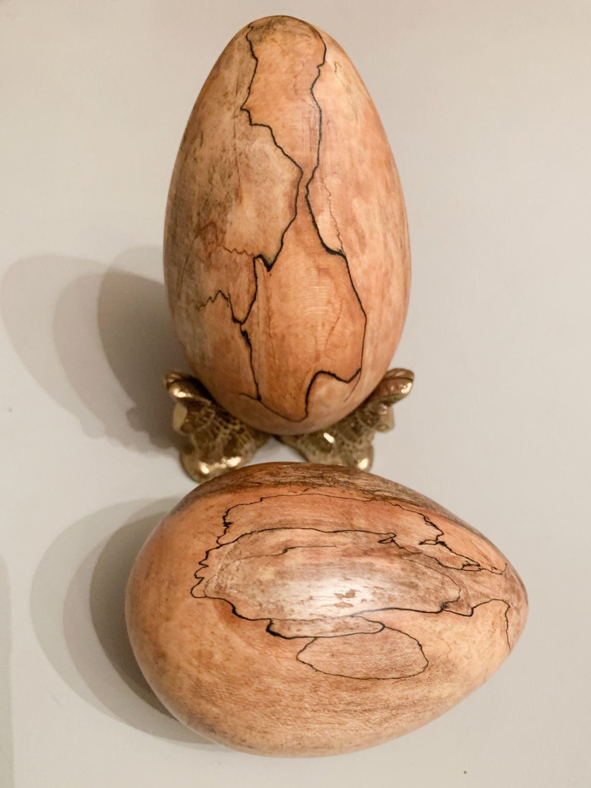

I'm busy sealing the ends with Anchorseal, a quart of which I accidentally knocked off my workbench and spilled all over the floor. Lots of ants and other creepy-crawlies living in this pile. But some gorgeous pieces of wood. Looking forward do diving in. Turned a couple eggs from some of the "throw-away" pieces, just for the fun of it. It will take me some time to figure out the right finish for this stuff. The one standing is tung oil (after removing a fiasco result with Penturners Plus) and the horizontal one is Old Masters tung/varnish combo. Might try just lacquer to see what happens.

I haven't tried to do eggs yet, I did do several of the egg-o-scopes some years ago, but they're done on a mandrel... do you use a jig or just go free hand on your eggs.... they are very well done.
Thanks, just freehand. The first few I did, I used calipers and a real egg as a model. The ends are the hard part. I like doing them because for some pieces of wood, there's not much else to be done with them. And you don't need to buy a kit.
Thanks, I may have to try a few... I have several boxes of cut offs from other projects that need something done with them... part of them will become bottle stoppers, but eggs should also do well at my market. Will be something different I haven't offered before.
There's something endearing about the eggs. I started making them for my chickens; the theory is that you put them where you want them to lay (i.e., in the nesting box, not on the ground), and they will lay there because they like communal nests. But my wife kept arguing that they were too good for the chickens, so I made enough for both, and then Facebook friends started asking about them. Personally, I prefer more practical things, but a lot of people really seem to like the eggs. I keep one my desk and find that I am constantly playing with it. I'd be interested to hear how they do for you commercially. I am way too slow to ever consider selling anything I make. I'd be a long way from making minimum wage....
