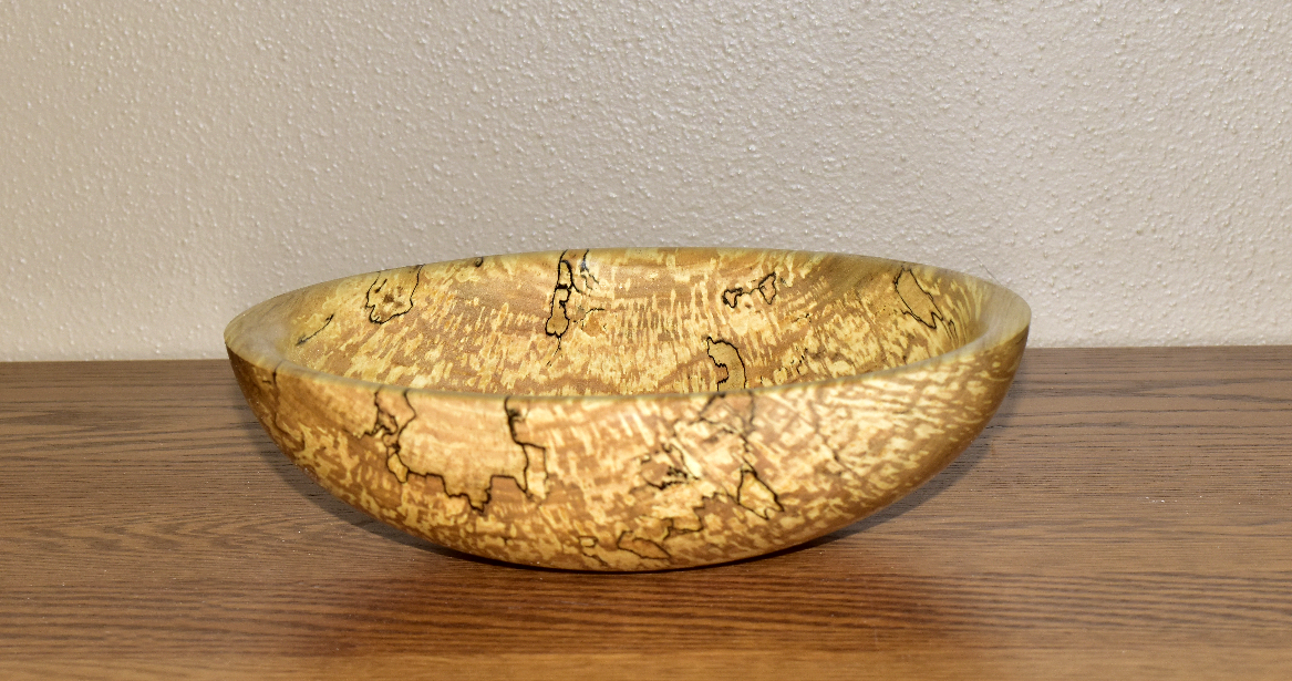

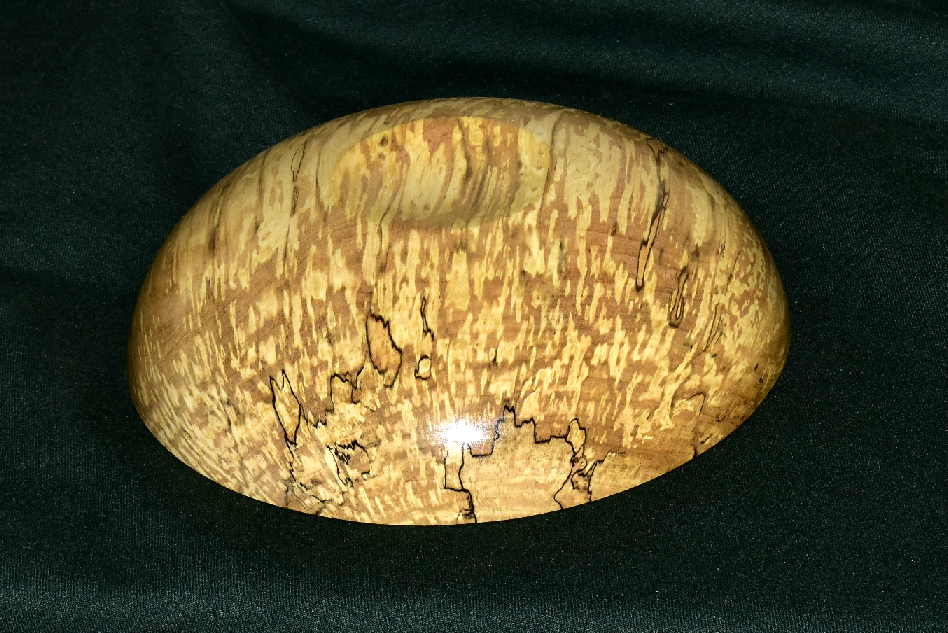

Spalted Maple 8 1/2" x 2 1/2"
Friction Finish (Shellac/BLO/DNA)

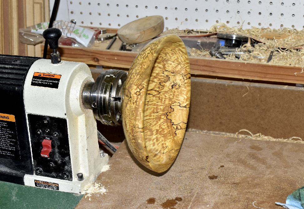

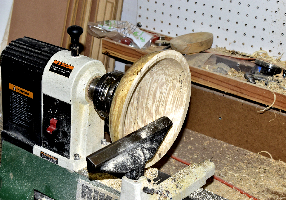

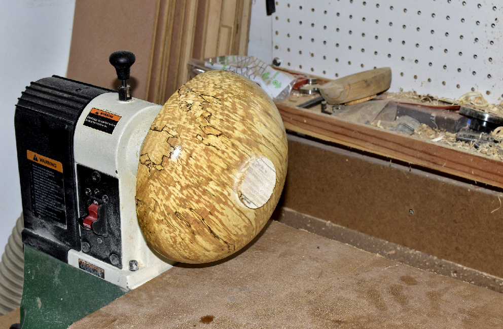

The last few weeks I've been roughing out a lot of these bowls. As I was roughing this one out it seemed to be dry enough.

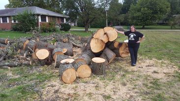

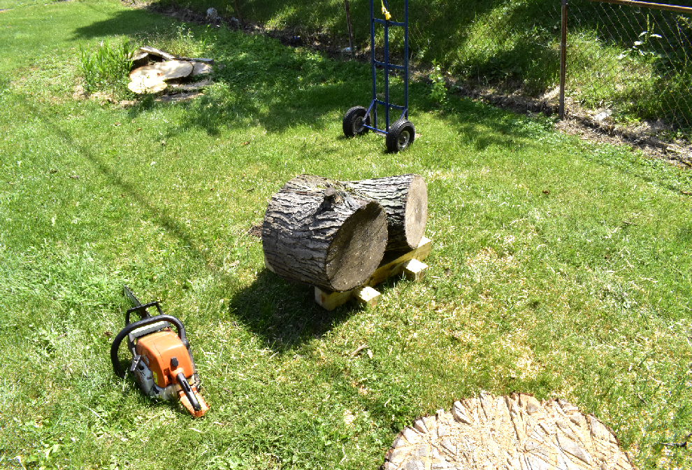

So I went ahead and finished it out completely. This is from the log in one of the pictures. Only cut it up 2 weeks ago.

Very nice indeed!! Reed Gray (Robo Hippy) turns almost all his bowls start to finish wet—and embraces whatever wood movement that follows. Being sparred a bit, you may not get a lot of movement from that one. I've got a 3+ day weekend coming up and a pile of maple logs cut in May—might be time to try a few wet bowls.
You've been an inspiration, thanks for sharing!!

Reed also is in hippy land... and the people who buy his bowls think they look "organic." So he can get away with that and sell them in the plenty. You do what works for your market. Most all these are going to be next years mother's day presents for the church I serve. The Maple came from a tree that has been on the church property. Mid-west conservatives don't seem to like "organic" looking bowls. ;)

I turn all my bowls to finish, but I don't have much fresh wood now... some of it's been stacked in the yard (under tarps) for a few years now . I did have some relatively fresh cut box elder a few years back that I could feel the water slinging out as I cut it... after shaping the bowl, I turned the lathe up to a higher speed, wiped down the inside with mineral spirits several times and let it soak through the wood and out through centrifugal force.. don't know if this was proper way to dry wood, but seemed to work.... the bowl didn't move or crack.
I later got an older microwave from the local Habitat store and used it now to dry woods... I'm too impatient to turn green, let sit, return to shape and finish... just me, probably not the proper way for a turner to operate.

That's one good looking bowl, Jon. I agree with your assesment of "organic" appearance in our part of the country. I twice turn pretty much all the bowls I do. The very few I don't get raised eyebrows at shows. :eek:
Nice work. (I'm jealous)
