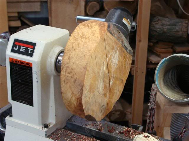

Put one piece on the lathe that looked like this. It was shallow on one side so I knew it was going to be a dish rather than a bowl.

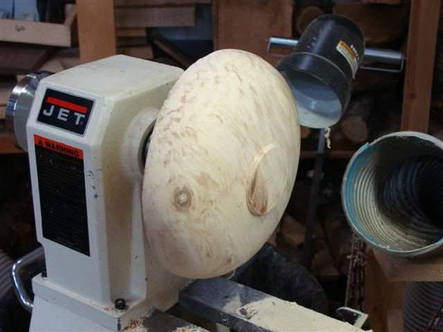

Turned the bottom and added a tenon

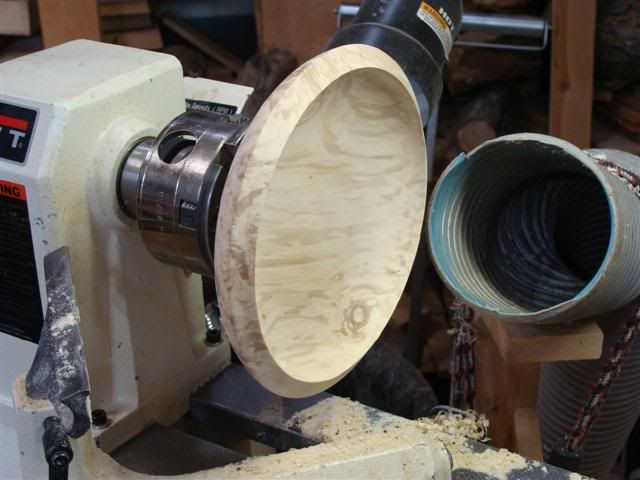

Reverse chucked and hollowed out inside and sanded to 600 grit.

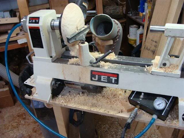

Put on vacuum chuck to turn the foot.

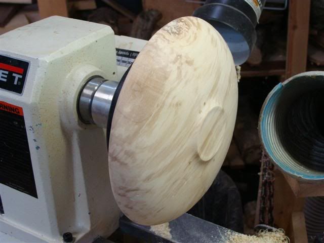

Foot turned and sanded bottom to 600 grit.

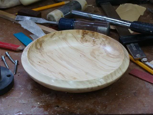

Went through tripoli, then white diamond and then wax and it came up with a sheen that not only looks pretty good but it feels like velvet to the touch.
The entire project took a little over an hour from start to finish.

I envy your your vacuum set up... need to get one of those some day...
Thanks.
That is a handy little vacuum chuck system. Can put it on or take it off in a couple minutes. I made several different size chucks for it after getting the initial one with it. .
If you are not aware of price etc here is one of the many places it can be purchased.
http://woodnwhimsies.com/turn.html
