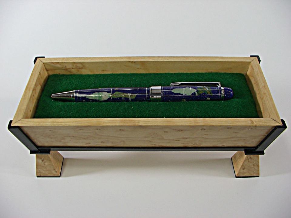

John that came out well. Have to agree with Pete I too believe any box with 45 degree mitered corners needs a little extra support. I have used all methods he mentions including the ryobi biscuit jointer. No matter how small the box I make that has 45 degree corners will get some sort of support. My pool table pen box has a hidden spline joint. Have made larger cabinet type boxes with celebrated splines of different woods. I use Titebond II wood glue.
