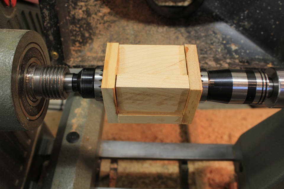

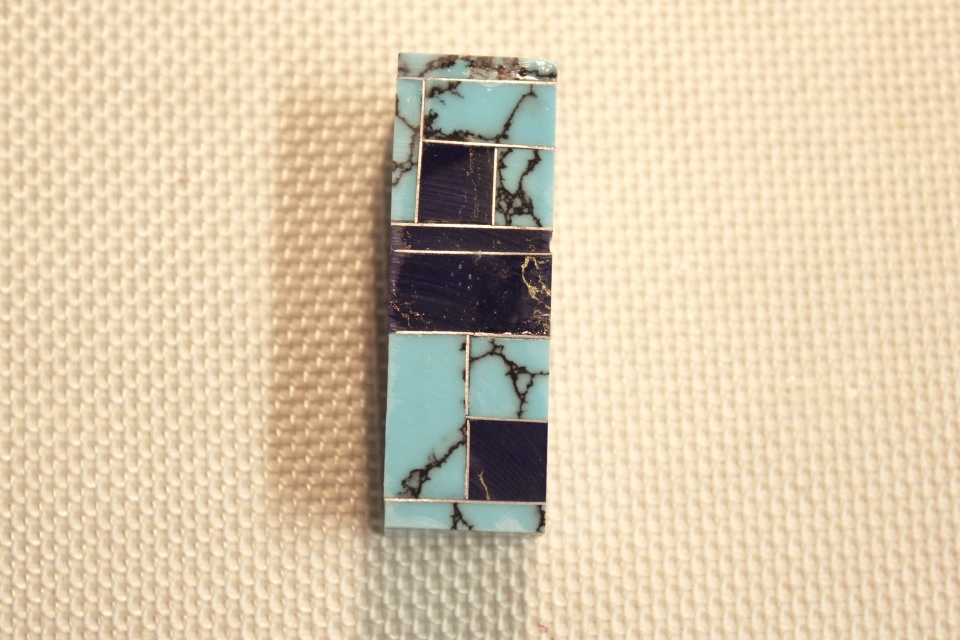

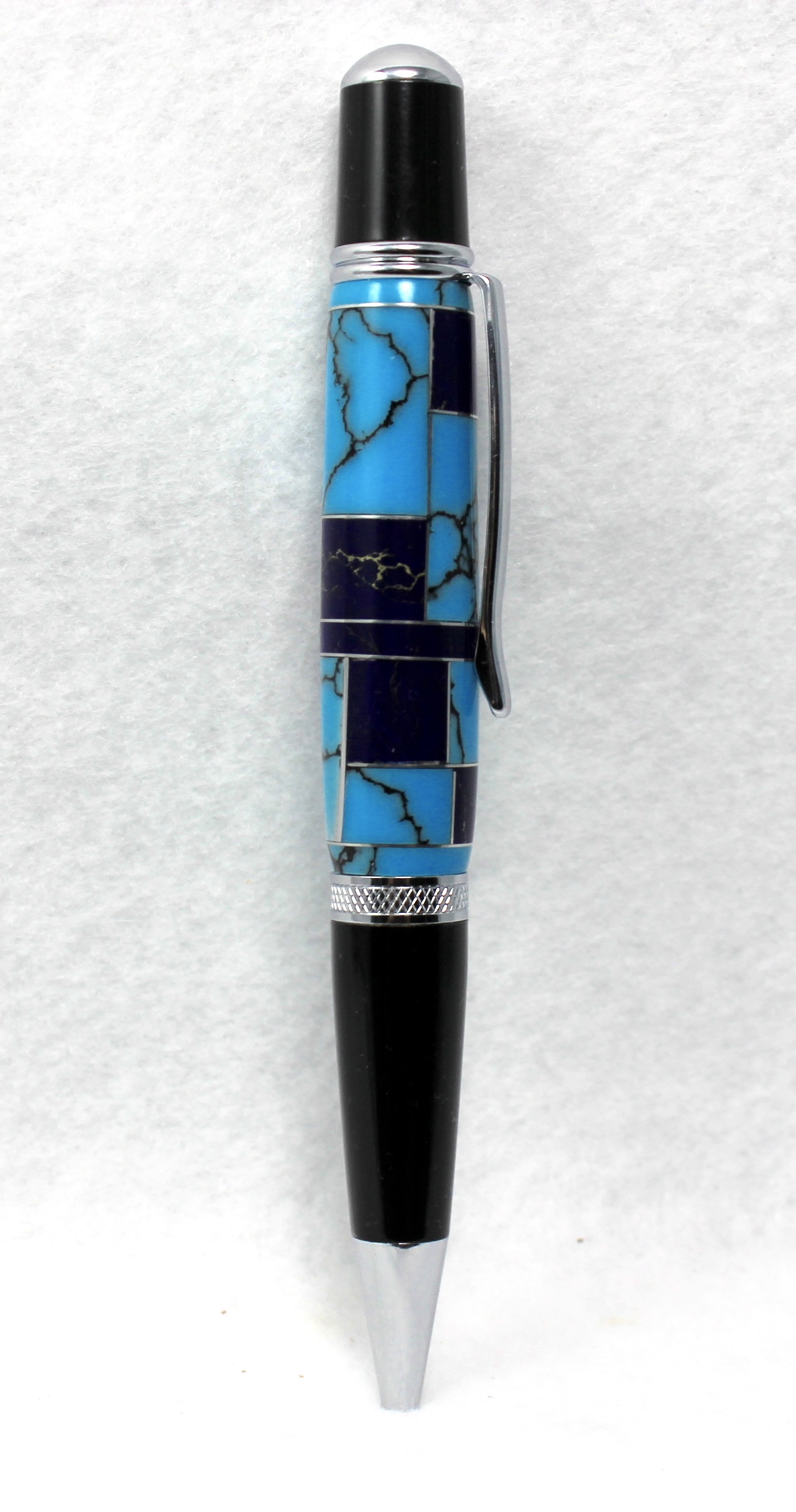

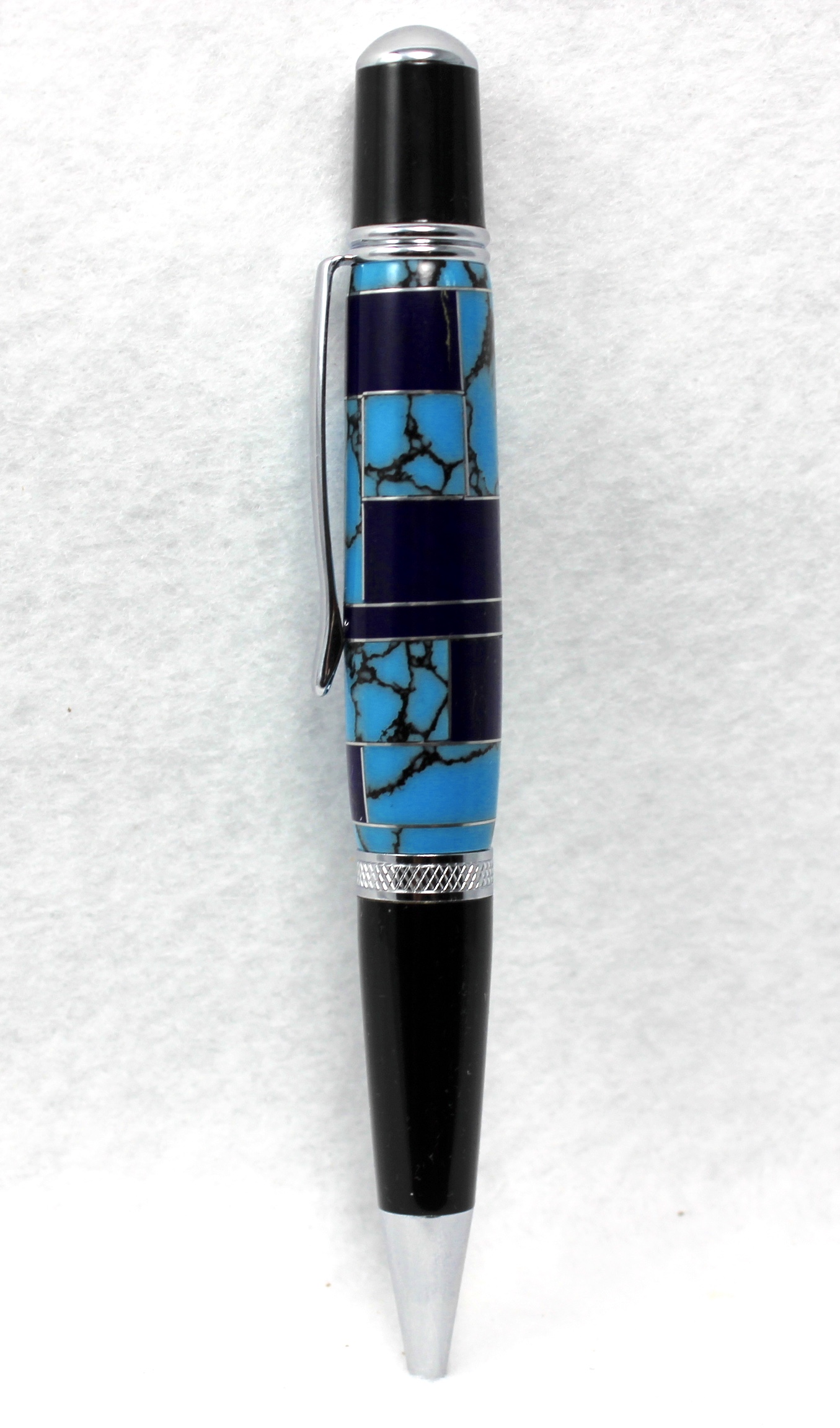

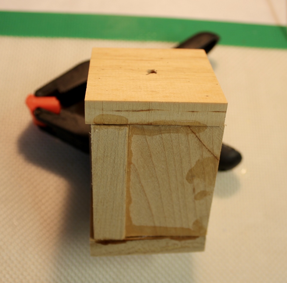

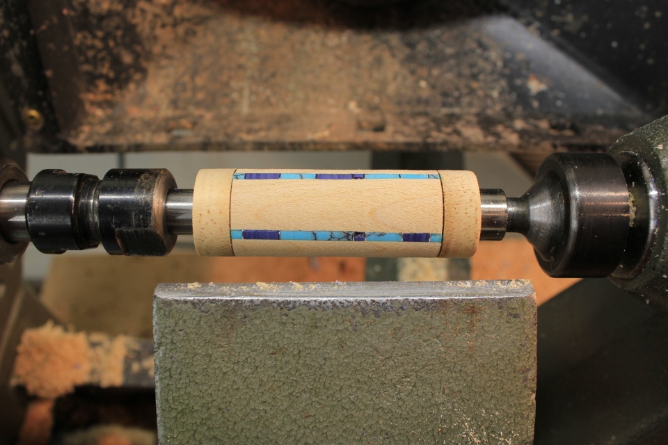

Introducing, "The Dud." I fully expected this to explode at numerous times during turning. But thankfully, the bomb squad outfit was not necessary (as typical, I did wear a full face shield).

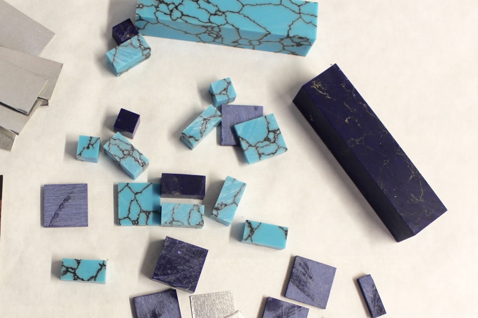

Two different Trustone blanks, aluminum sheeting, 2 part epoxy, cutting fluid for the drill, HSS roughing gouge/spindle gouge, Magic Skew Round Bit, wet sanded with Abranet then Micromesh, McGuires polish, Renaissance Wax, my lucky rabbit's foot.

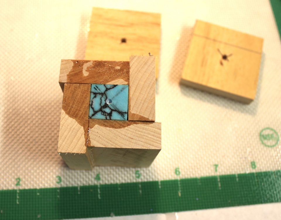

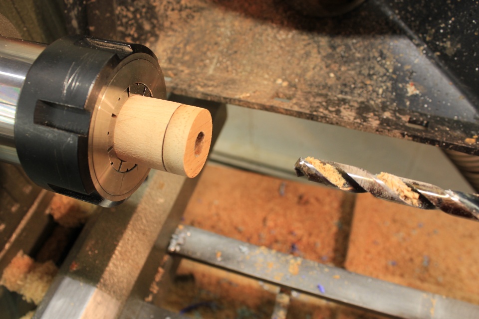

As explained in a different thread, after constructing the blank, I was very concerned about drilling through the aluminum sheeting parallel with the drill bit. The technique for encasing and drilling the blank is detailed here: Roy Quast's Technique.
Not well aligned, and one end is undercut, but for a first attempt, I'm OK with it. 95% of my experience turning/segmenting is with wood, so this had the potential for a few surprises.

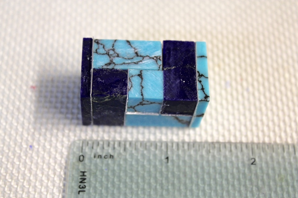

Nice start! The lapis is so much harder than the turquoise, must have been frustrating to turn. Isn't it amazing that what looks just right when square, looks so different round?
Mark,
I think that has been a very useful exercise, and thanks a lot for all the detailed pics.
For the small piece sizing, did you increment in multiples of 1/4", for example, in order to get the different sized pieces to all fit together ? . They don't look like random sizes.
I have turned several Trustone, and have about 7 blanks. I knew previously of their different "densities", but in all honesty I had forgotten :redface:. Until the wood was turned away, I was using my bowl gouge, then with the trustone and aluminum inserts I alternated between a small Sorby gouge (red mini handle) and the Magic Skew. I used very light cuts as I was more afraid of a blowout, and I believe that is why I didn't notice any difference in the Trustones.
Just looking at the glue-up blank I knew things were not aligned, but it ended up better than I anticipated.
Mark,
Yes, this was not intended to be a "refined" product. My objectives were 1) Assemble a segmented trustone blank with small aluminum inserts, 2) Try out Roy's block technique to drill the hole, and 3) See if I could turn it without picking aluminum and trustone out of my faceshield. I am still drawn to Frank Lloyd Wright stained glass designs, as well as the Southwestern Indian Blanket designs. So that is the main area of inspiration (but I'll also give a shout-out to Steve Johnson and Dale Parrott - beginning to feed off of each other and that is fun. No competition, no egos involved, just loving each others efforts - I admire both of their precision, certainly a notch above mine).
Piece sizing; yes, I cut a few thin slices for full squares - 1", some 1/4" x 1/2" in each color, some 1/4" x 1/4" squares, etc. I actually did cut and glue small aluminum 1/4" x 1/4" squares for some of the insides. No joint between the trustone did not have an aluminum spacer :eek:. Each piece of aluminum was sanded, flattened to eliminate burrs, and epoxied on the corresponding piece.
I had been contemplating this type of segmenting for over a year. With some family responsibilities going from 24/7 for weeks, now to crisis-Ok-crisis-OK, I am able to have more shop time. And, quite honestly I don't worry about the results, I just want to have fun and get some "shop therapy."
Note: Yes, a random pattern would also have been fun, but it would have resulted in a jagged blank that would have needed to be sanded to a uniform block to be able to build the supporting "Quast Coffin." (apologies to Roy)
