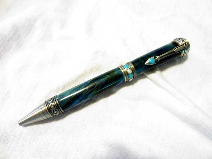

Here's a Southwest on Buckeye burl. I believe I got a little too aggressive trimming the ends. The pen won't actually come completely together in the center -- trimmed the top barrel a bit too short and the mechanism hits the cap before the top barrel fully seats. Here's a quick snapshot ... you can see the gap -- unacceptable!
Watch those dimensions. There's apparently not a whole lot of room for error.
I'm not looking at one right now, but is there any chance of grinding a small amount off the top of the twist mechanism?
Or the top of the band assembly? I don't have one if these. But looking at the parts diagram, wondering if the mechanism goes all the way to the end of that center band shaft. If not, and that's what is stopping the top section, maybe it could be trimmed.

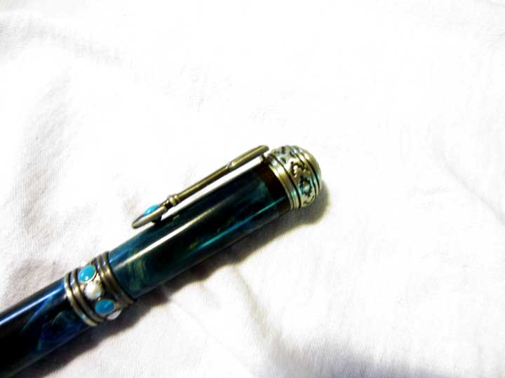

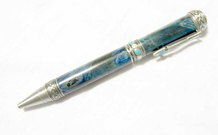

Well, here's the repair. I put just added a bit of Cocobolo from the scrap box to the top tube. Just disassembled, used a bit of CA to attach, remounted it on the mandrel/bushings and turned the new top band to size. The overall look is not objectionable - just a moment to be a bit creative.

Actually, I think the bottom tube got trimmed a little short too. When the pen retracts it just barely comes within the confines of the nib. It's inside OK, but not quite where I'd like it. When I made it I didn't think I took off much of the brass. A little smidge here and a little smidge there seems to make quite a difference on this one. Be careful with your dimensions.:smile:
I suppose that would be a possibility, but remembering to repeat that at refill replacement time would always be an issue. As it is it's actually OK, just a bit closer to the end of the nib than I'd have liked liked it to be. It extends properly and works OK, so ... next time.:redface:
