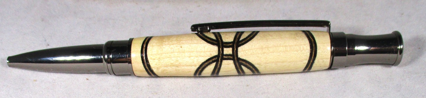

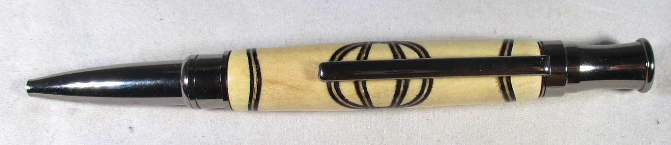

This is the result from playing around with a hole saw and a piece of maple. Etesia pen kit.
From what I can see I quite like that !!!! . . Nice idea and nice work !!
The thing is ...... could you make another exactly the same ?
And then ..... the bigger question ..... could you tell the rest of us how to do the same ?? . . 😁 :D:);)
Isn't it a lot of fun to experiment and come up with something really interesting like this . . . . . and rewarding also !
Good on ya' ! ! ! . . . . Thanks for showing us this, Alan !!
I actually like it BETTER THAN A CELTIC KNOT ! ! ! ! ! . . . . I hope you write a tutorial on how to do that lovely pattern . . . ! ! !
Wonderful play time! I do hope you continue. The basic design is very well formed, so minor modifications (e.g. timber colors for the veneers, thickneses, etc.) will make a huge variation. Well done Mate!
Looks like a winner to me Alan don't think I can think far enough out of the box to try and replicate this. Well done like it a lot I'll just look on in envy.
Looks like a simple and easy thing to do. The amazing part is that nobody has thought of it before. Good for you getting your mind further out of the box.
Simple is right, Peter. 4 cuts with a 25mm hole saw. Only tricky bit is centering the third and fourth cuts.

Please tell us more, Alan. . . You say " 4 cuts with a 25mm hole saw " ....
How are the centers arranged for those 4 cuts ?
If I were to answer my own question, I would say that two of the centers are on the centerline of the pen barrel.
The other two centers would be off to the side of the pen blank, and equally distant from the blank centerline.
I can see that the last two would be a bit tricky to do.
But I am not even sure if my idea is correct, so I would appreciate hearing from you, please, Alan.
I say that I am not sure about my idea because it may not give the same look as in your second picture at the beginning of this thread.

Photographs of the process posted, Mal.
Hope that they make things a bit clearer.
Alan
