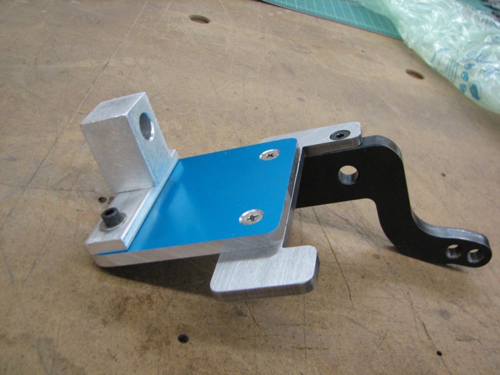

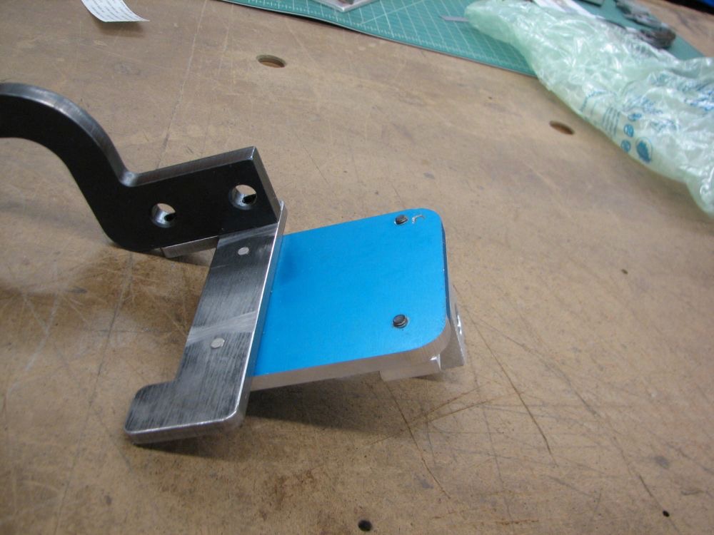

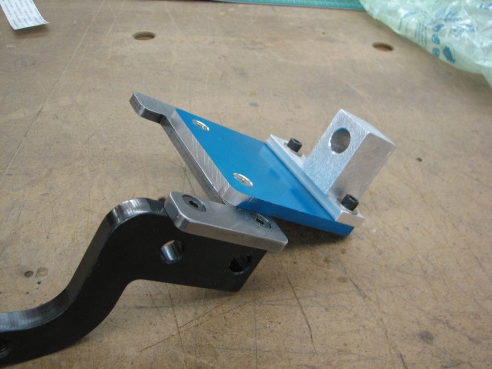

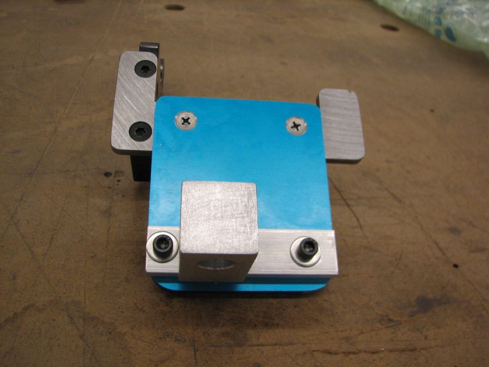

Problem is you need to square the blank to the brass tube. The blank can be perfectly square but that doesn't help you much if the hole you drilled isn't straight. Now if you could engineer a jig that references the tube, you might have a winner.
Sent from my iPad using Penturners.org mobile app
Exactly...Rick Herrell to the rescue. He fabricated a jig onto the small tool platform I purchased for this project. It uses transfer punches through the brass tube. Will post when received...it's in the mail. Rick is a genius. His work and how he deals. We're fortunate to have him on IAP. The offset portion is not shown. Will do so after receiving.
