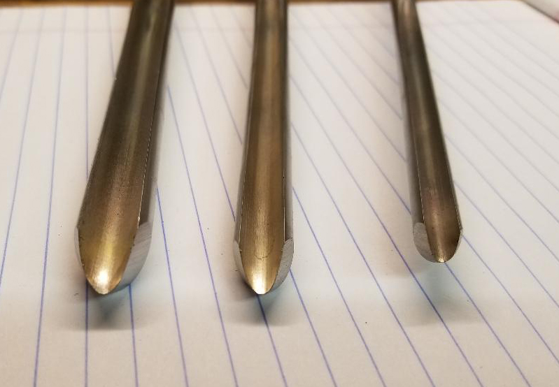

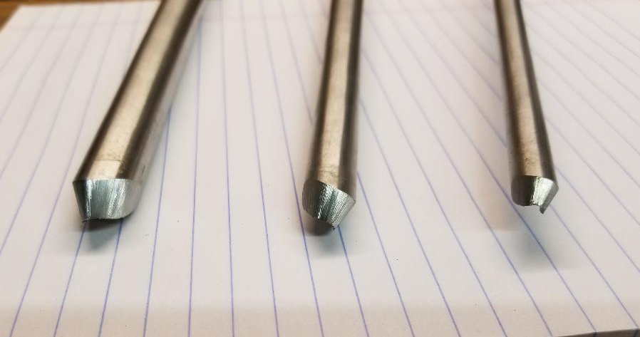

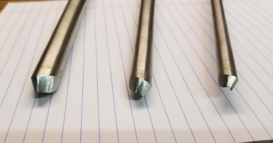

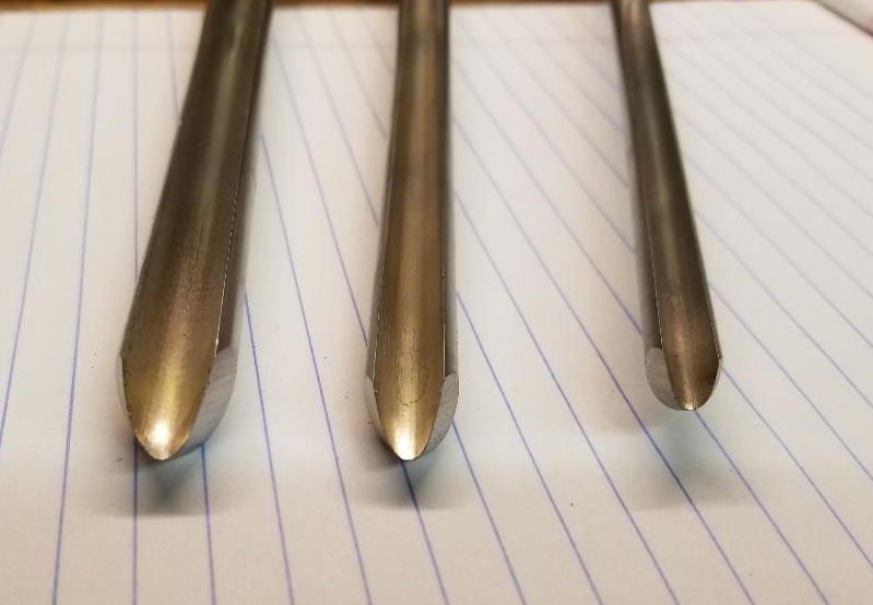

I have one also. I just couldn't get the hang of getting my edges like I wanted with grinder. I broke down and bought my sorby. Very pleased with it. It didn't take long to get the hang of it either. My computer is packed in storage but wish I could show the before and after pics. Big difference. I posted them here and/or the aawforum. I may try to find them and post them.
To add, I did find a couple pics. These gouges were sharpened with my sorby. I don't have before pics but trust me, they were sad looking. Lol
