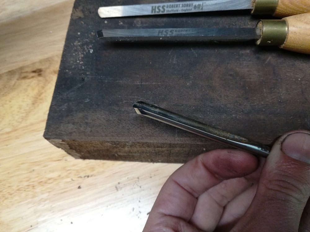

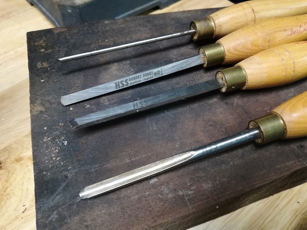

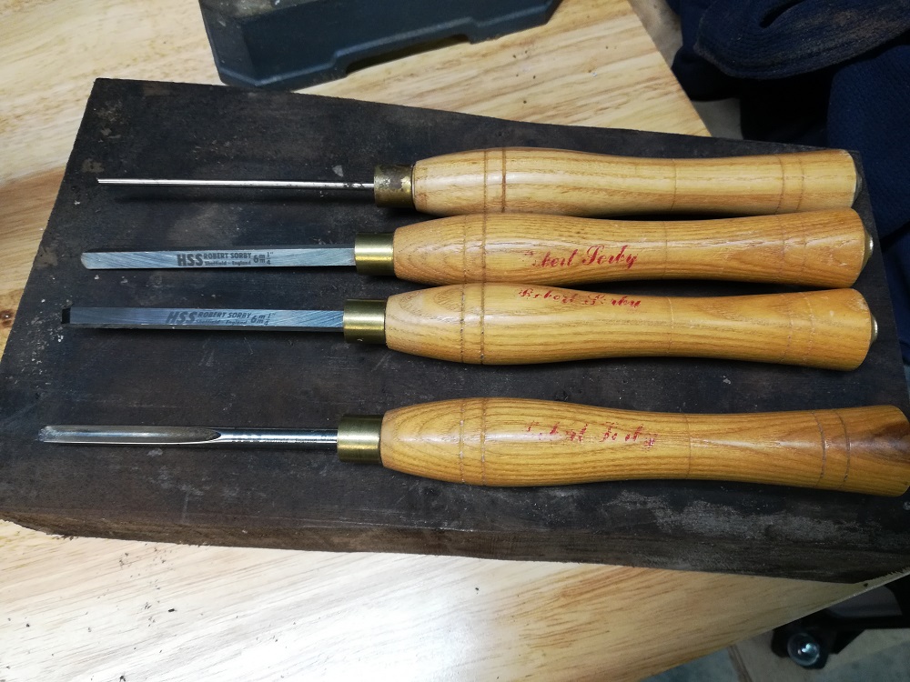

I picked up this set of 4 Sorby micro tools on ebay a few months ago for a very princely sum, sort of on a whim. All of them had terrible grinds (although I'm sure mine aren't great either). After I sharpened them, I decided to try them out not too long ago to see if they were worth having in the tool box, or if they were more toys than tools. Surprisingly, I think I may have found my favorite pen tool among them.
The RNS likes to chatter, unless my tool rest is VERY close to the work.
The skew is a fun toy, and I think it may be very handy on my next set of fishing bobbers.
The 1/8" gouge... well, I haven't found a use for it yet. Even at 32 years old with 20/20 vision, I can hardly see the damn thing well enough to use it!

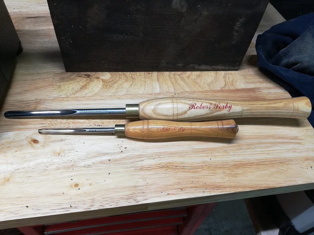

The 1/4" gouge however, has become one of my absolute favorite tools for turning small things like pens. With a good sharp edge, it cuts smooth as can be and leave a wonderful finish. And if you're brave, it will remove material almost as quickly as my Sorby 3/8" fingernail gouge (currently my favorite pen turning tool).
Does anyone here use any of these for your much smaller than average turns?
