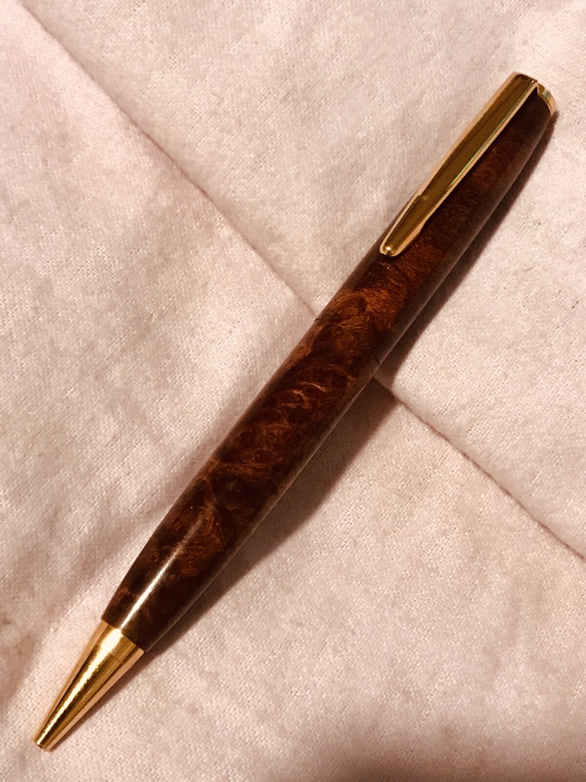

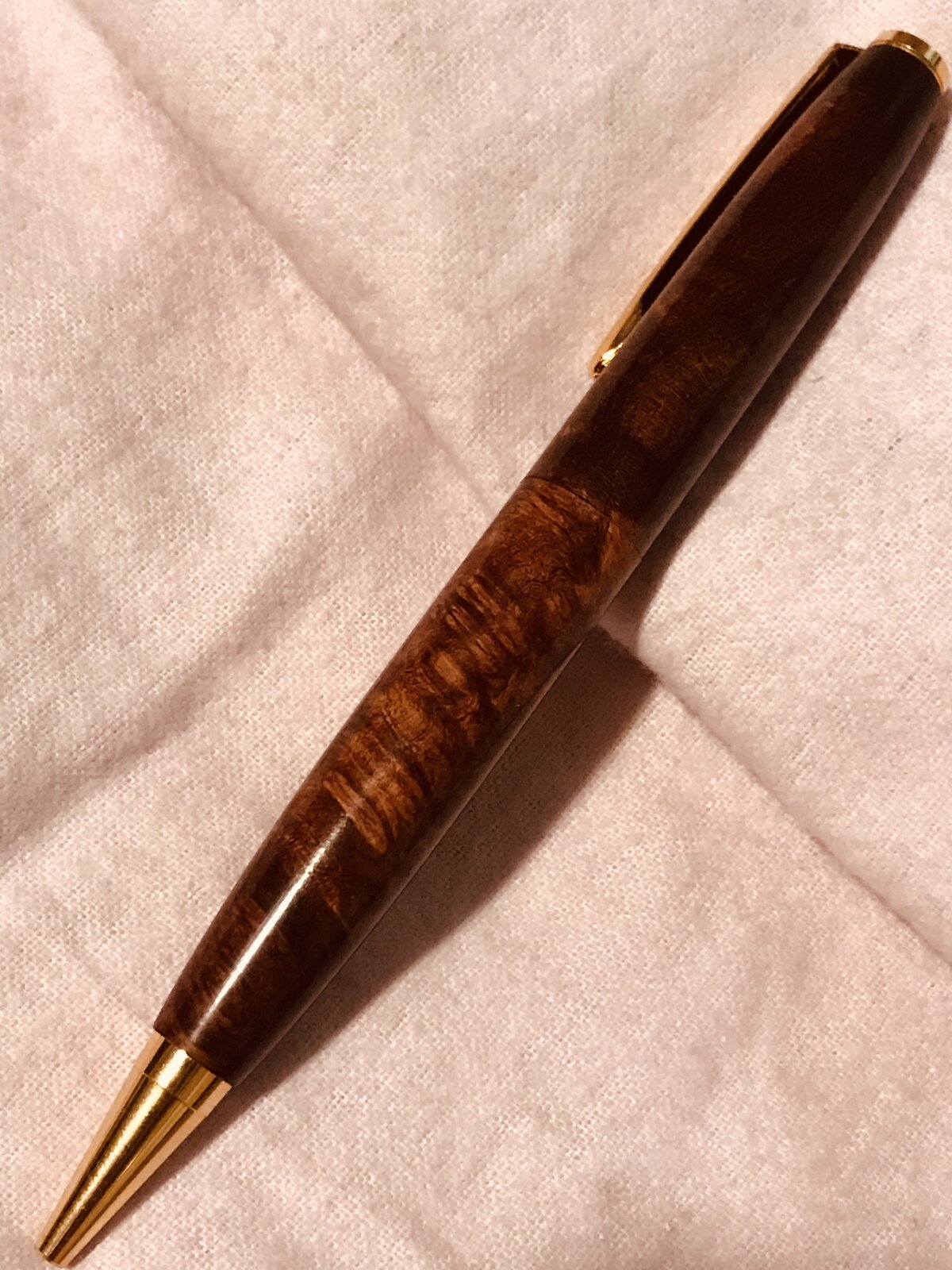

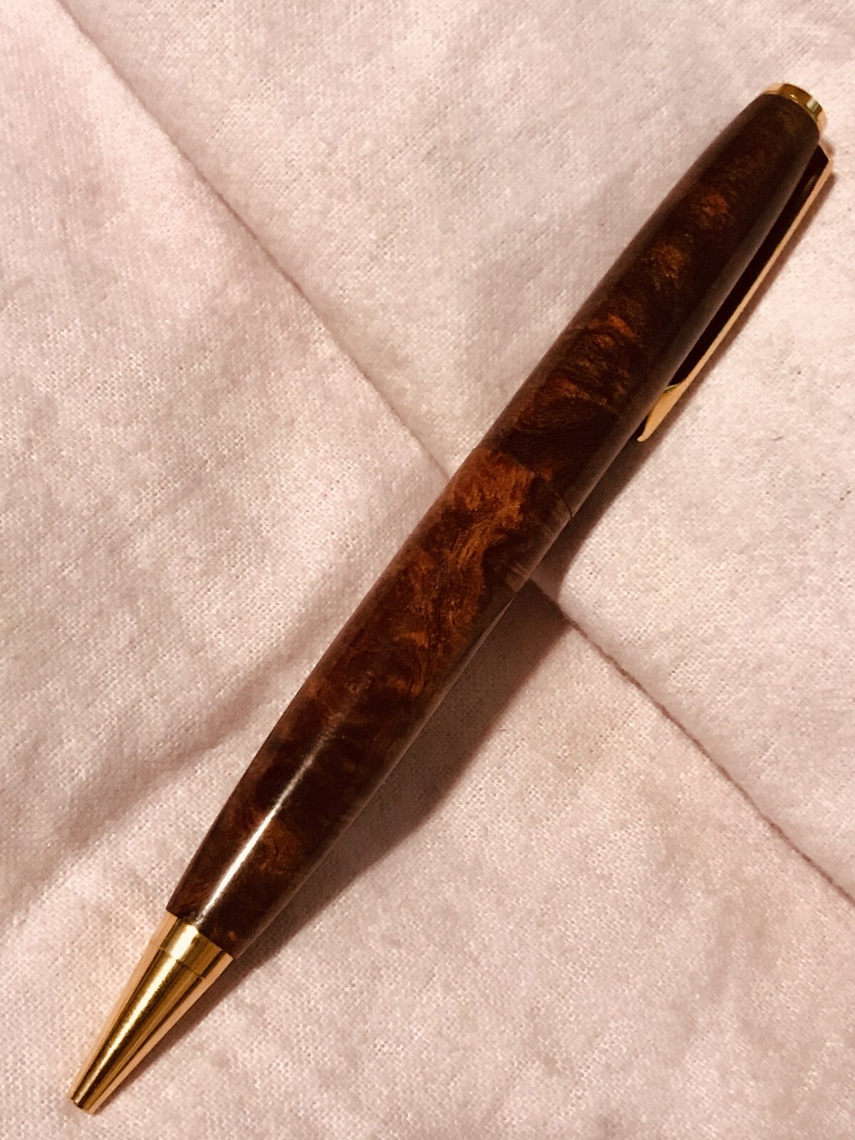

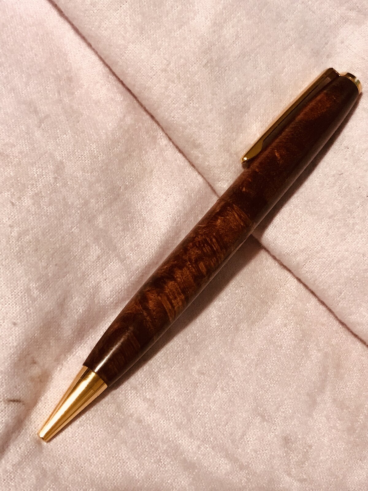

Looking thru my cache of blanks I found some identified as Mesquite Burl. They had been recommended to me; I had never turned any Mesquite Burl, and I had no idea of what to expect. For me. one of the great pleasures in turning is seeing the beauty of Mother Nature that lurks just beneath the surface. I hope you enjoy the enclosed photos. This is a modified Ti Gold StreamLine with Mesquite Burl:

Marvelous work! Even though I live in Texas, it is difficult to obtain mesquite burl. Wasn't it a pleasure to turn? I rank it nearly as nice as olivewood, my favorite. Well done.
I enjoyed turning the Mesquite Burl more than any other wood I can recall. Although it is a burl, tearout wasn't an issue; it didn't dull the cutter, and it finished nicely - 3 coats PensPlus , 2 coats Ren Wax.

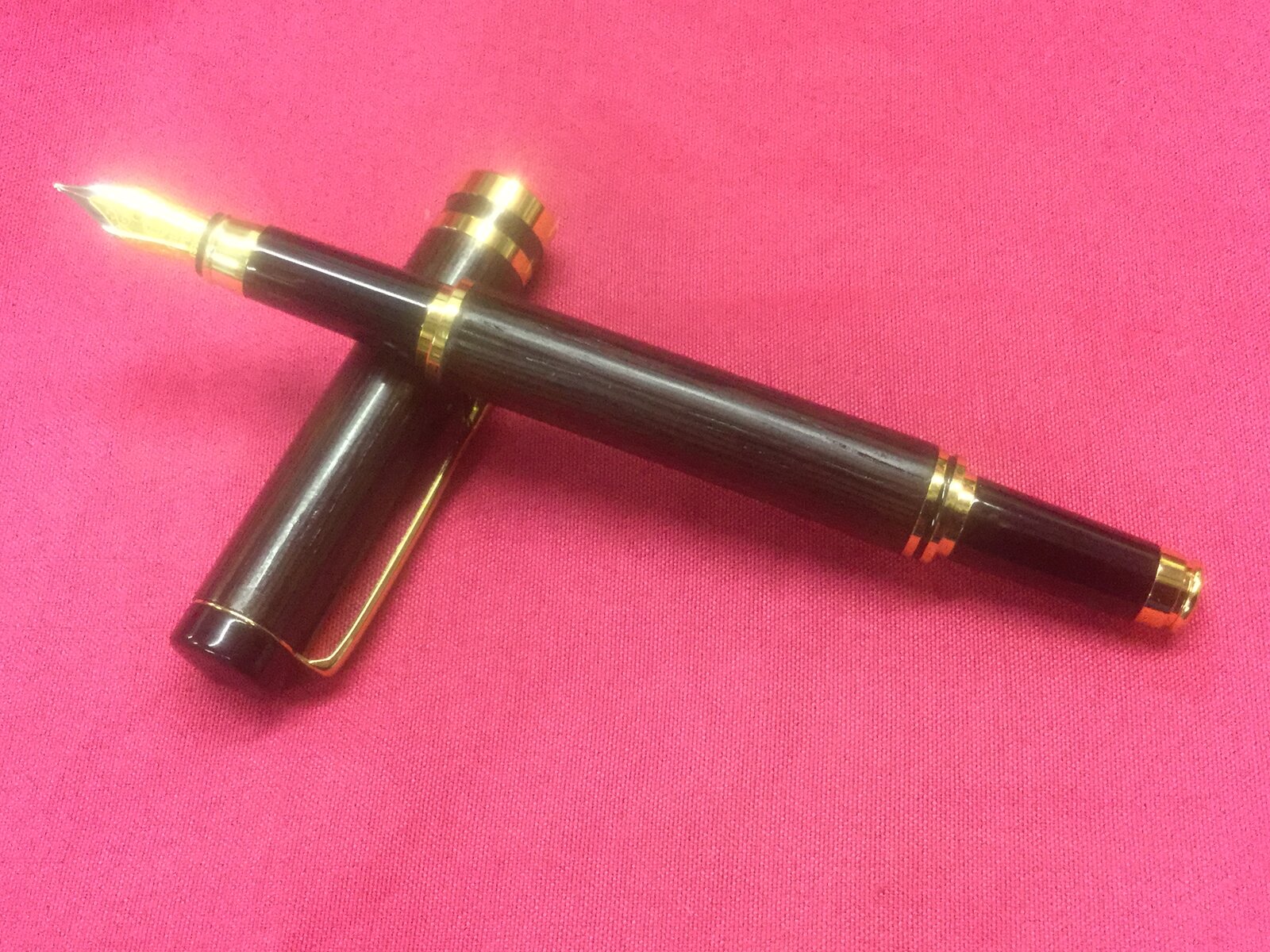

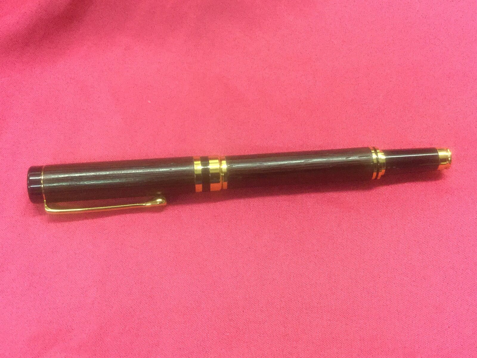

sorry for the glare on my fountain pen above but it shows how it doesn't disguise the grain and it still looks like wood not plastic. Makes it nice to grip too. This is a wenge one because I liked it so much . Lots of careful skew chisel work involved .
