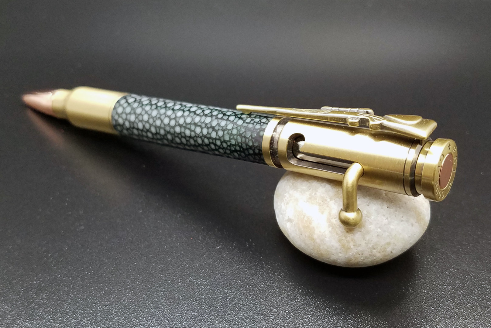

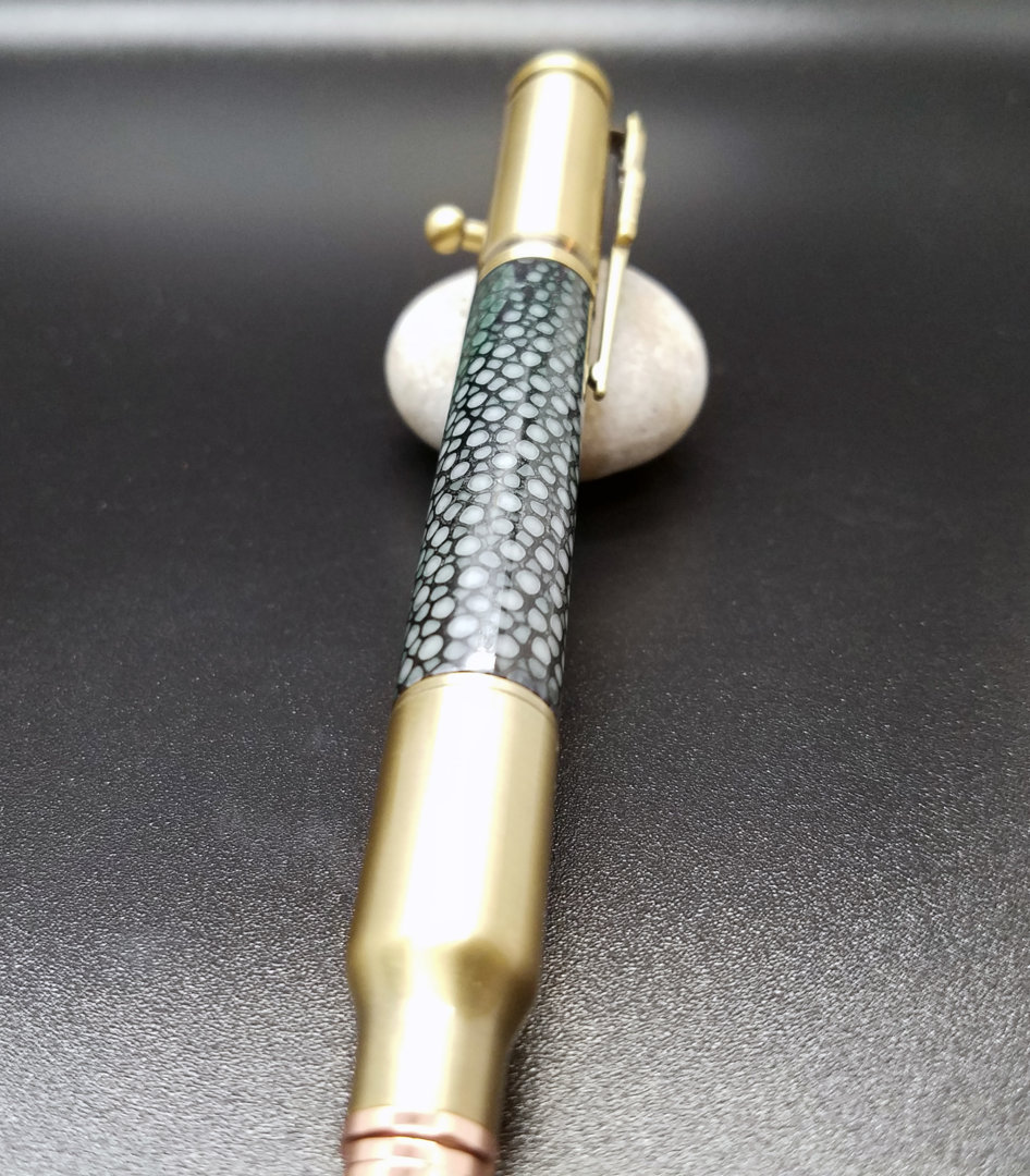

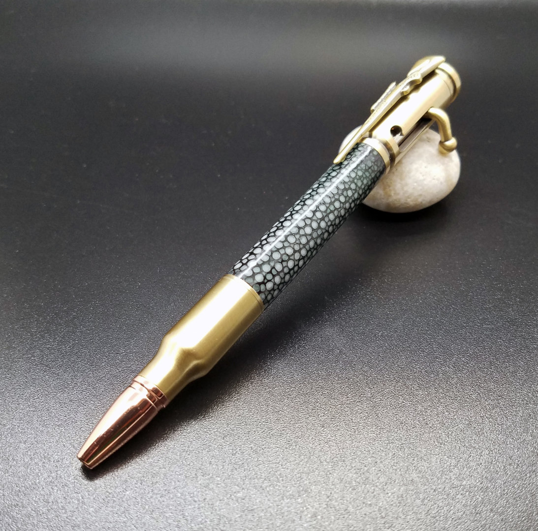

I was in the shop today helping the kiddo make some pens and had some inspiration to do something different myself. I had been holding onto a piece of stingray leather to make a knife sheath inlay but never got around to it in the past 10 years. Well I decided to wrap it around a brass tube and see where things would go. Took a lot of fighting but I finally landed the fish and got it to stay put. Let me know what you think.

Thank you. Stingray was traditionally used under the wrappings of Japanese katana and wakizashi swords due to the rough bumpy texture. This one was black on the outside and when you sand through you see the white inside of the bumps. It took over 40 layers of CA and repeated sanding to produce a shiny solid surface.

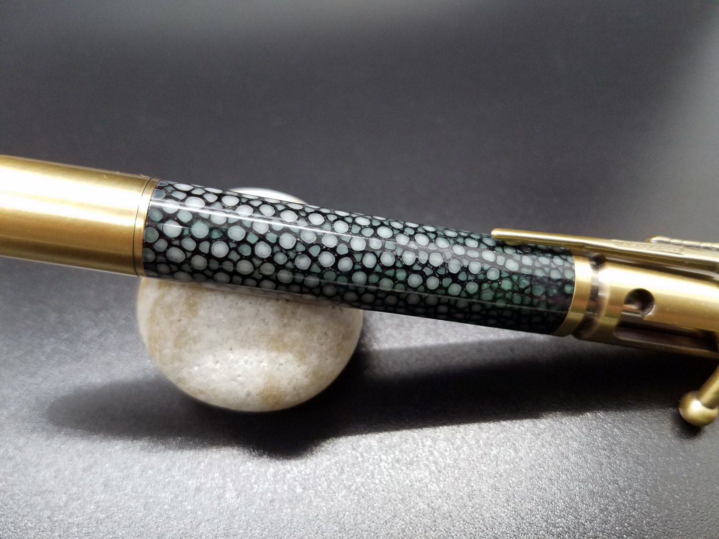

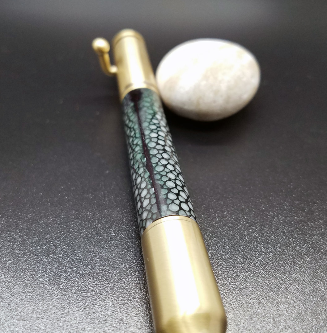

I really like that result (except perhaps for the "seam", but there is no way to avoid that, I guess) !! . I had never seen stingray leather before either.

Very nice. I like it. At the seam, did you maintain the natural coloring of the leather or did you have to fill/color? Knowing you can sand the regular portion to expose more white is great to know. Thanks.

Very Nice. I've thought about trying different leathers and didn't have an idea on how to approach the seam. My doctor has a pair of stingray boots that look awesome. The boots are black except for a white pattern right in the middle. He said that was because that particular spot doesn't take any dye. He then showed me his matching wallet with the same spot of white. As asked before did you have to thin the leather or did you use it as is? I've cast several snake skins and thought about trying leather the same way. The pictures you have is that a C.A. finish or something different? Thanks for sharing and your feed back.

I agree with the seam. In person it does blend together with the design but I'm going to work on a few ideas to minimize it. There actually isn't much gap there but the ends were lower than the rest and did not get sanded to reveal the white spots. The only fill I did was with crystal clear thin CA. This was the only thing I used in addition to the leather. The leather has a thickness similar to 7-8 oz cow leather. Probably 40% of that is the nodules. Not much room for error when sanding. I didn't reduce this thickness any before sanding. Also, I was very careful this first time and only sanded on the lathe - no cutting.
At the time I only had slimline and bolt action kits in the shop and there is no way this would wrap around a slimline. In fact, it started cracking when putting it on the bolt action kit cylinder. I think the fishing rod clip is also a good idea. I'm going to look into iguana skin but most places are just selling "lizard" skin and don't specify the species. I do have a few exotic pieces ordered and hope to share them in new work.

That is beautiful pen.. The seam does take away from it a little bit. Just to be clear with absolutely 0 experience with leather of any kind I would be curious if in some way you could stitch the seam together in someway making it a design element and possibly even helping to hold it in place as the glue set.

Rod building has a way to integrate the seams with minimal visibility. For snake skins, the skin is overlapped and a sharp Xacto knife is drawn down the overlap. This matches the two ends. Hope this helps if the future for pens.

The CA was clear but I made sure the brass rod was colored black underneath. Most of the black is just part of the ray skin at a lower height that didn't get sanded down. I'll have to look into doing stitches to see if that would work. For this it would have to be thick black nylon because it takes a lot of force to stretch the skin.
I overlapped the skin and then cut with a razor blade to a very close fit. The nodules would fall off if you cut at too much of an angle. Cutting with a razor blade is very difficult with this stuff. Almost like hard plastic beads. Interesting idea about using strips with other materials
