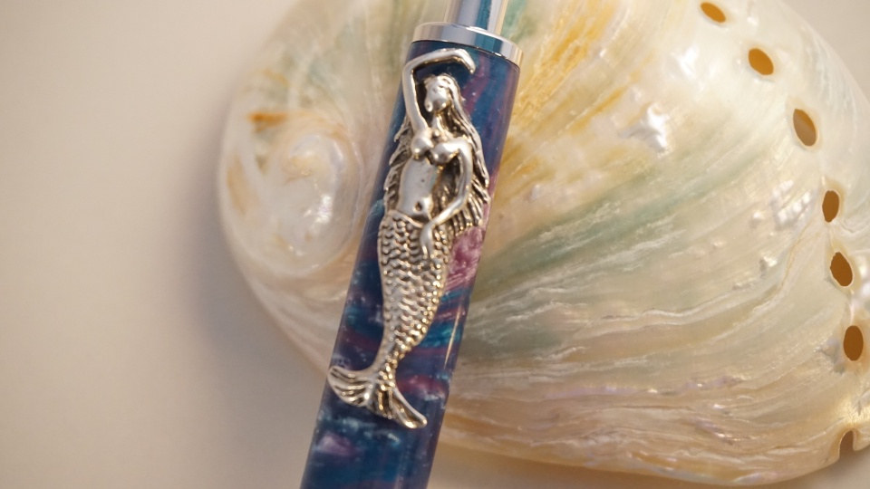

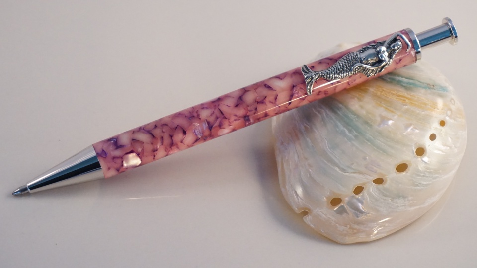

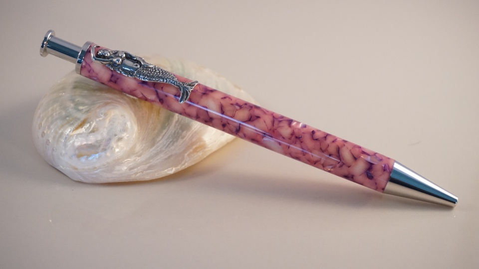

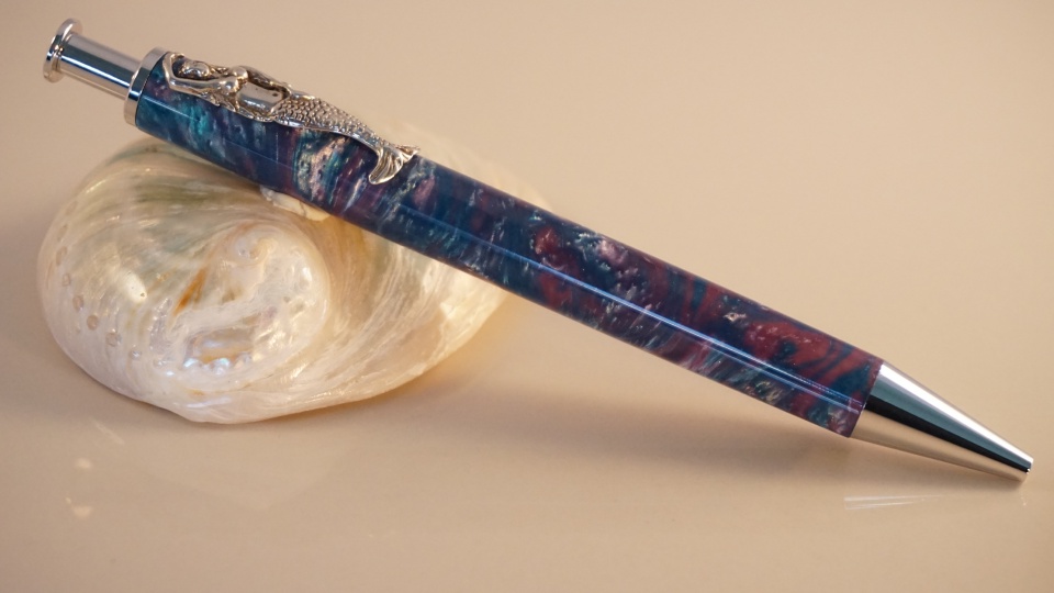

I picked up a couple of Rhodium Long Clicker ball point kits with the intent of making a checkbook pen for my lovely wife, Teri. I've never built a Long Clicker before and noticed that the pen could be easily assembled without the clip. Thinking that a checkbook pen doesn't really need a clip, I thought the idea of a roll stopper would be a better, more imaginative solution.
Since Teri loves the beach and all things ocean-related, the roll stopper is a Sterling Silver Mermaid. The blue one is her's and the pink one will go into my inventory.

VERY NICE ! . Where did you get the cool mermaids, and how are they glued on ?

Thanks, I found the mermaids on Etsy. After shaping the mermaid to fit the profile of the pen, I roughed up the surface of the blank as well as the back of the mermaid and used thick CA. It seems to have worked well, but in the future I think I am going to need to silver solder a post on the back of the stopper and drill a hole in the blank to ensure they stay in place.

Smart idea. You said you shaped the mermaid to fit the profile of the pen. How did you do that, a dremel or similar tool?
I used a piece of hardwood with a pen shaped trough in it and laid the mermaid in the trough and then took an appropriately sized drift, laid it on top and smacked it a couple of times with a hammer (one of the reasons I used actual sterling silver is the malleability). Then I took a small half round file and shaped the back which also gave me a more suitable surface for the CA as well as a better fit for to the pen.
