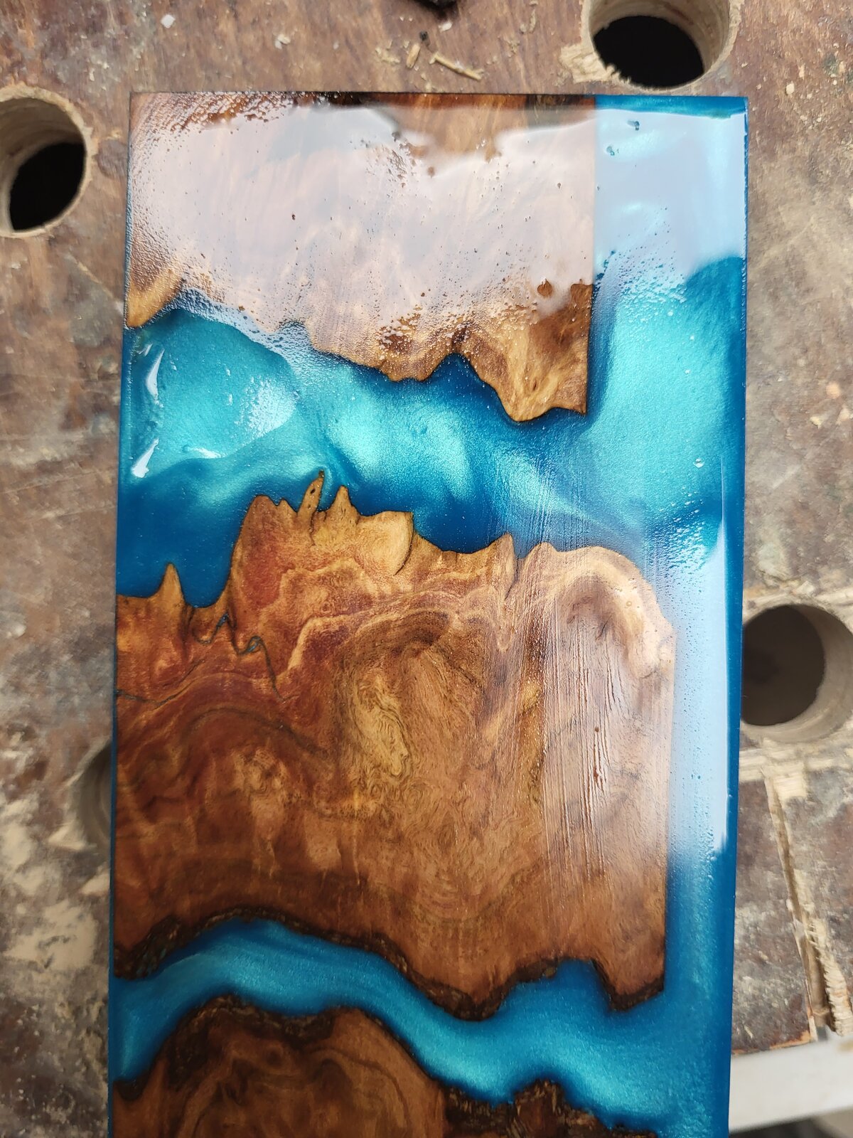

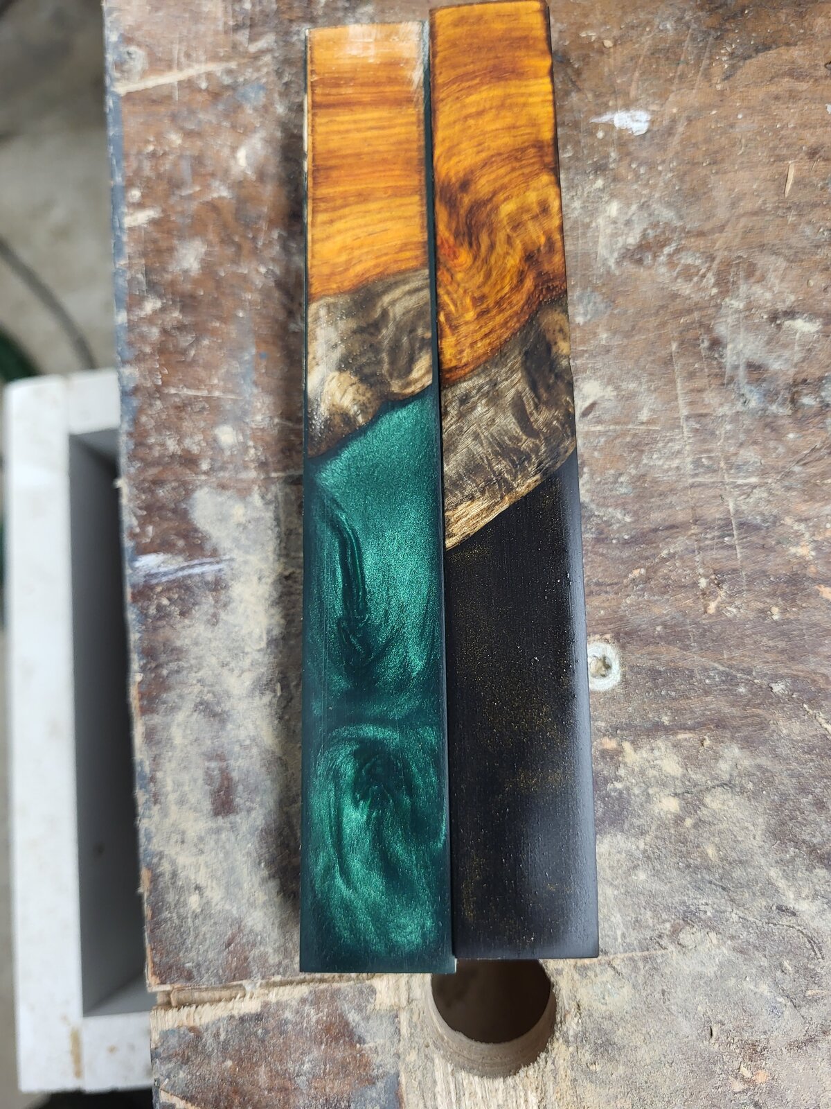

I scored some pieces of burl and made some pen blanks out of them.
I just sand the blanks and put some oil on it. This epoxy must rest for at least a week. The open time is 40 to 50 minutes. Multiple colors is a problem because the waiting time is long. I will try a other type. I think it will be this type ALUMILITE CLEAR SLOW FOR WOOD TURNING APPLICATIONS link
Any comments?

They look great, congrats! I would suggest the alumilite clear or clear slow for your next try. You will love it! Feel free to PM me any questions. I use that resin weekly. Looking forward to seeing more of your casts.
