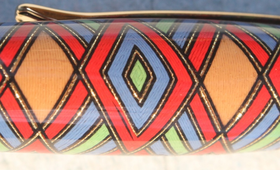

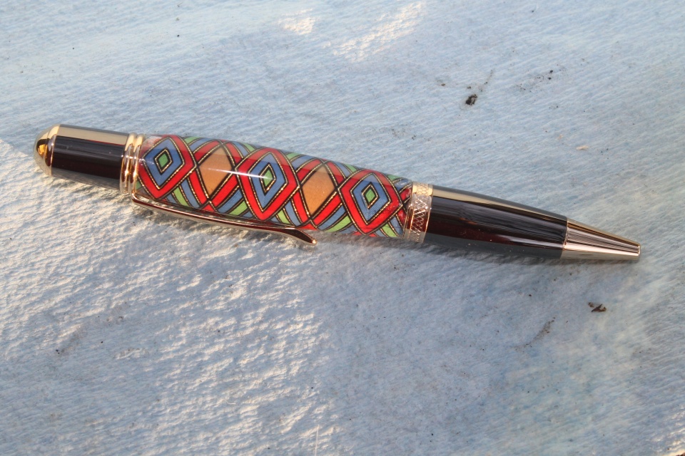

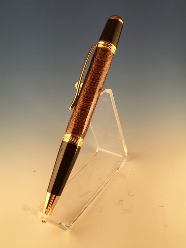

Been working out the details a bit and here are 2 of the better ones. Still a long way to go, but infinite possibilities. Rather than casting, these were spun on a slow speed mandrel at about 10 rpm and gradually applying slow cure self leveling epoxy. Took four coats to get to final diameter, but no turning after.
Will have a real rod master demoing for our local March penturners meeting and planning an encore for MAPG. Here's hoping more will jump in so we can learn together.
The first one is just a single layer of what's called tiger wrap.
The second had a background layer and on top is one of the simpler cross wraps to form little diamonds.

Prokote. Using this method very little is used. I've been covering 3 at a time and only using 4 ml for each coat.

Your work is looking good there sir. I like your diamond a lot. Nice clean looking lines on it. The diamond is compressed a lot, but looks good like that. I don't know where you are in your wrapping skills and hope you don't take this wrong, but, if you want your diamonds to look a little more squared out, make your initial crosspoints equal to the circumference of the tube. That is the standard layout distance for most wraps. Like I said, I mean no foul and I'm not implying yours is wrong by any means. I do a lot of wrapping and just trying to help out some.
Thanks Ted. It really was your work that first got me interested. Haven't done too much since these but hope to get back into wrapping at some point. If nothing else it gave me a greater appreciation of your and other's designs.
