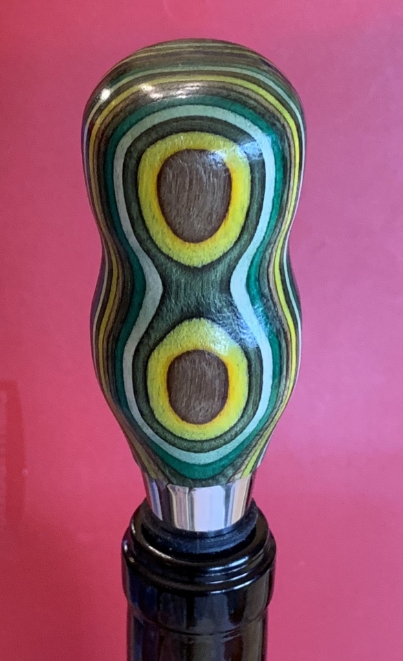

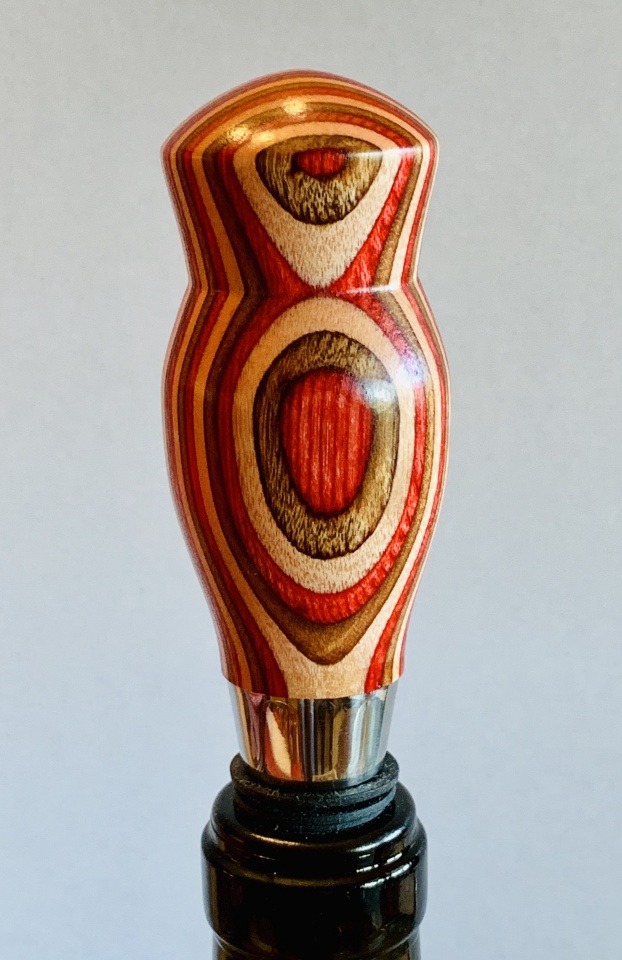

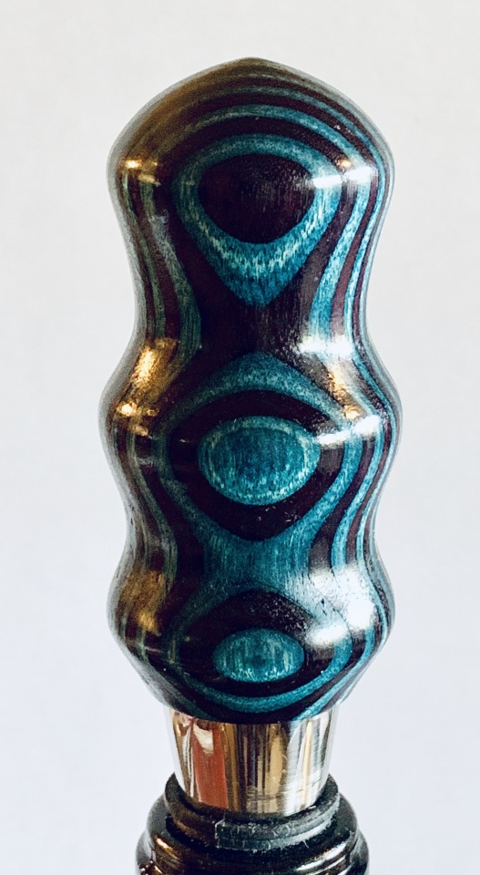

I've taken advantage of some of Cousineau's recent sales and stocked up on a variety of Spectraply blanks. I really enjoy making bottle stoppers from this stuff.
After sanding these to 600 grit & burnishing with shavings, I gave them a coat of sanding sealer followed by a coat of friction polish and 2 coats of glossy spray lacquer, then topped off with Ren Wax.

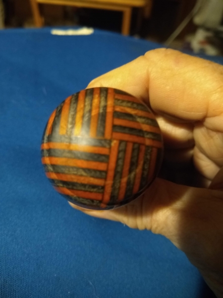

Those are beautiful. My blind turners wanted to make some spectraply stoppers but all I had were pen blanks. I took two pen blanks that were just alike and cut them in half then glued them together, with each at right angles to it's neighbors to make a 1.5x2.5" stopper blank. (Striped side next to solid side on each face of the blank) When turned, they made some really interesting patterns. I've made screwdriver handles the same way.
This is the only one I have, not a good photo, but it shows how I glued the blanks.

Sharon, great idea on the spectraply pen blanks... I use slabs of spectraply from their pepper mill blanks with other woods and make some great looking mills... haven't thought about gluing up pen blanks to make stoppers -- great idea and great looking stopper.

Thanks Sharon - great job on that glue up.
If you will PM me your address, I'll be glad to send you a few 1.5x1.5 Spectraply spindles for your blind turners.
